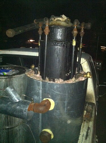

A good test for the gasifiers to ensure they are not wasting energy is to paint the entire unit with standard paint (not heat resistant). If the paint burns or scorches you know you are wasting heat to the atmosphere.

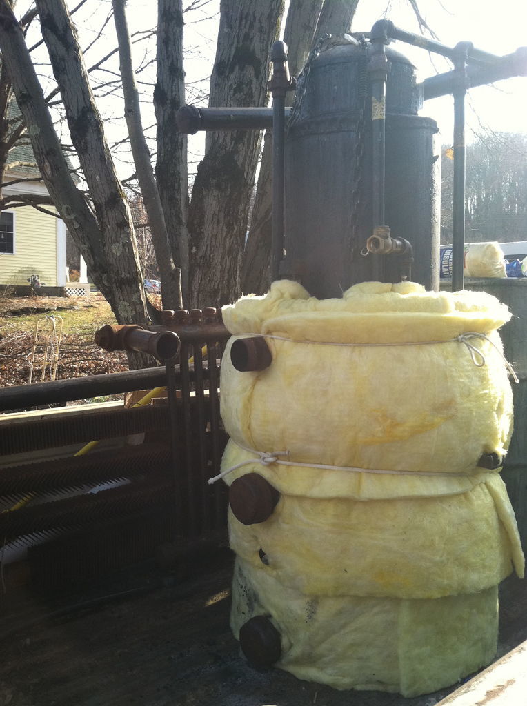

oh yes the paint will burn right off.. depending on how hard I’m pulling on the system.. so how do i reduce this level of wasted energy? today i loosely put some fiberglass insulation around the gasifier and i think it ran better and the motor had more consistent gas at lower rpm’s which made stop lights much better !
so i have 1500 to 1600F degrees in the restriction zone.. and sometimes the output gas will get in the 900- 975 f range but produces well at 400 f . what changes would you all suggest? I’m thinking about the 3.2 hole in the bottom of the restriction zone perhaps i should change the size to say 4" ?? the flare is the other night .. i think its a good color.

The wasted heat is just one aspect. You have several factors in keeping the heat in, not generating too much heat, keeping the hearth hot enough, keeping the output clean. It basically comes down to your gasifier design, you can’t really fix this stuff after the fact.
I think you’re starting to see the light. There’s a major difference in a system that runs and a system that runs well. I went through the same thing, even built a whole truck system that ran for about 2 miles… You’ve hit it luckier than me with a truck you can drive around, but I would guess you are headed for maintenance troubles in about a thousand miles. Have you provided for the following?

no worries i have always looked at the first build as a learning experience … besides it would only take a day or so to weld up another gasifier. with better sized openings inside… i may be able to recycle some stuff from the first one but i may just start over…
for the time being I’m continuing to experiment with the one i have. since i can’t really recycle the lost heat from my first gasifier i think ill elect to insulate it well and see what improvements that could make… with a little insulation i see an improvement in gas quality and low rpms so i want to now insulate the whole barrel and see if it improves. I’m sure it will … in the mean time ill think about how to better build the next one! ill check out your blog and welcome any advice!

  • Insulation is good! Insulate the right spots and it will increase your gas quality and efficiency.

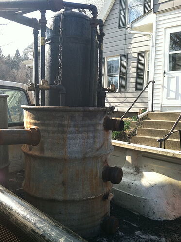

I put another 30 miles on the truck today pretty good power and a top speed of 60 mph. at times i can tell the motor is pulling hard on the system as the barrel will pop from the vacuum i try to keep my foot out of it and pull lightly on the system. but sometimes i just can’t help it… she can be a little finicky about the air fuel mix… seems what works one day doesn’t the next. just like wane said. and i constantly have to play with it. the o2 gauge is usually reading a lean mix at idle but at running speed i keep it at 15 to 17… although the motor seems to run well at 20. which is the top part of the scale on my o2 sensor… below 12 and it stalls… the vacuum gauges finally came! woo hoo ! now i can monitor vacuum in the system one is destined for the hopper one on the gasifier (other side of the grate) and one on the engine …
for the next gasifier I’m thinking a much larger restriction zone and maybe a 5" hole in the restriction plate… i think ill have the nozzles enter at an angle that 30 deg or so pointed at the restriction hole … i think the two sets of nozzles really work well and ill do it again. this time with the ability to fine tune the different nozzle rings .the only other way i see to improve this is to redirect wasted heat back in via the nozzles and increase the sizes for more gas into the motor (I’m thinking with larger supply lines i won’t have to pull so hard on the system). although 35 -50 mph is not a problem with my current build … to get 60 -75 i need flat ground. which is hard to come by in new england. well thats all for now … i think I’m done with this build and ill insulate the entire gasifier redirect a little waste heat to the intake and runn it till it melts… to my surprise it hasn’t yet … I’m actually quite surprised about that… I’m coming up to about 400 miles on wood now without any real major problems… other than trying to run wet wood … which never ends well … :frowning: lol… my fuel today was waste wood chips from roadside brush … that i collected from the top of the pile so it was nice and dry… .i aded a high tourqe starter from summit racing… and that has no trouble turning the motor over … i can start it on wood with no help from gasoline now. i used to get the motor running on gas then switch over… well thats all for now
Cheers all and many thanks for all your input! I welcome all criticisms and compliments and look forward to all your responses. this has been the coolest thing i have ever built and i couldn’t have done it without all the good advice! many thanks to all.

JohnW for your insulation testing a free good source is inside self-cleaning ovens. Check out an appliance repair/recycler. Moderately high temp oven insulation is just dumpster trash for them. Plenty good for outside wrapping - hearth core wrap probably not. Need to use SS, Inconel or ceramics to play those kind of games anyhow.

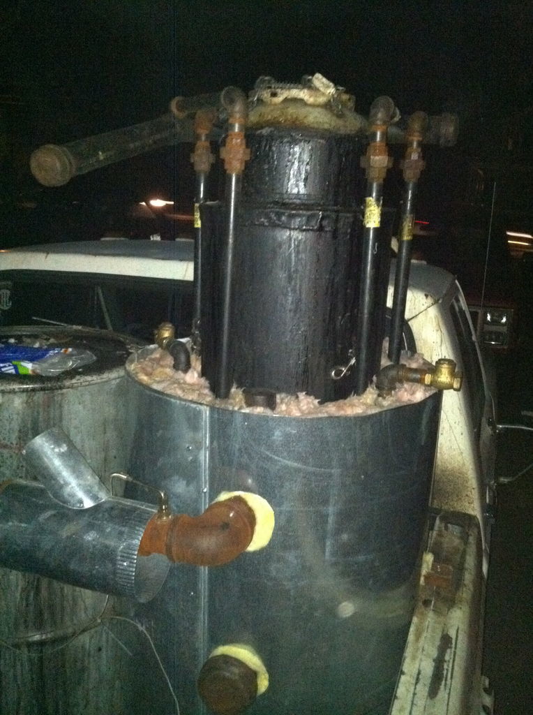

well its insulated .. and i put it back together today.. ill need to do a little more tin work to keep water out but for now its fine.. i can’t wait to fire it up and see how she goes! ..

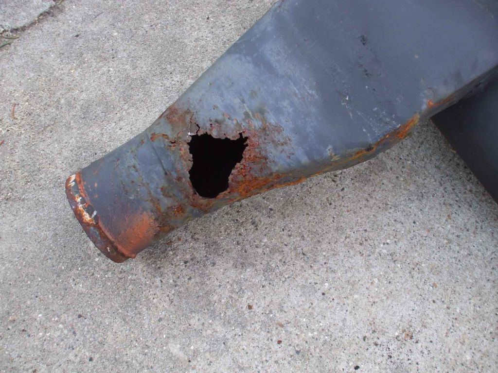

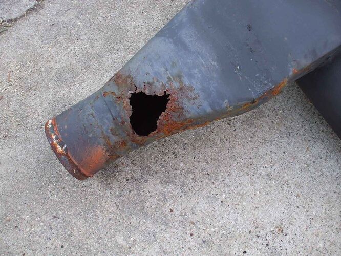

Hello John Wells, Just make sure you build out of solid stuff !! Here is what I found on my trailer last night. I repaired it best as I could and fired it off with Anthony Meschke today when he dropped by on his way back home. The big air leak is now gone of course. I made a video with the leak the other day but am too pooped to do another one tonight. I built it light to hang on the back of a regular car along with a really light gasifier. I attached a picture of my now deceased 95 olds so you could see that layout. Hope to see you in Indiana .. Mike LaRosa
