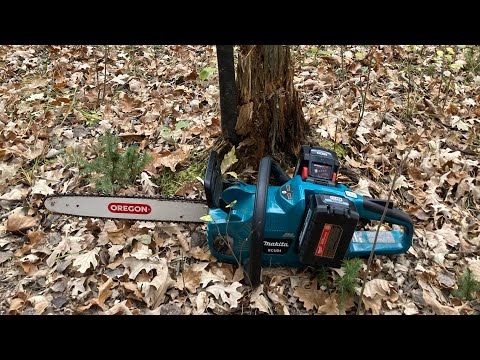

Well I’ve finally used this chainsaw enough to give it a proper review. Got is last fall for $230 CAD. It came with a 16in bar and chain, but no batteries. The chain it had was a smaller file size, so I either had to buy a file or get a new bar and chain. I opted for the latter option since I wanted to try the Oregon PowerSharp bar and chain setup anyway. It is a 36v platform using two 18v batteries. Milwaukee makes some of the best batteries out there (in my opinion), Payed almost $400 CAD for the two 8.0ah high output Milwaukee batteries. It was almost a little to expensive, but since I can use the batteries on other Milwaukee tools as well, I figured that it would be worth it to just buy the best batteries I could.
I forgot to mention in the video, that yellow housing with the grindstone is for mounting on the end of the chainsaw bar. Then the grindstone is pushed into the end of the chain for about 3-5 seconds and the chain should be sharp again. I have not had to try this yet.
I was able to cut about three quarters of that spruce tree on about half a charge. Overall I have really enjoyed this chainsaw. It lasts way longer than both the Dewalt and Greenworks 80v (4.0ah) that I have already tried. It will go for about 10 min non stop then it is overheated and will take a bit to cool down again. But that is as long as the Dewalt and Greenworks saw lasted. Dewalt lasting a little longer that Greenworks.
After the 10 min of working non stop if your willing to coaxes it along stopping for a bit every few minutes it will just keep going. like I mentioned in the video, I did about half a cord of dry elm a few weeks ago with this method on one battery charge. And the good thing was I wasn’t completely exhausted after that.
The bar and chain made a huge difference on the greenworks. The makita might have come with an oem oregon bar and chain. I don’t know.
What I do know is dewalt used the higher quality parts on then greenworks did on theirs. Otherwise, I am not sure they aren’t the same electronics and motor. And by the time you put the higher quality parts on the greenworks, it may make more sense to get the dewalt. :slight_smile:

Not sure if anyone is interested, but I am trying the new Oregon PowerSharp chain and bar on my electric Makita Chainsaw. This chain design uses a sharpening stone that you mount on the end of the bar when you sharpen. Takes about five seconds to get a sharp chain again.
Right out of the box it was super sharp. Got about 1.5 cords of wood cut before I sharpened it the first time. Have yet to see how long that sharpening will last but I think I should last a while.
