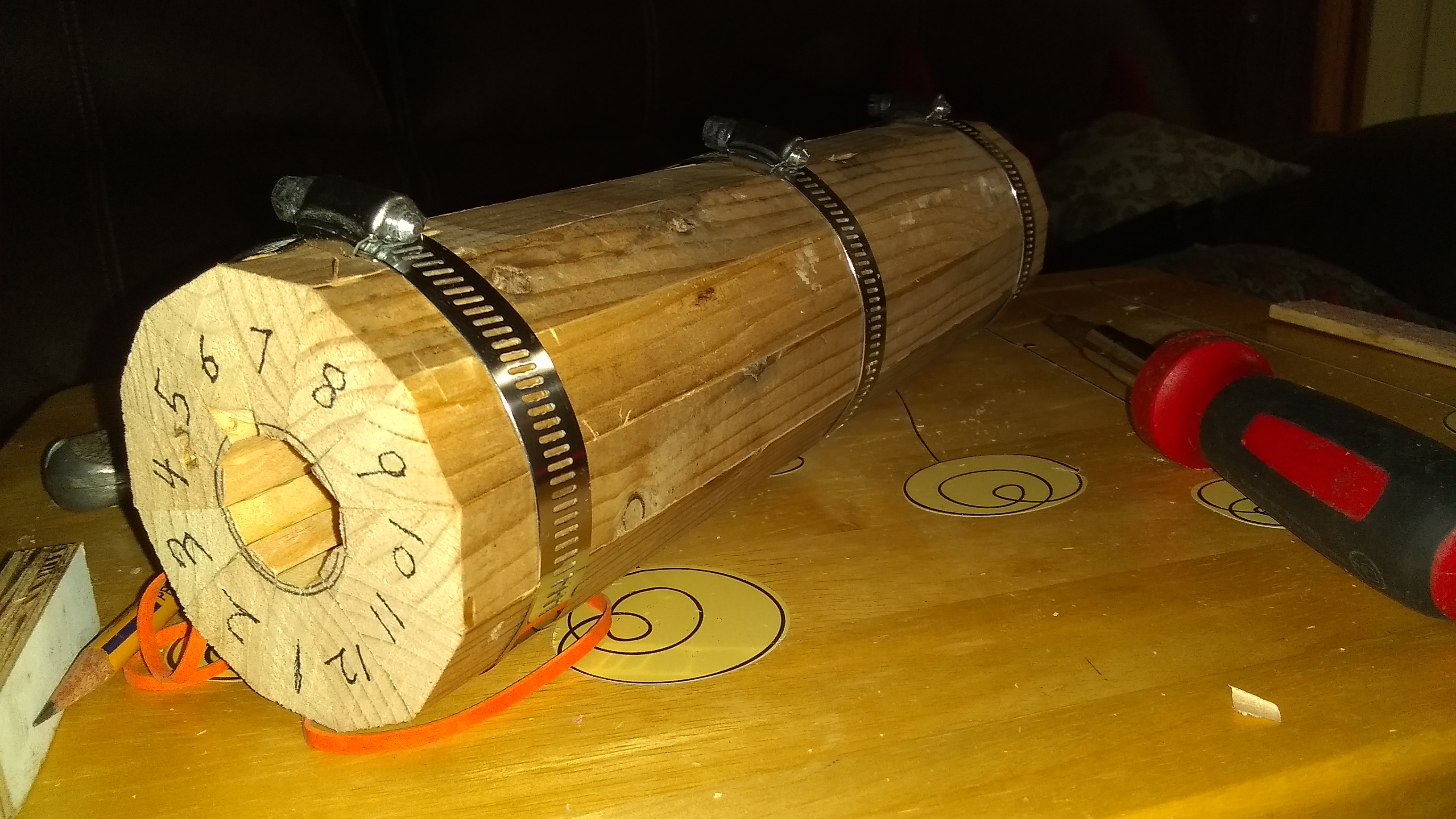

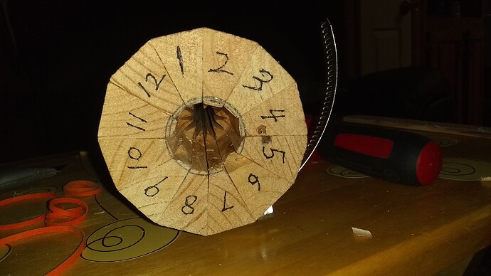

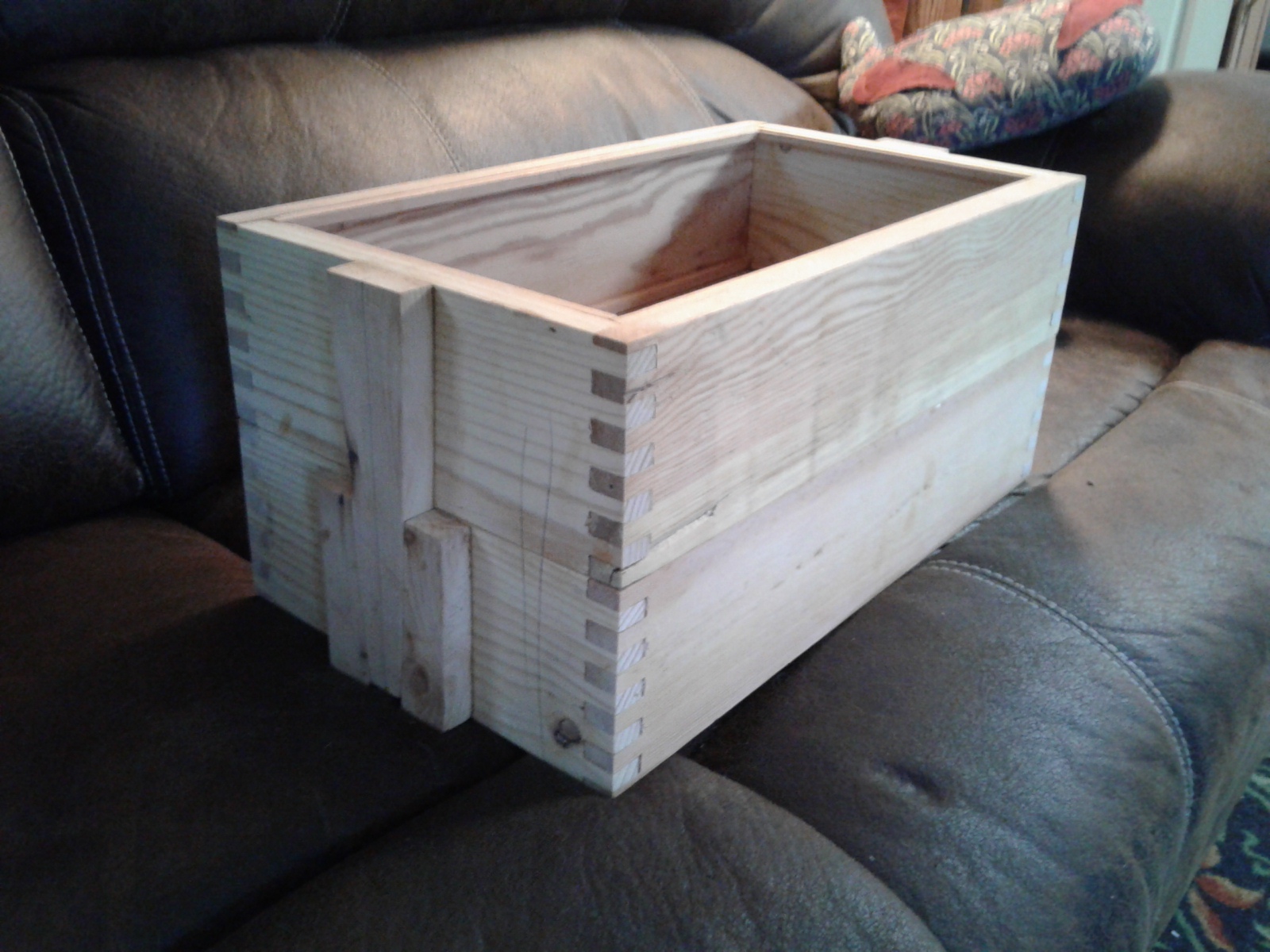

So FINALLY the core box is done. I confess, tis thing has tested my patience! Just a coat of sealer an try it out.
Yes! Pattern work is the most challenging aspect of foundry. Your work looks very good though. What kind of binder do you use for your cores? I like washed silica sand, 120 grit, with waterglass/ CO2.

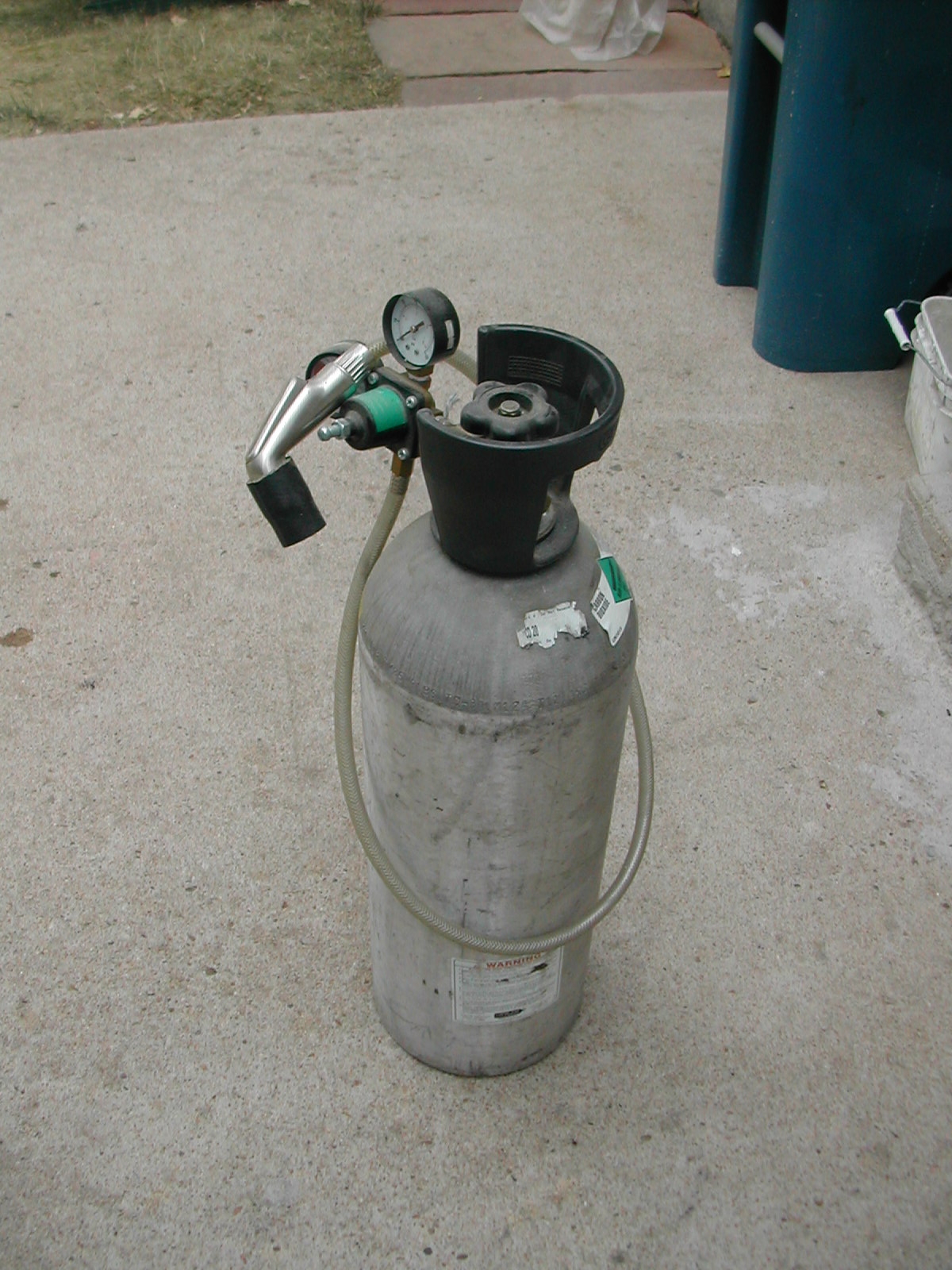

I have a tank and regulator. I hooked up a spray gun like for the kitchen sink and pushed a short piece of hose over the nozzle. The grocery store sells dry ice. I just get some and put it in there when I run out.

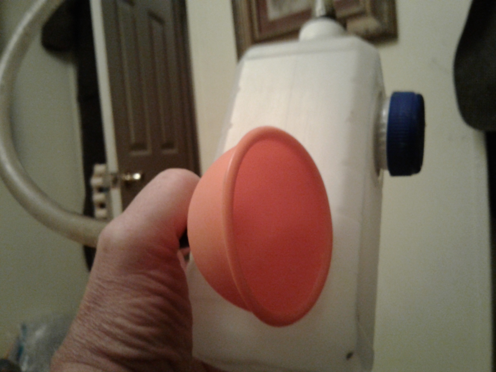

While i’m at it, here is my co2 generator.

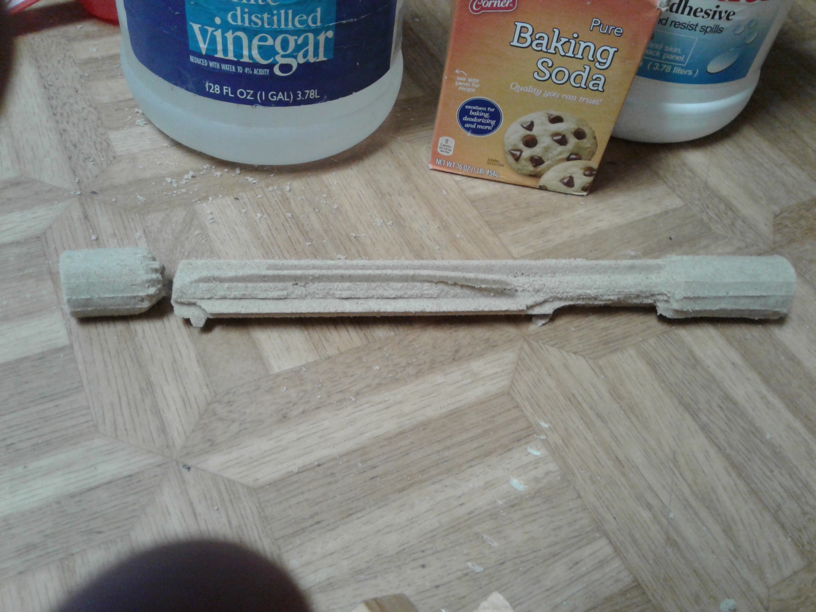

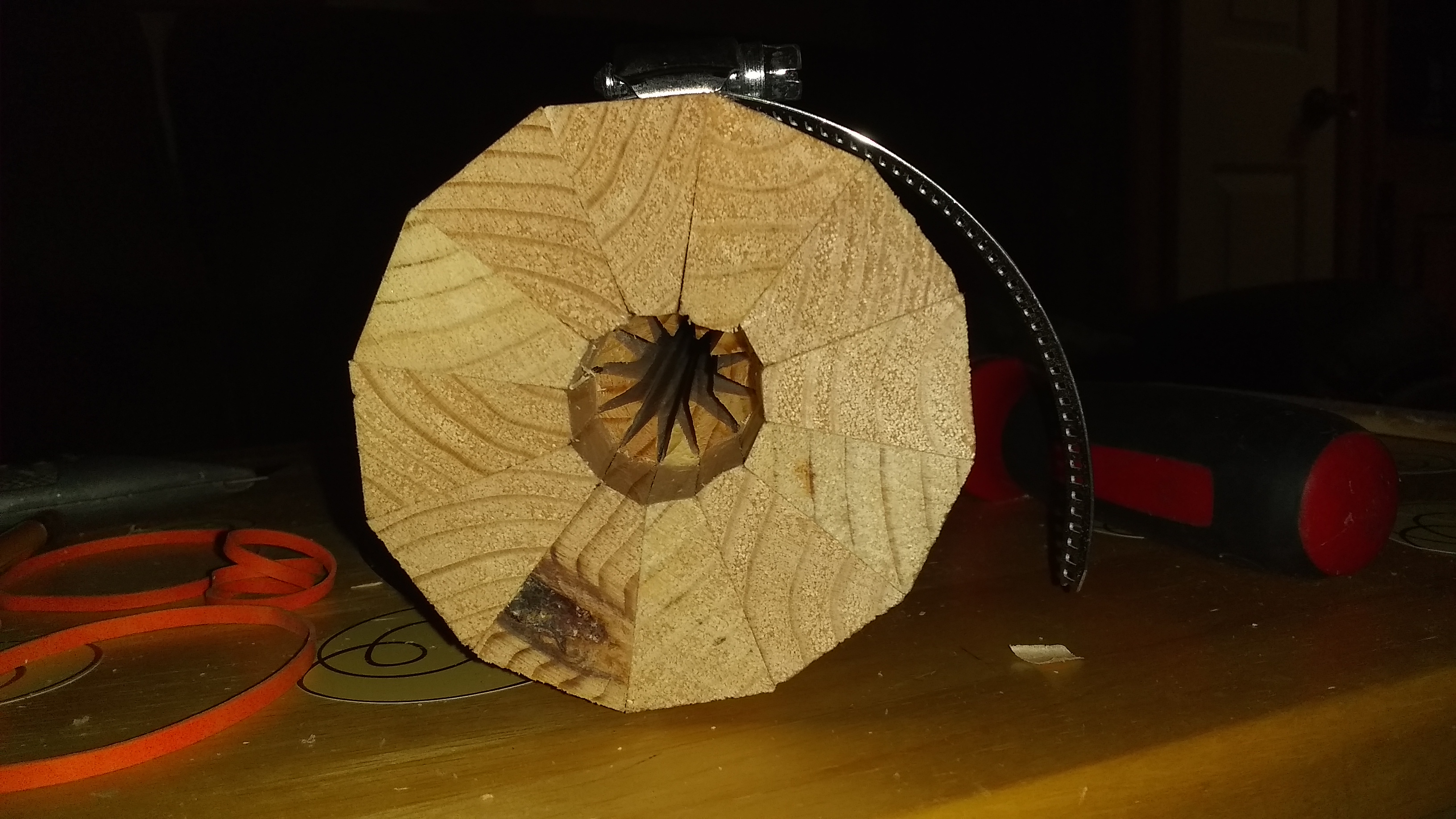

The first attempt at a core was not entirely successful, but showed some promise. I think i needed to be more gentle with the removal. I waxed the core box with paste wax, and it didnt seem to stick too bad. Would dry powder be better for release?
Why dont I start out learning on a simple project like a normal person?
