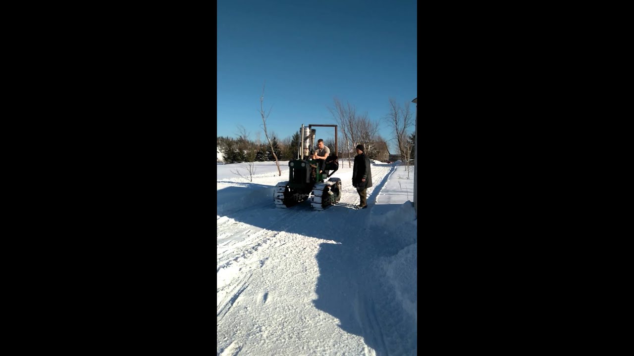

I am intrigued by your photo “yellow caterpillar tractor” of what brand is it?

I have two, the one in the pic is a 1952 ATC (American Tractor Corp.) GT30 Track loader. F140 Continental Gas, 3 speed, wet clutches, 6000 lbs. Case bought ATC out in '57, and the GT30 eventually became the Case 310. It’s a sweet machine for doing “yard work” :slight_smile:

I own an oliver oc4 +/- 1955 you can see it here
Thierry
That’s awesome - wood powered too? I love the OC-4, probably one of my favorite crawlers. Your machine has the same basic Clark transaxle and wet clutch diff steer that mine does. I love that these machines have wet steering clutches. My other dozer has dry clutches with steering brakes - I feel like I’d better not ever let it sit for too long!
