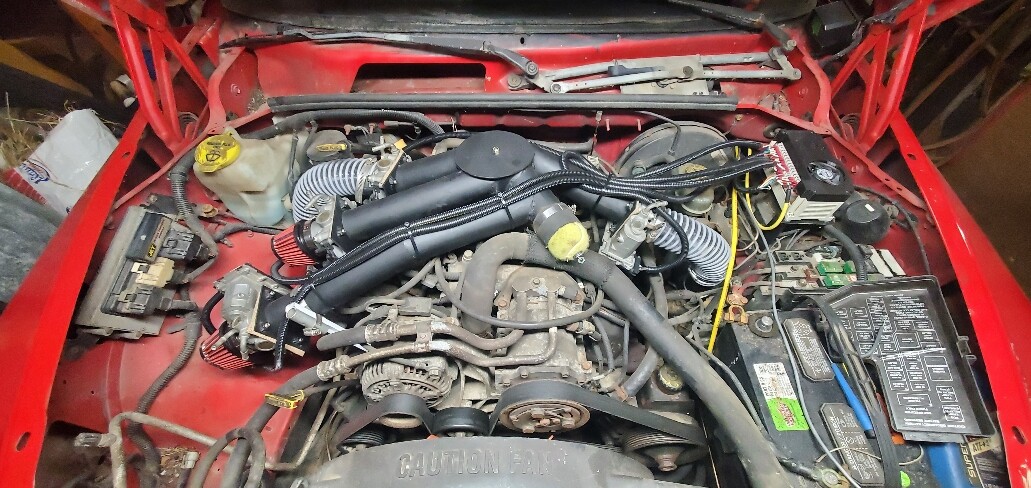

My mixer is built just as your describing. Old honda civic throttle bodies (simple dc motor, spring return. Driving them with PWM through LM298N)
LM298N would not my first choice simply due to the current draw limit (at least with the TBs i am using and because I am using both channels on the LM298N controlling two seperate TBs.)
But i had them on hand so thats what i went with.
Originally i didnt think about the auto mixing functionality, i simply wanted to get away from running four control cables into the cab and concerning myself with the bend radius of the cable. (That being said there is deffinatly something to be said for good old manual control)
But because i did it the way i did, it will be really simple for me to add the auto mix capability. I just need to incorporate a wide band O2 sensor into my system and update my code.
I used an lcd display i had laying around to display what percentage my valves where at. I realize now that wasnt the best choice. Worked fine during the summer but doesnt work so well in the cold. Ill have to switch it out with something that works better for this climate.
The fan i incorporate into the housing drasticly helped dissipate heat created my the motor drivers.
