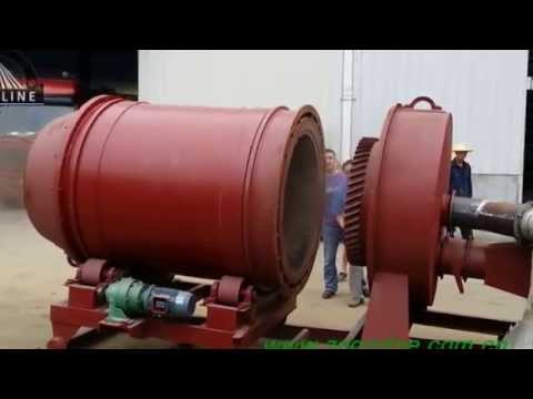

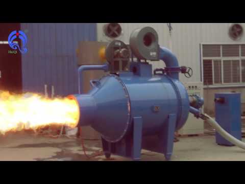

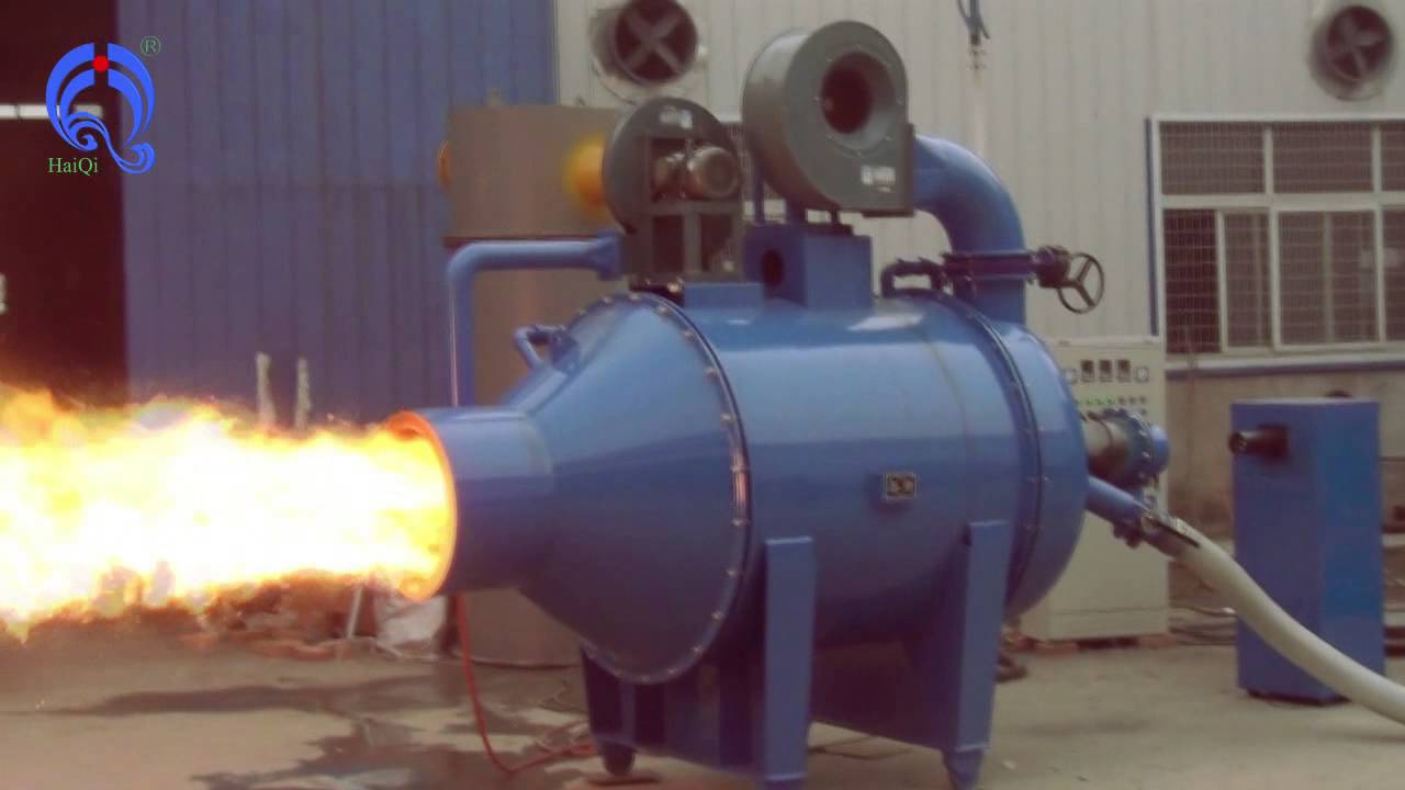

The Chinese swirl burner looks dead simple.
I believe @Calvin_rader heated with bales for years? I could be wrong.

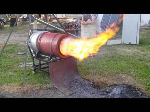

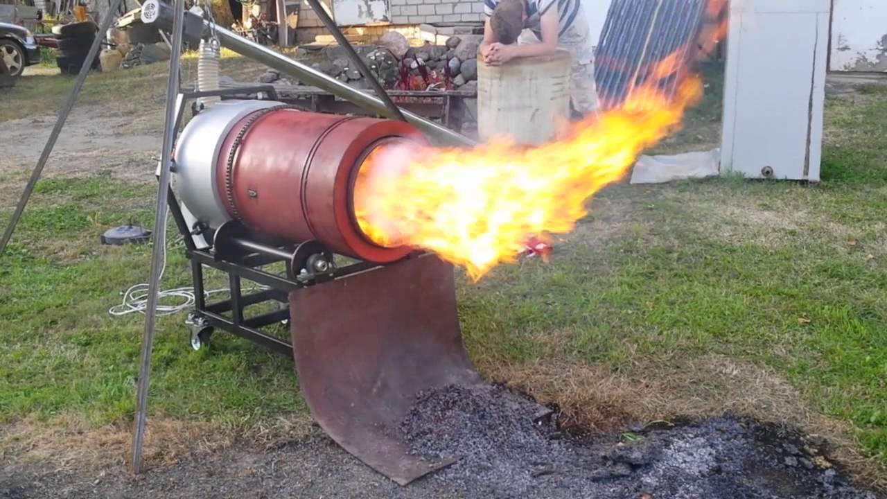

This fellow is using straw pellets. It appears the rotary motion addresses the slag issue.
A view of the internals of a light material burner…
