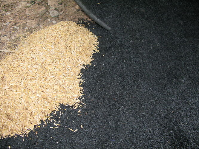

Did made some charcoal from Rice Husks for testing later on…
Was not difficult ,inside the drum , but this morning when all was cold, they still reacted very rapidly with the air when i exposed them.
(did noticed after 3 hours that the drum went from cold to 200°C again… )

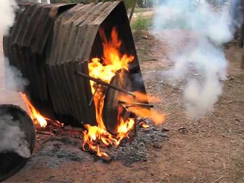

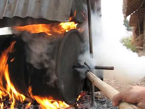

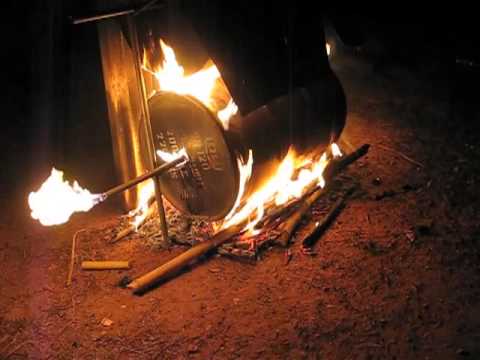

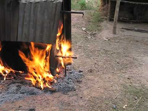

Koen,
Very nice setup. I know it isn’t portable, but you might want to insulate using clay “fire” bricks to make it more of a kiln, then you don’t lose as much energy from the flames heating that up. Off the top of my head it is like 50% clay and 50% ash, mix it up, let dry and then bake it. Or you can just use ash for the insulating material. Ash is actually a refractory material.
You might also try a rocket stove or two for each barrel to get them going. I am sure you have a lot of waste bamboo, but no sense in burning up more then you have to.
How did you make rotating pipe connection before running it through the condenser?
The pesticides will work, but you have to hit the weeds early, and it might not be a complete kill. From what I have seen, you hit them with the pesticide, see the kill, then go back and spot spray with the commercial pesticide, or just hand weed.
Hi Sean,
Yes you are right.
This is just one of the testing set ups to finding things. Always have imp4ovements in my mind :wink:
But at some point have to do instead of thinking…
Any way i have always room for improvements
In this setup, the barrel is rotating over the tube, inside the drum i have holes in the tube wich allows the vapors escaping. I use 6 m long iron tubes as condensors at this moment. Aas mentioned… thinking, testing , studying, improvement.

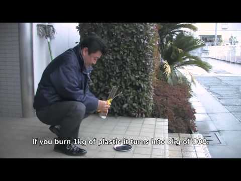

I am curious, have your heard of pyrolysis of plastic? I’m not sure of the waste generated there. I am going to experiment with this also. It’s basically the same as you making char except you would put plastic in the barrels. I haven’t done enough research on it to find out if different temperatures produce different grades of fuel and if so, what those temperatures are. Here are some videos to get you started.
http://www.youtube.com/watch?v=hIM_bo1hLuI
Bill Schiller
Old plastic items are actually sold for recycling in Thailand, so it may not be as attractive to the locals. You can use virtually the same process with old tyres to make Diesel.
