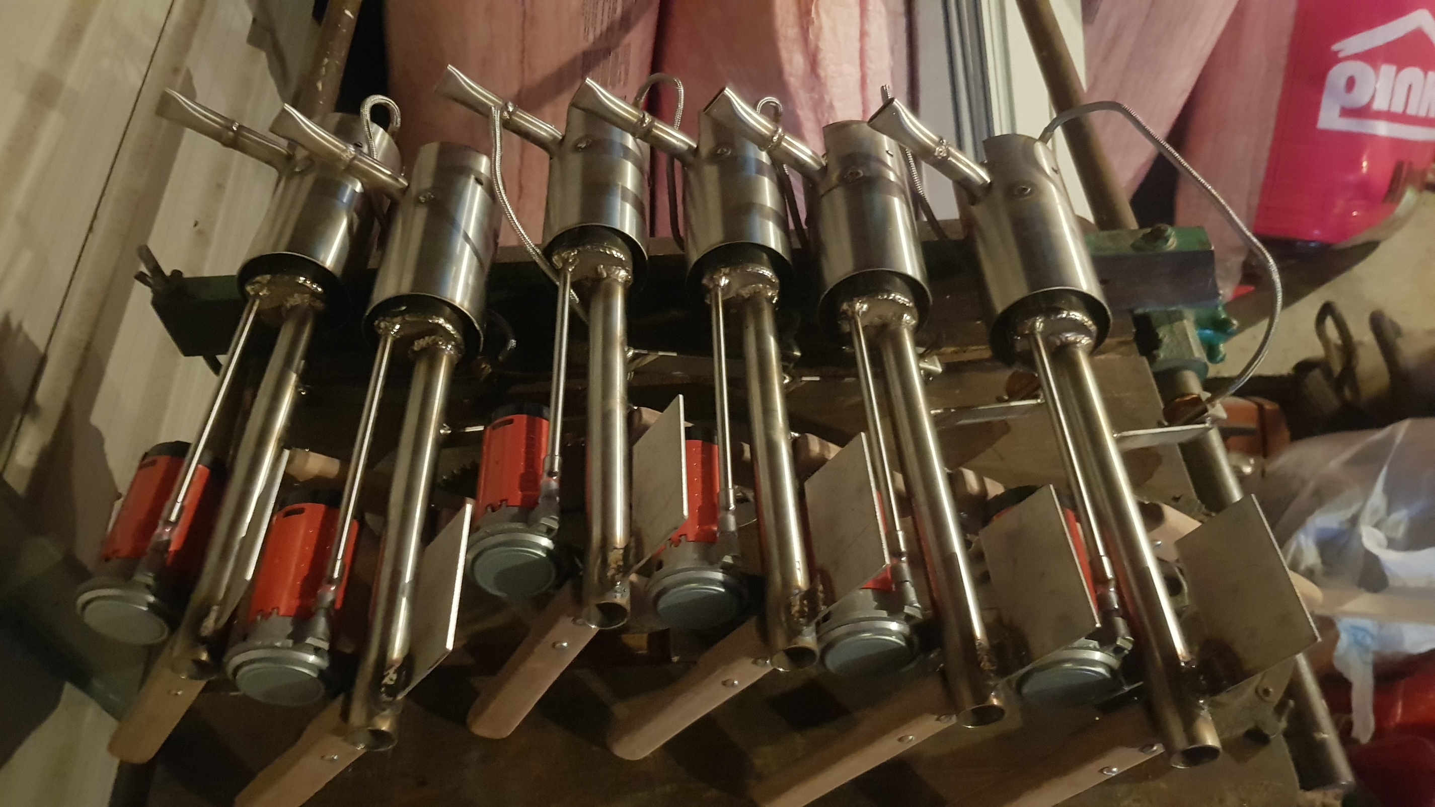

finnished my oxalic acid vaporisers so will be getting back to the gasifier soon
weve just braught a house to so getting ready to move into it
where moving in in 2 weeks so lots to do
Pardon my ignorance, but what is the purpose of an oxalic acid vaporiser? Where does the oxalic acid come from, is it useful or a waste product etc?
