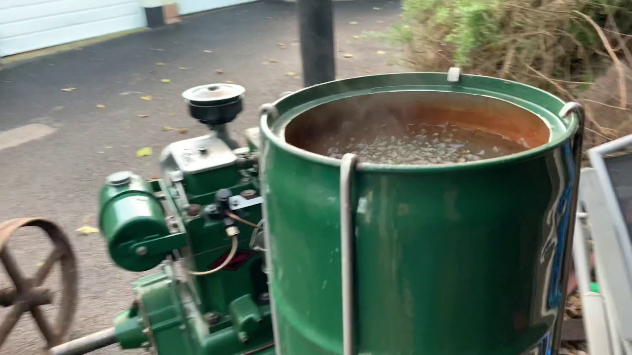

Hey Ashley:
This is a Petter AV2 series 2 these used to be pretty common and parts are still easy to get.
They can pull on a gasifier and here is the best part…
if you can get waste oil filter it well and thin it with some petrol then your fuel costs drop like crazy!
The wood gas can displace about 2/3 of the diesel you would normally burn and this will also help reduce carbon from the heavy oil, less smoke when running ect…
Run the engine around 1200 rpm driving a large alternator to charge batteries and this could be a very effective way to make use of your wood scraps as well as heat the shop.
