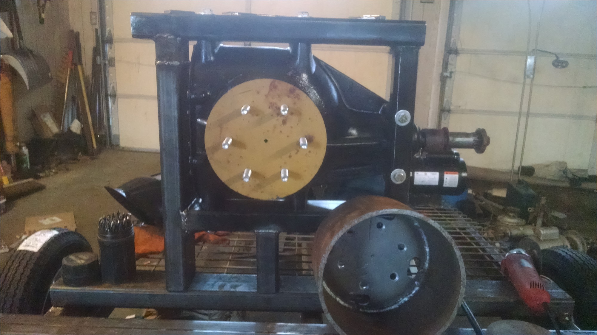

Sorry Marvin, I stole that picture off the internet to see if this is what you meant. When you said sleeve, this is what I thought you meant until you sent that other picture. I will see what I can do.

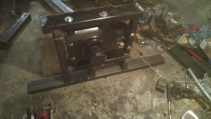

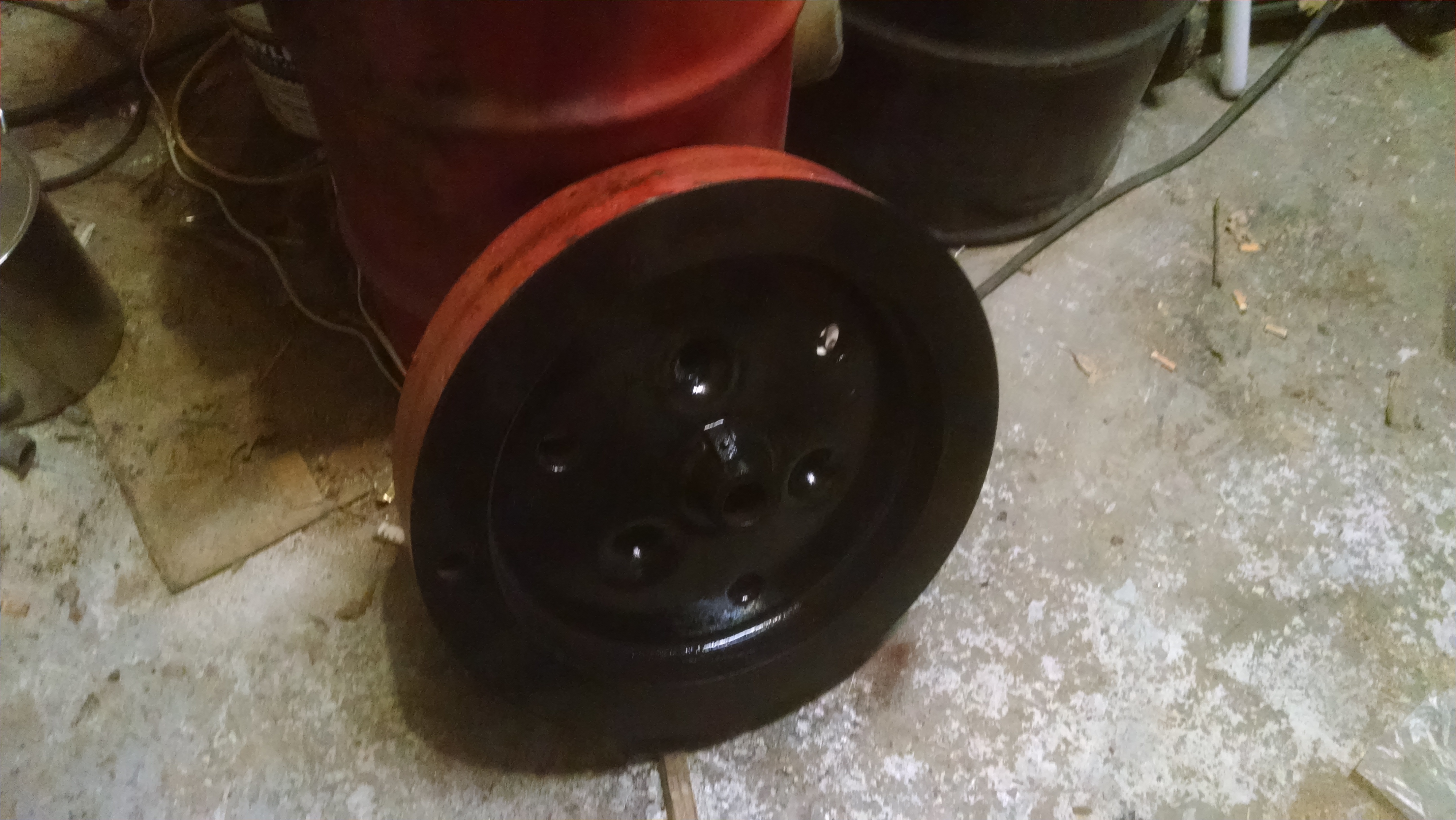

I got a little more work done on the chunker today and yesterday.
I also threw some paint on it for those hard to reach areas. Well I had to throw a little paint on the fly wheel too. I may be a bit impatient.
I also tacked on the bottom rail.

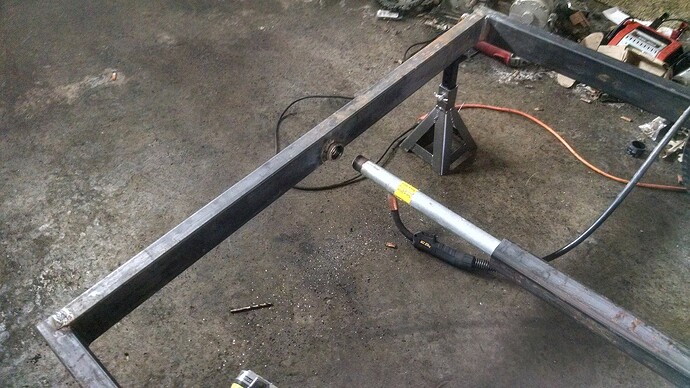

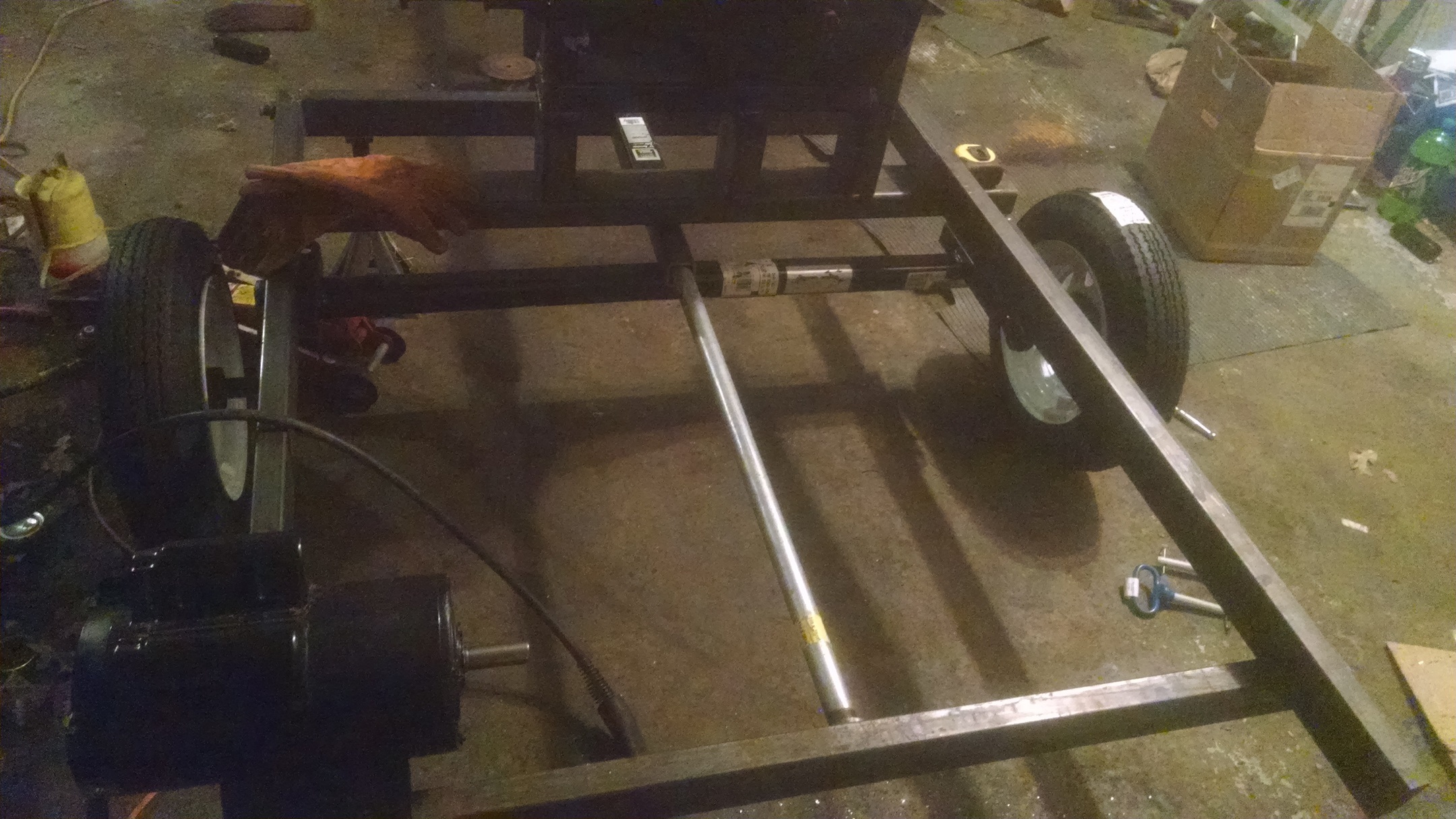

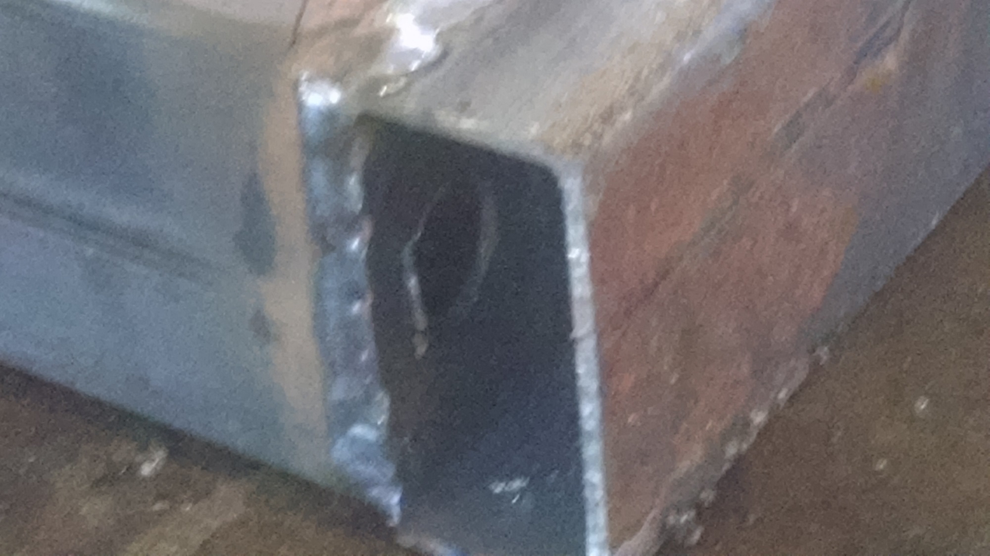

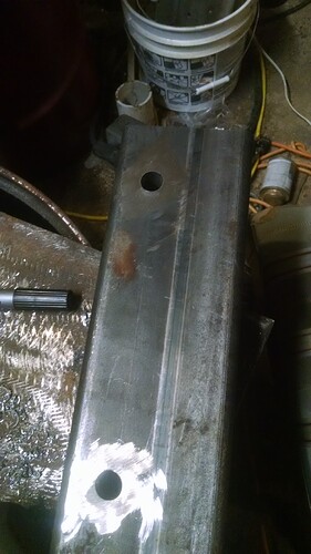

Because I am making this trailer road worthy I figure I better figure a way to wire it for lights. One of the problems up here with trailers is the same as our vehiclesā¦rust. This is my potential solution for prolonging the onset of rust and get my wires to the back of the trailer while still being able to remove the tongue or slide the tongue towards the back of the trailer.
I cut a 1" coupling in half and welded it to the rear trailer tubing. I had a 1", 3ā galvanized pipe in the garage left over from my other project. This way I can feed the wires though to the back corners where I also have holes drilled before welding.

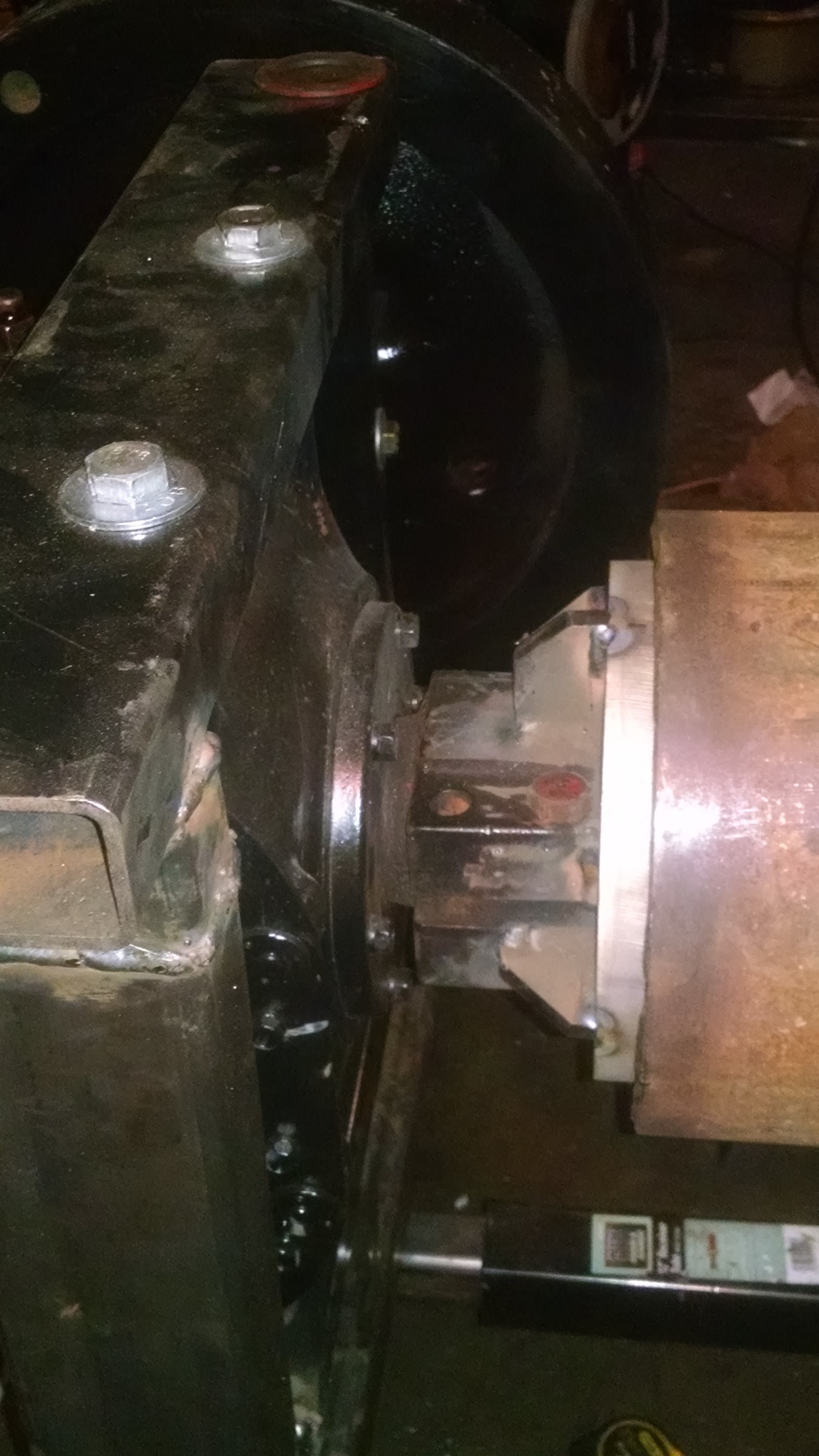

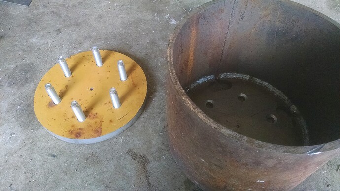

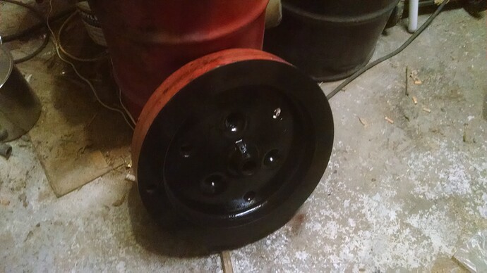

I had a hub made to receive the cutter. Not sure if I need to but this will allow me to remove the cutter. It will allow me to try different things in the future.
The hub is 3/4" steel with lugs pressed in. Now I need to able to get it centered to the shaft. I had them drill a 1/4" hole in the center for that purpose.

Iām not as good as fabricating as most of you guys on here and sometimes turn to the pros during my build when I think itās important and can afford it. The guy that watered jetted this hub for me wants to cut floor drain covers for our company, so it worked out well. Iām glad to get past this hurdle.

I like the āwheel rimā design. Youāre smart to have the chunker done first. Thereāll be no stopping you that way.Wishing you warm weather, but not the mud, and pot holes we have.
