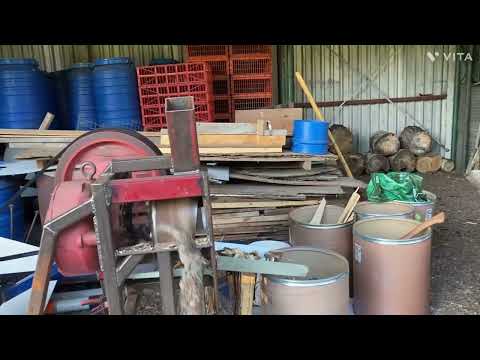

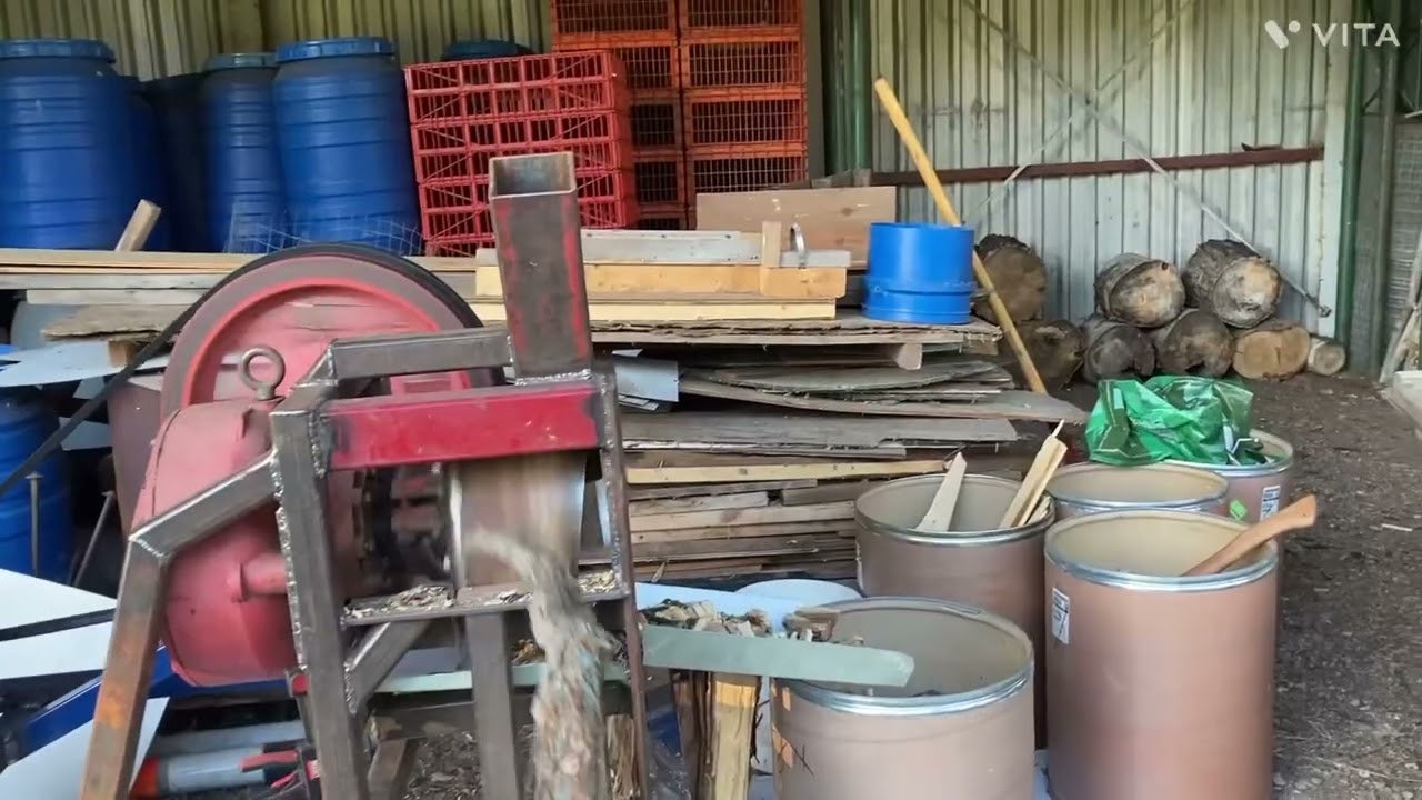

Before I got to chunking today I decided to make a chute for the wood to channel it into a bucket.
Took a short video of the chunker in action.
Tried cutting some spruce and oak. It turned out pretty good. The chunks are nicely split apart.
Tried all three of the main kinds of wood we have here. The aspen chunked the easiest since it was partially wet.
The chute turned out really well it greatly reduced the work involved in cleaning up the wood off the ground. But there was a lot of small pieces in this batch of wood. Mostly because it was all dry wood and it would tend to splinter. I’ve seen others make a wire mesh chute to filter out the small bits. But wouldn’t that plug up easily?
I was thinking of just cutting a square hole in the chute and putting it parallel metal rods all running along the chute to keep the chunks moving down. Something like this.
Then I could just have a bucket under there to catch all the bits and the large chunks should end up in the bin at the bottom.

Kudos on the emergency cutoff switch.
I think the parallel bar idea could work, but a little bit of small stuff shouldn’t hurt. You could maybe winnow it with a hay fork for the time being.
Really good job Bronlin. What is the horse power of that motor? It seems to have plenty of power.
Thanks Cody. To be really honest I think the emergency stop is just for looks. After the chunker is shut off it will still chunk several pieces. I’ve got a ten tyne manure fork and it works really well for sifting out the small pieces, but now I want something that will do that automatically. The dry wood will also splinter more so if I try to get some green wood I think that wouldn’t make as much small pieces.
Thanks Tom. The motor I got is a 3hp 1720rpm farm implement motor. Very high torque. It will start up the chunker in about 3 seconds. Picked it up locally for $350 CAD and have not regretted it.
I like the adjustable stop for the square shoot. At first i didnt realize what it was.
Looks very neat and clean.
Great way to safley finish off a branch or board without the fear of loosing and appendage.
