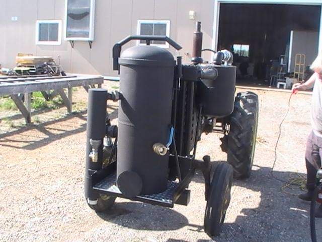

FB_IMG_1544927172697
Built with a flux core welder
