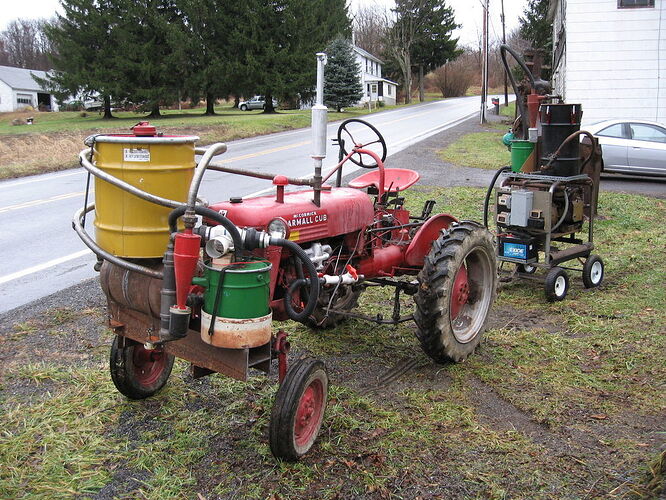

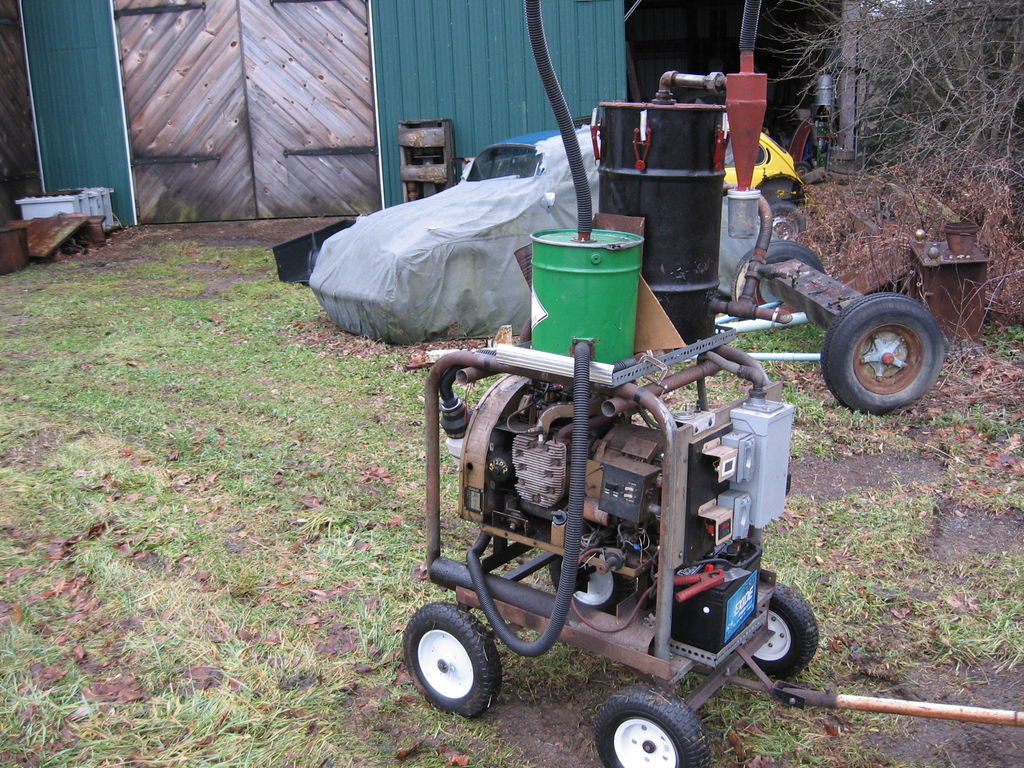

I am currently running a 7Kw kolher generator using this gasifier design. The picture also shows a Farmall cub tractor I am converting to run as dual fuel (charcoal/dino juice)
Another project I am working on is a shop furnace that heats water for radiant heat floor and charcoal producer. I’ll see if I can get a picture of it up too.
