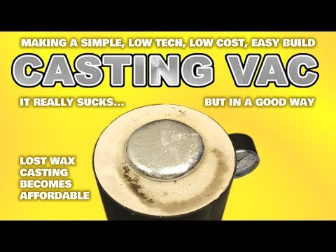

Not to change your technique, but you might find this guy interesting. He is doing vacuum casting. using wax and plaster. He has a homemade vacuum chamber and pump. and while the pump kind isn’t as good as a vacuum pump, he doesn’t get that bad of results. And his series goes through the whole process.

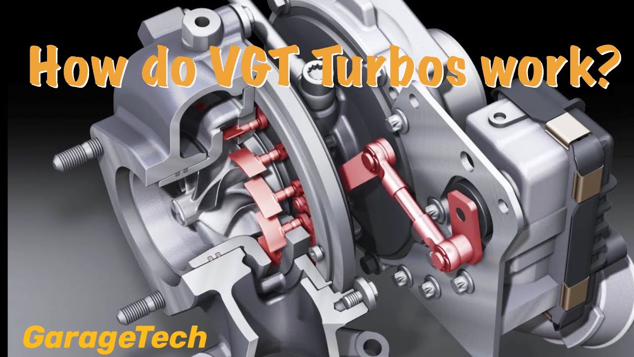

I personally like Francis turbines the most, which also works in the widest range with great efficiency, here is a link from the Slovenian manufacturer of turbines,…
It would be very interesting to use a variable turbine from a smaller car, for example from a fiat 1.3 jtd, this one has a narrowing made with a diameter of less than 20mm and a mini Francis turbine would be created…
