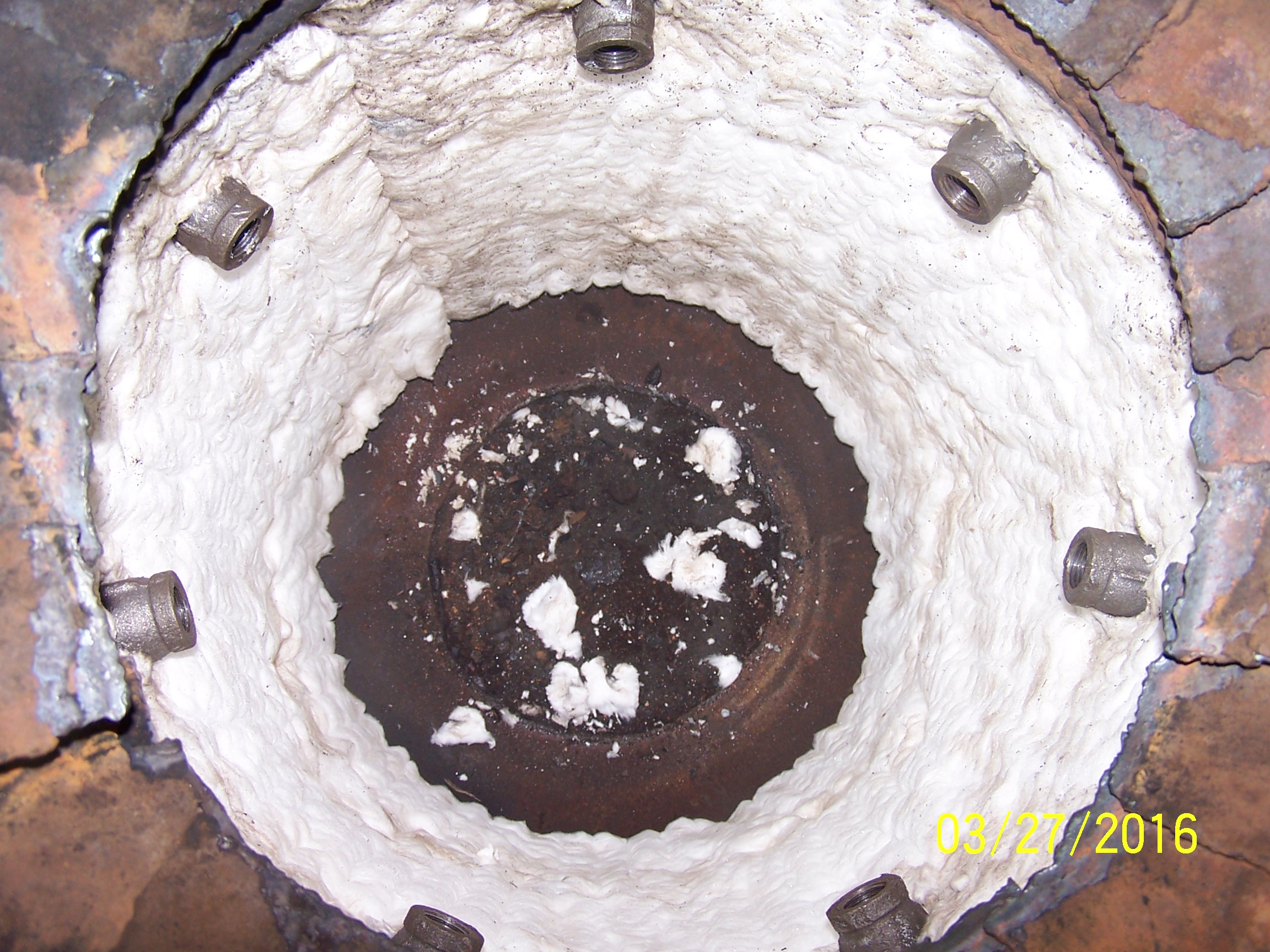

How do you attach the ceramic blanket to the inside of the firetube?

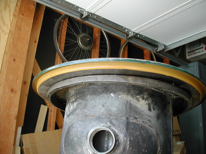

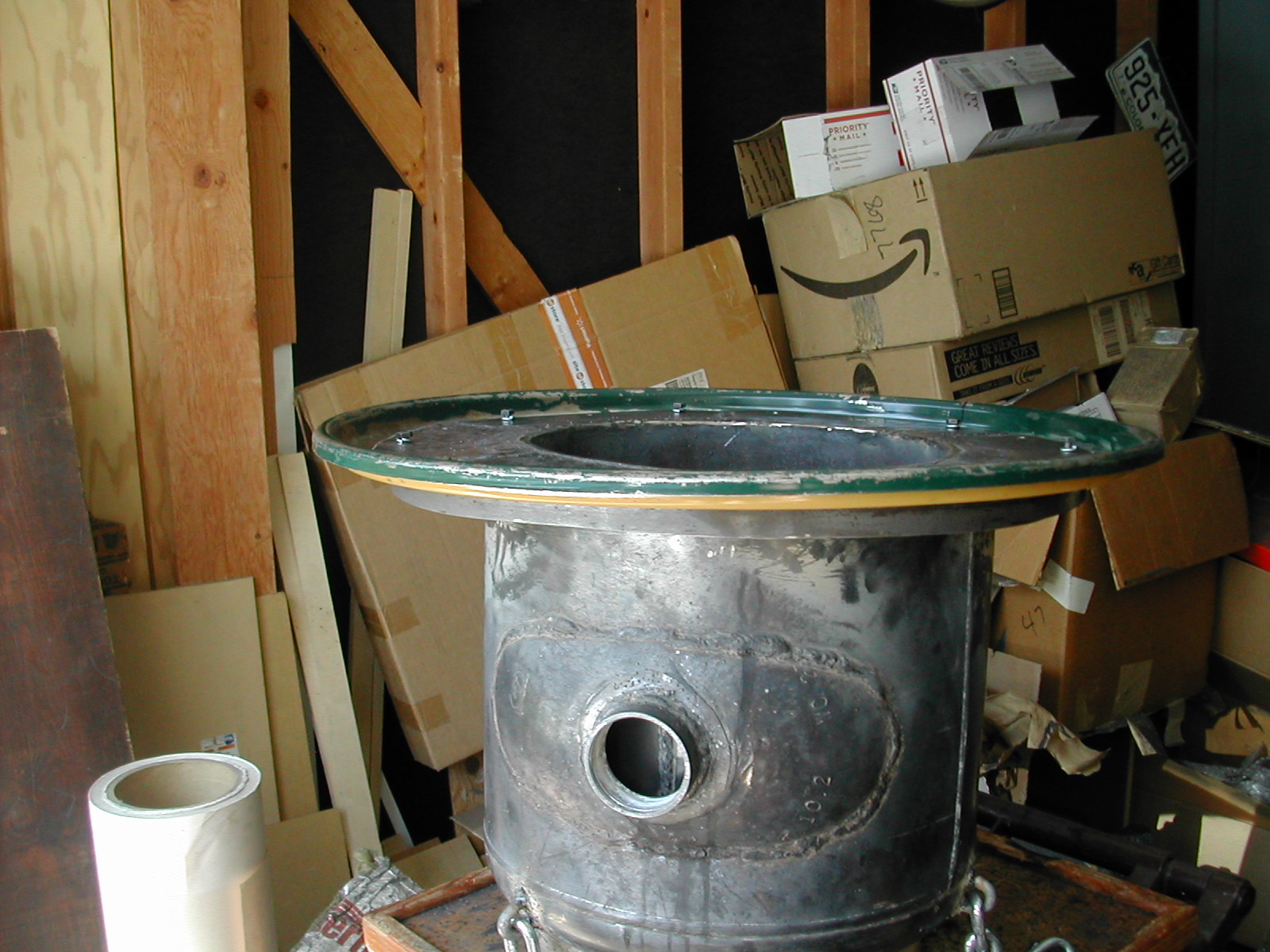

Here are some pictures of my firetube, top plate & etc. I made a ring with threaded holes in it. Screws go down into it from the top plate. Is this area going to be cool enough to seal with 650F RTV?
Thanks,
cut it a tad big and it will stay where you put it by itself.
what don said and the nozzels extending through will help I also extended the top plate in farther so the wood don’t sit or hit the top of the ceramic .
Is this material good enough?
How about the price?
Thats the Stuff. You can get it from McMaster Carr too. I just ordered all the stuff to make Perlite / Aluminum Oxide barriers on the new machines. The combustion chamber and the reduction will both have a 1" thick wall of the stuff ![]()

I can’t remember where I bought mine, but it was a lot better deal than I found on ebay. I bought a 25’ roll, and used it for more than just the fire tube. As of right now I would build all my fire tubes this way, seems to hold up, and less work, and weight .
