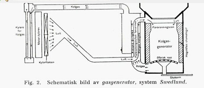

Yup and that allows for simpler design as I am now finding out. My downdraft charcoal unit has not problem with a 30% mixture of wood chips added in.
Im actually considering re classifying them from “charcoal gasifier” to “Hybrid Gasifier” Unless there is a better name to classify this type of gasifier.
I see Matt’s design in this with the ring type nozzle.
Maybe this is where the US got their idea for the FEMA?
You might notice the preheated air off the exhaust and in the drop box heat exchanger, drop ash/char box, No slyclone filter. Manual grate shaker, cooling rails with condensation tank.
I like this design. Yes this unit is quite different from other charcoal units.

Well from what I see the water drip could be added just before the ring nozzle.
I would add a restriction open to increase the air/gas velocities at that point with ash for protection on top. Talk about charcoal reserve below the nozzle ring or restrection opening if added… Wow it could handle a long high vaccum pull.
The manual grate shaker looks to be a problem if air leaks in at the shaft.

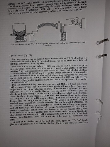

I want to say the standard for bottom central shakers is to use two series of threads. A pipe in a pipe with a central bar. Hopefully with heavy grease and the labyrinth seal of the threads it should be air right.
