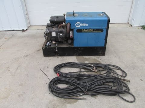

Looking at the details of this Clint R’s engine adaptation video (that will not directly link up!) and Ernies pictures I can see, and think back, on my own previous Miller welder-generator; you have to reverse your outlook.
On most personal sized direct driven engine electric generators distinctly the generator head mounts onto the engine. The engine as the mounted core of the system.
These bigger capacity welder generators this is reversed. The generator-welder part of it is big heavy cast iron, with an engine mounting bell housing. All of that four points mounted. The engine is hung off of that essentially.
I’d never thought once of repowering a Miller.
I selected; then dug down deep to buy mine new for that modern EFI engine.
Passed up for much less on two different used older 1800 RPM Miller generator-welders. Not wanting their old hard to get parts for low compression flat head engines.
Wow was I ever stupid. Adapt over to a modern.
Don’t any of you all be Steve-stupid too.
The old 1800 RPM units are gold.
the older lincoln’s were decent welders, but some of the smaller models had some quirks. Buddy has one that the governor inside the motor crapped out and when high idle switch kicked on it would sing out to about 4600 rpm and started a death shake. We tore it down and found the problem but could not source parts to fix it, so we pulled the motor and found a elongated taper shaft hookup to the gen head/ welder. Very odd setup with a older briggs motor and could not source a replacement engine with the correct crank shaft. I have the sister machine to it sitting in the back of the shop a few years newer and it uses a kohler engine with an oil pump and filter, much better setup in my opinion, even they I prefer honda small engines I have ran a great many kohlers and they work great until they don’t. Usually catastrophic failure of rod knock is what I see kill the kohlers but they run like a gut shot bear up until that point. I have seen that same failure on briggs motors as well but I have never actually killed a honda engine, just wore it out till it smoked so bad it was unusable or loss so much compression it became an ether baby. That being said that is only my experience with these small engine generators and welders, I’m sure others can tell a different story of there experience
The kohler motor I used doesn’t have a tapered crank, I welded a hub for a pulley to the flexplate and the bellhousing fit but upside down. I had to setup my own governor, at correct rpm the voltage will read 120 volts.

Yes Ernie the same straight motor shaft to a taper hub fix that that Clint R. said he did. Clever guys you are. “Make-Do, or do without.” Attitude approach matters.
Hey TomH on your E-bay link is listed a Miller Trailblazer 301G pretty much like mine was. 3390 use hours on the meter. Impressive if it was the original Kohler engine. Asking was $2,500 USD. Pictures there show the engine actually hanging off the end of the unit as I said.
On a Repowerspecialist site they list Honda V-Twin engine re-fit kits for your’s and other welder-generator models.
Did not want you browning your pants at the price of those. Pictures do show the shaft adapter coupler though if you’d want to peek.
Tom, I have that exact welder, bought it in the 1980’s. Mine has the 16hp cast iron Tecumseh single cyl. still runs. Used it on lots of construction jobs. One of the smoothest running welders I ever used, with 7018 rods.
Hi Al.
Mine is a 1986. Hard for me to believe but I still have the manual for it. Same engine. They don’t make them anymore. I have seen on other forums that you can’t get parts for that engine, but everything is still available for the welder portion. I always thought Tecumseh’s were supposed to be crap engines. I’m surprise Miller used them but I guess the XL designation made it better.
That Trailblazer is a really nice welder SteveU. I’ve run them before. They don’t go for $2500 any more. I can’t believe the price for some of those welders now.
I often thought if the engine went, I would put the V-twin HF engine on it.
Before I bought my Miller Trailblazer new I looked at three different of these older Millers, used.
These were at an older equipment rental company going out of business.
Ha! I could have gotten all three for less than the price of the new Miller. Had two depth back up then. Been my own spare parts supplier.
Just saying guys. Don’t overthink this stuff. These dual cylinder Onans have been wood gassed successfully.
And as Ernie I. and Al F. have said; you can always just engine re-power it.
