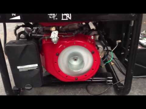

On MattR’s woodgas converted unit video you can see he went in through the front cover unit to the all-metal air cleaner box. His modifications I consider proprietary in case he wants to offer up a conversion kit.
I puzzle why this converter guy thought that he needed to add a gasoline fuel shut off valve.
The factory Run ↔ Stop knob only shuts off the gasoline to the carburetor. Does not turn off the ignition. Just do not put it into Start-Choke when on a gaseous fuel.

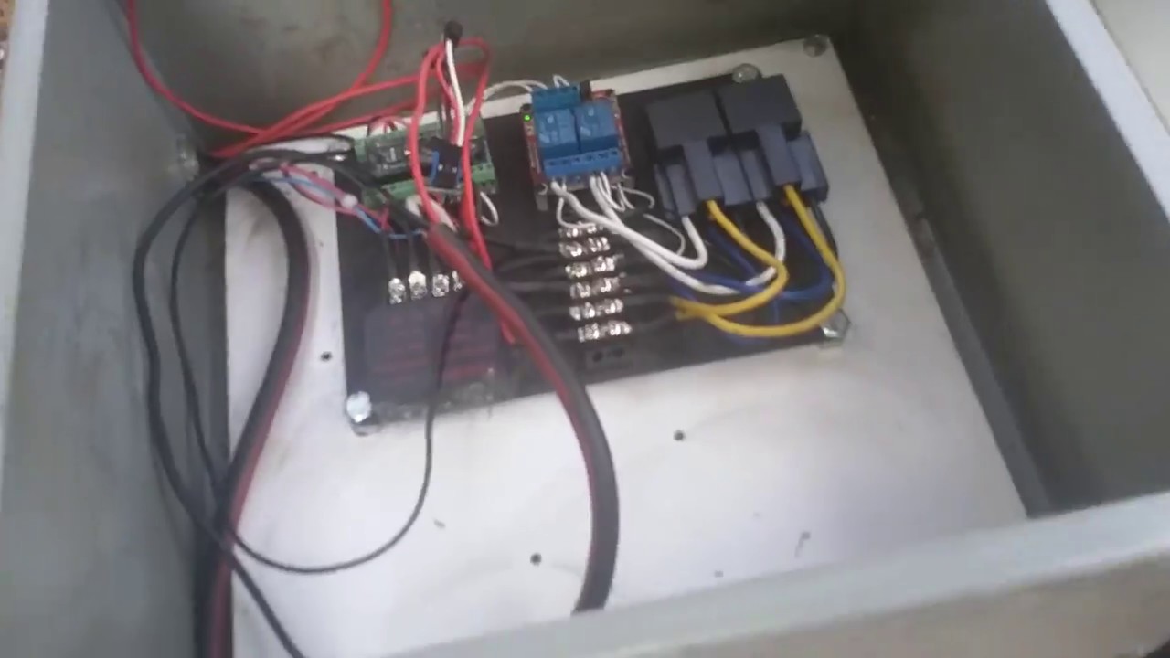

Auto start you will need all of this plus Retry programming cycling between these modes until success or a counted out number of attempts to save the starter and battery.

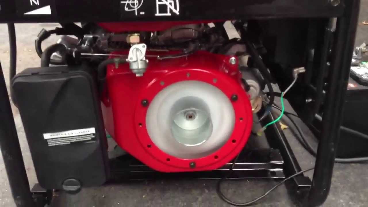

Ya, I don’t know who this guy is with the blurry camera, but he definitely is doing what I am interested in. His inverter probably has the same generator start circuit.
So what kind of engine is his?
Yes
The starter is likely going to hit the steel frame of the generator ( this is across the board all generators in this class )
A 212 crankshaft is a stroker crank and its most likely got a different taper.
A 208 uses a standard stroke crank and it could go one way or the other.
A 196 is a standard engine.
Crank shafts are the difference, they all physically in each others blocks but they are not functionally the same.
The taper is the difference.
The simplest way I can tell you to check your new electric flywheel is the same as your old one is to put a coin in the hole.
Does it line up in the same place, if the taper is different you will see it.

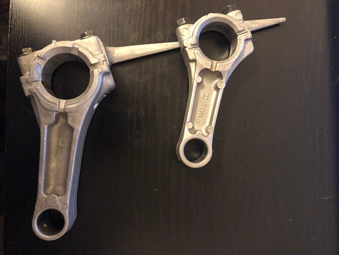

I want the big block because its bigger and stronger in every way but most importantly in the rod.
The small block rod was developed for the GX160 rated at about 5 hp
