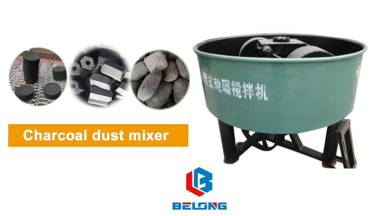

Just posting some interesting video on the subject of bricketing and charcoal processing. I would really like to get my hands on some of these to play with and see if they could be gasified somehow or maybe if we go back to the originator of this thread is there an optimum way to manufacture a high density uniform type of fuel specifically for gasification.

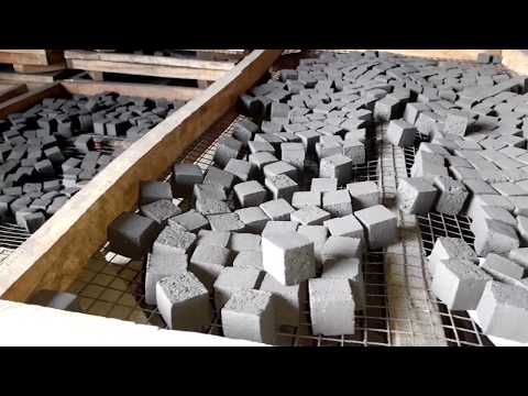

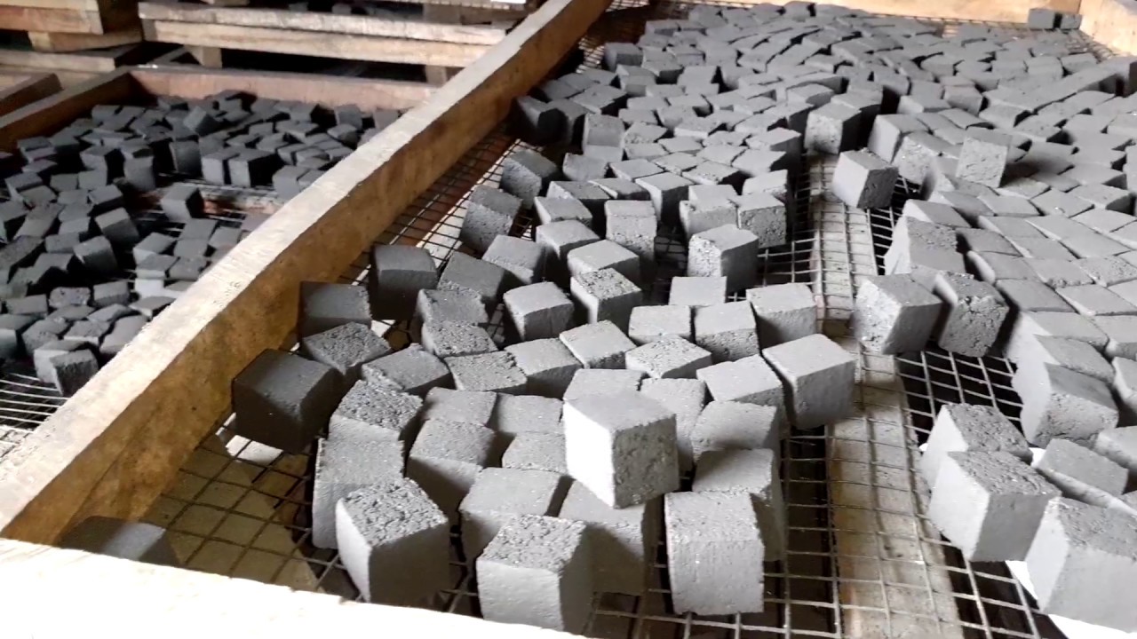

This product looks almost ready for a gasifier, I wonder if he has ever seen it and experimented with it?
Many times I looked at my log splitter getting only a month’s worth of work a year and thinking what else could I do with that thing. Compressing charcoal pucks might me one thing. Would take hardly any work.
I never had any interest in the matter until this thread and I saw those square compressed blocks. To me that ideal gasfier fuel or does it pose a problem that I do not see.

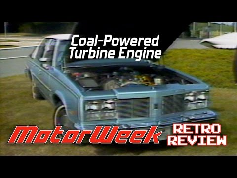

I found an article in the NY Times which I think may be describing the Oldsmobile, or at least the same tech, from the MotorWeek video above:
It briefly describes the project:
“…the powdered coal is carried in a small tank in the front engine compartment. To start, compressed air pushes the powder into the turbine combustion area, where it is ignited with the assistance of a squirt of liquid fuel. Once the engine is running, compressed air is diverted from it to the fuel tank to keep the coal powder flowing, like a liquid, into the combustion area.”
The first I’ve ever heard about this and we are a quarter of the way into the next century. I guess the idea went nowhere. I believe it would be difficult to store and distribute the powder without it picking up a fair amount of moisture causing it to cake up some. Still, an interesting idea.
