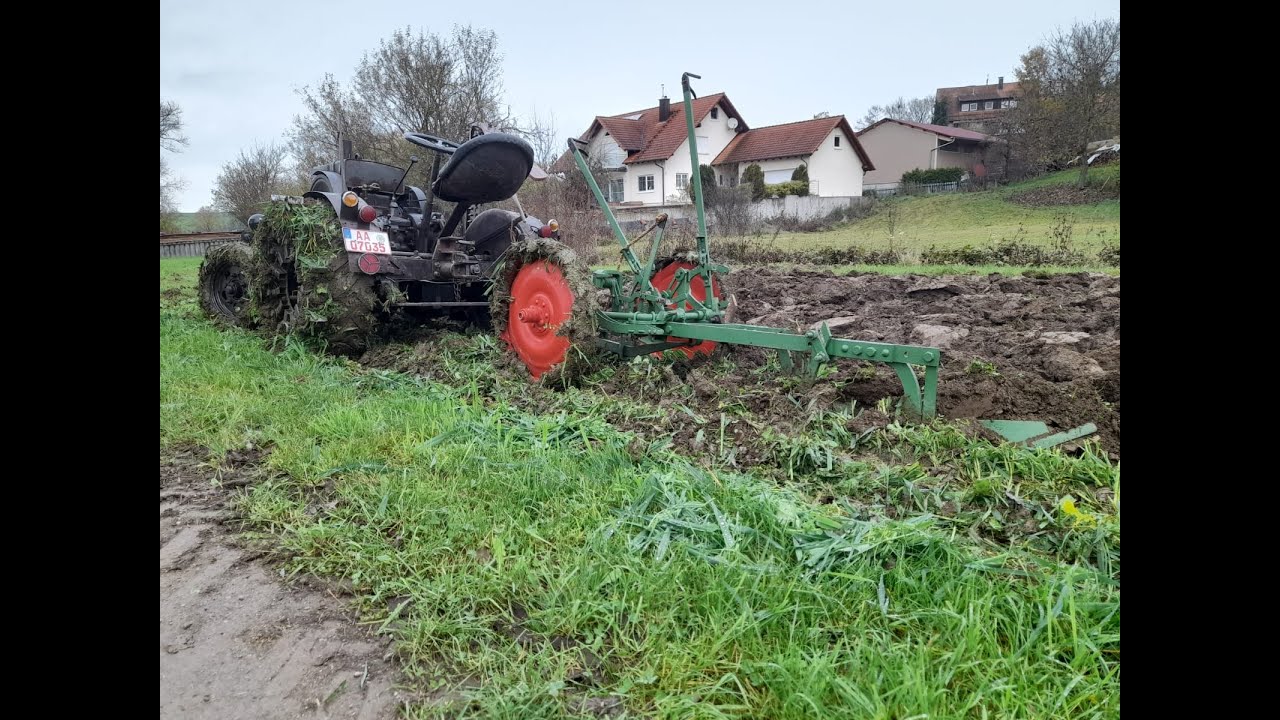

some useful work… :grinning_face_with_smiling_eyes:

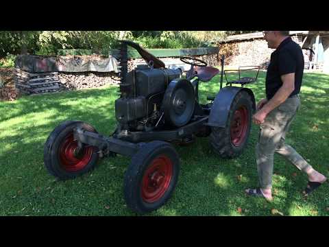

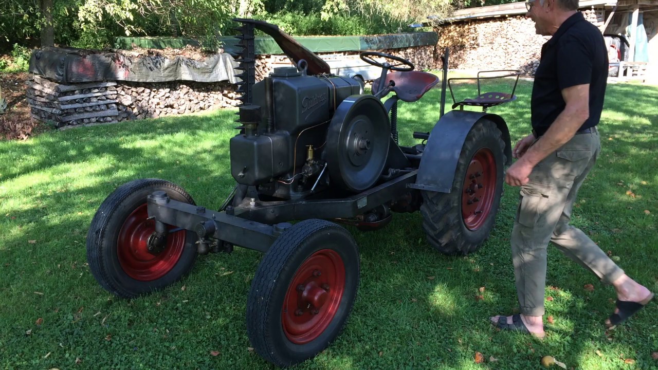

your motor will also give a nice tractor…
and the robust front axle would be ideal for gasifier positioning, much space!!
when i was around 25 years old, i drove once the kramer 12 k, the model after this.(lended to me by a neighbour)..
exiting to start by hand crank, must be screwed in a glow cartridge, a lot of smoke , the whole street in the village with a smoke cloud…(at cold engine only)

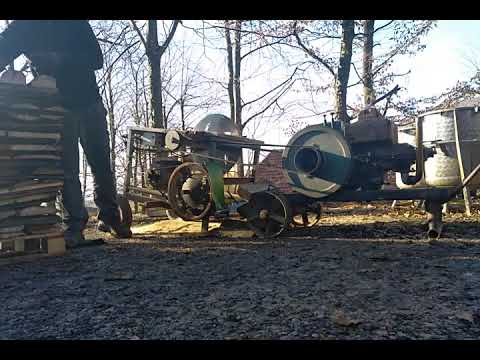

Yesterday I was visiting a relative, and among other things I saw this…
Other than it was made by International Harvester out of Chicago U.S.A. I can only guess. I would guess some kind of hit or miss engine, but this seems more complicated than a Lister.
What a wonderful engine Tone, i love it!
Low tension, “make-and-break” ignition, really old one. :star_struck:
Did it accidentally follow you home?
It is a Nonpareil Famous engine manufactured by interational harvester. around the early 1900s. It can be worth 1000s to 10,000s depending on model and condition. I can’t read the model number on it, but it might be the 4hp variant.
Mr. Bob, unfortunately it is not for sale yet, but as I mentioned it is at a relative’s, maybe it will accompany me home sometime in the future. :grinning:
It has an interesting Bosch ignition system, where a mechanical lever rotates the rotor by about 60° and at the same time a spring is tensioned, which is released at the time of ignition, which causes a rapid rotation and an electric spark. The spark plug is also of a special design, I think that the revolutions are maintained by interrupting the ignition. The engine has only one mechanically controlled valve - exhaust, the intake valve acts as a check valve, it only has a gentle spring that closes it.
Hi Tone, yes the ignition is very special, as i called it “make-and-break” when the magneto is in exactly the correct angle, the rod should hit the lever for the points, placed inside combustion chamber, cutting the circuit, this gives a really “fat” hot spark.
Low tension magneto system.
In position D is where the current is higest, here should the rod hit the points, open them.
Fast opening of the points is beneficial, many systems also has a special “trip” mechanism, that lets the points close Hard, to keep them clean for good contact.
But you probably know this already. :blush:

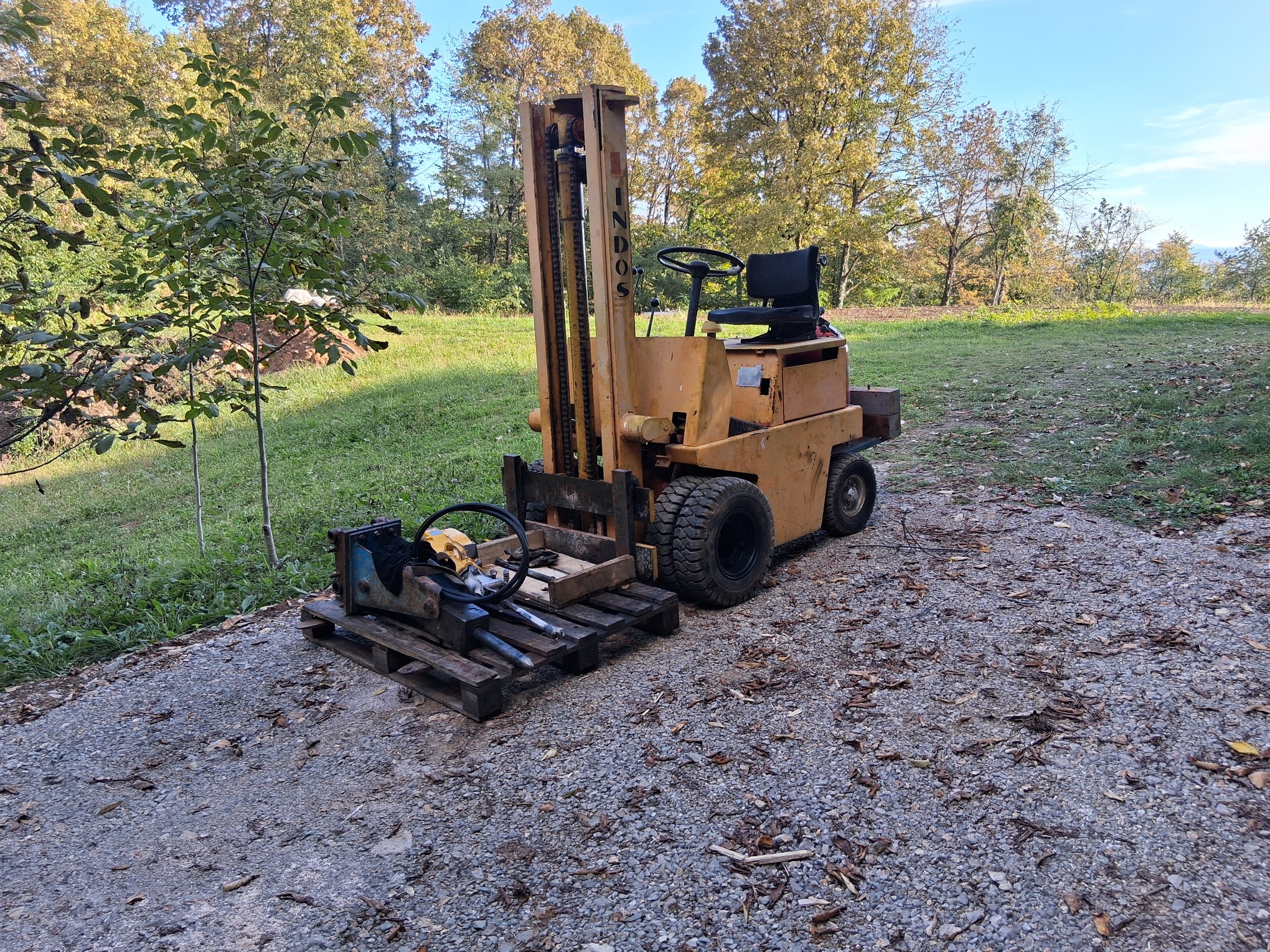

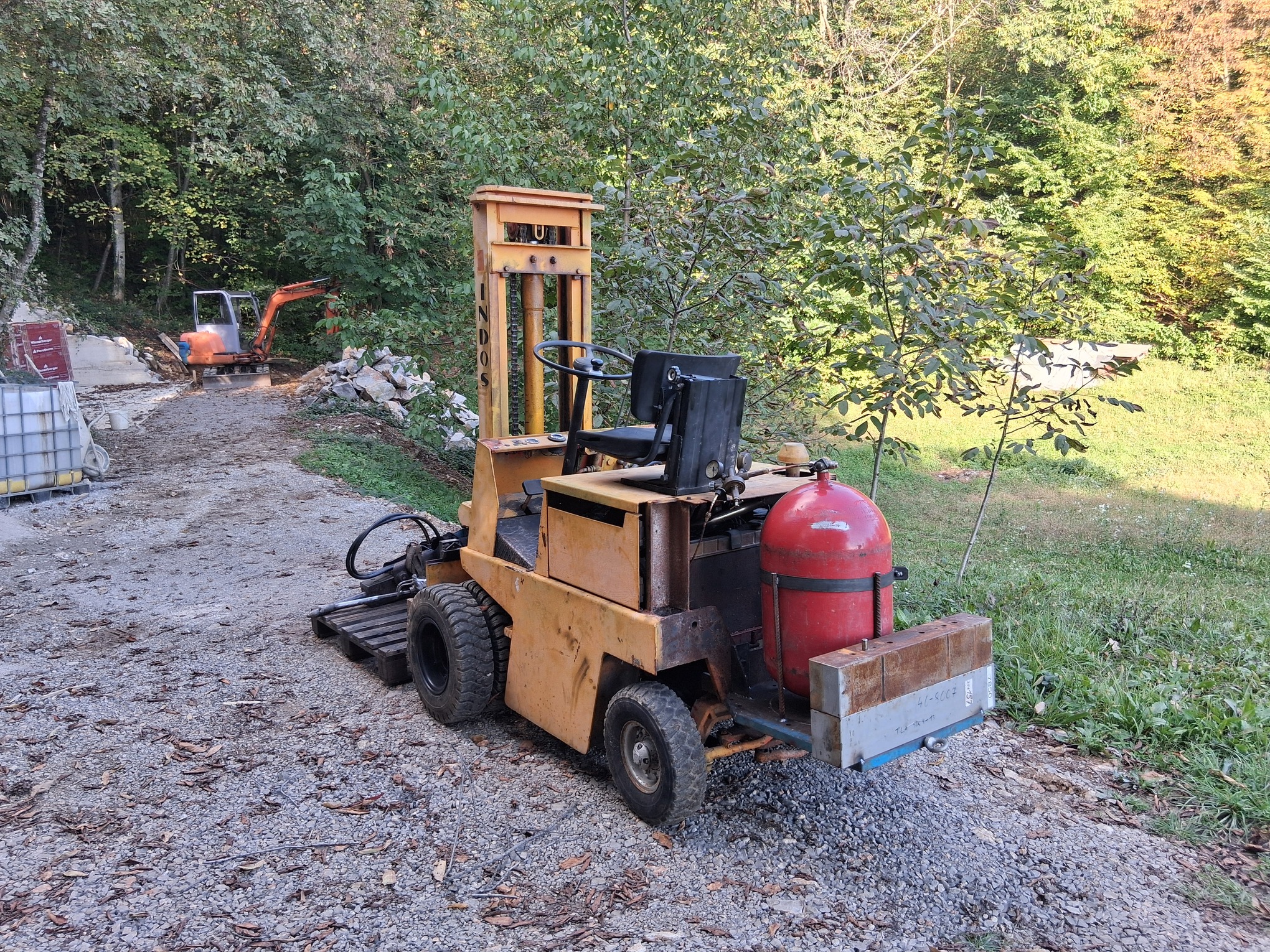

This forklift followed me home about a year and a half ago, now I found some time to get it running. The year of manufacture is 1979, it has a manual transmission, the engine is a Yugoslav copy of the Fiat 1500. I added some weights to the back, because the original weight is much too heavy for driving on the steep terrain we have here, well, for now I installed a large heavy cylinder that I got from a scrapyard. The cylinder was intended for storing compressed natural gas - methane, it still has about 8 kg of gas under a pressure of 10 bar, I plan to use that first,…
I apologize for writing 10 Bar above, a mistake, the pressure in the cylinder is 100 bar.
I’ve been doing some work with a forklift these days, just short trips of a few minutes. It works very well, no smell or smoke, just like Fergie. I did some calculations again, how much wood gas I could put in this cylinder under 100 Bar pressure, well, that would be about 4 kg, which would mean 20 kWh of energy, for comparison, that’s 2 l of gasoline, that much gas would probably be enough for 1-1.5 hours of work, which is very good. The only problem is the high-pressure compressor… which I don’t have. :slightly_smiling_face:
