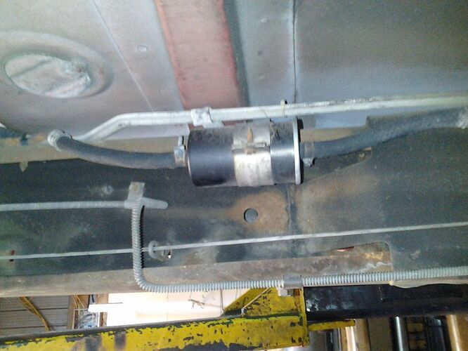

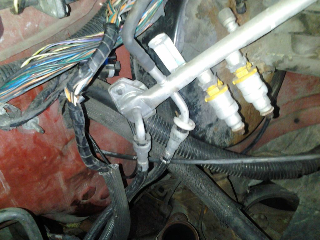

Chris
Here’s a couple of pictures for you. Looks like the only easy place to hook in is by the fuel filter or test port. everything else seems to be quick connects.
Marvin
Thanks Marvin. My 0-3 voltmeter just arrived from China, so I’ll be looking at that project sometime soon.
