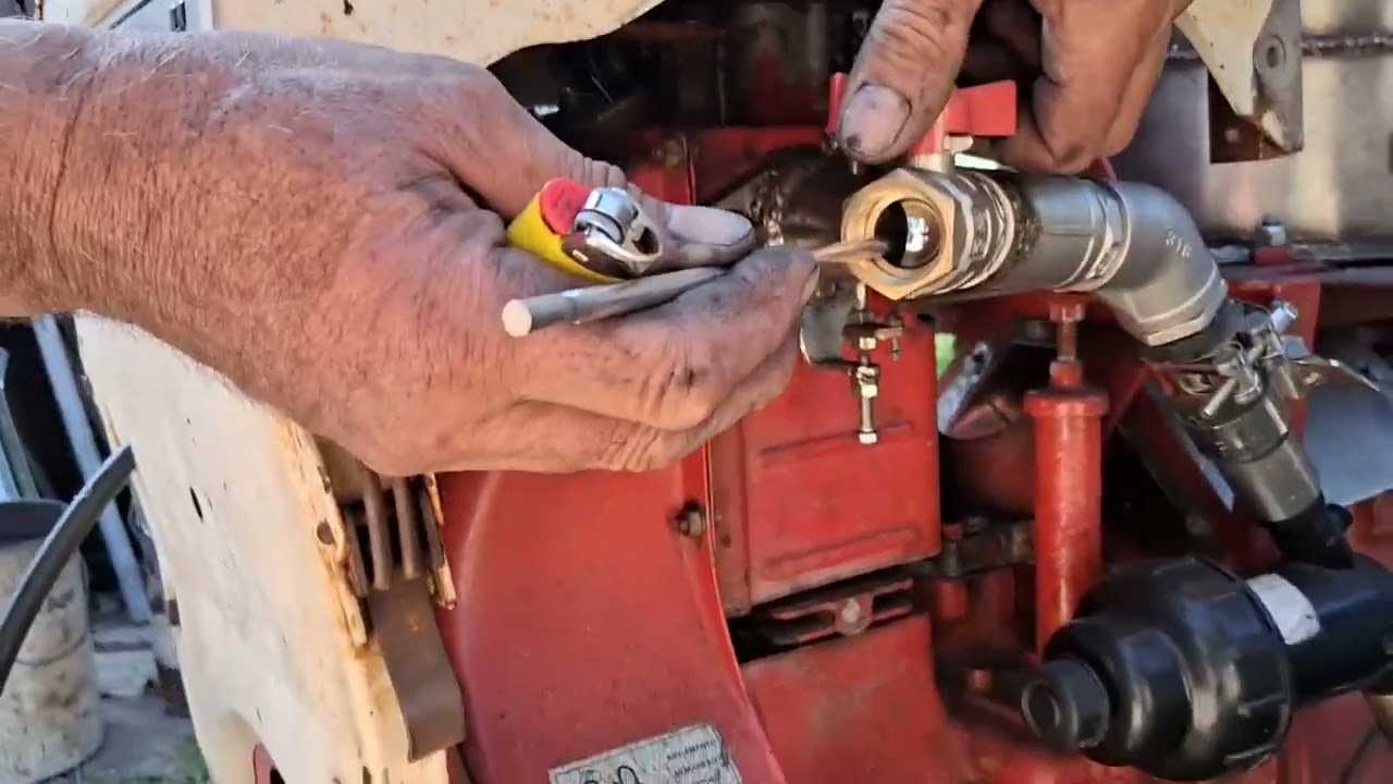

as with the actual throttle was yet a bit" high and low " work with the regulator, we made the throttle nearly round shaped…now it runs perfect in all rpm…remember i made the throttle oval shaped because i dont know the force and the way what the regulator is able to do…
the throttle has 37 mm diameter…the oval throttle , with a small movement, has allowed too much gas to pass through
Giorgio, the large surface area of ​​the throttle valve and the high vacuum create a fairly large force on the valve shaft, if I quickly and roughly calculate the force on a 37mm valve, it would be about 10 kg, … If you imagine the valve shaft, which is on a sliding surface, this requires a lot of force, and the oval valve has an even larger surface area, which means even more force and friction. The centrifugal regulator creates a lot of force, but we have to imagine that the spring force is equal to this, and the valve only has to be moved by the difference between these two forces, so it is very good that the valve is on well-lubricated bearings, which do not represent any friction
from my understanding, but of course it can be wrong, in a restriction (think on a venturi pipe) the negative pressure becomes higher, so a smaller throttle diameter is not less forced by negative pressure, because the vacuum stream sucks stronger…
when i think in a theoretical extreme and i have the throttle diameter of 50 cm, the suction will not be to feel much…only a thought for understanding of course…
also in water systems, when a piece of the tubing has smaller diameter, pression rises , so also in negative pressure systems, i think…but my conclusions can be also wrong…
the oval throttle has the thought behind that suction can act less on it, what from my sight should really be true, but has the drawback that with little movement can pass a lot of gas through. this was clear before, and to make the throttle more round was not a problem…
now the motor runs really like a bell, how my grandmother always said…
