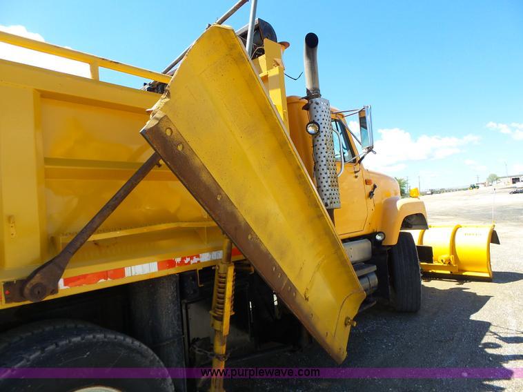

Hi Bill…we must of been bringing our new toys home about the same time. Bought this truck on purple wave auction service. It was a Macon county Missouri (MO DOT) truck. The pump on it runs all the time driven off a short pto off from the crank shaft out to front mounted pump. First dump truck Ive ever had with AC and electric windows. We ought to go in the snow plowing business together…LOL I have removed the plows but left the front attachment points in place just in case. Removed all the side mounts to reduce empty weight.

Side View
I can’t help but notice that the removable/replaceable scraping edge looks a lot like a big (dull) knife blade out of a chipper/planer. I’m wondering if that could be repurposed somehow…
That’s a beauty Gary!
It looks like it was taken care of. I’m sure you got a better deal than I. I’ve been very happy with my purchase and working my truck. I’m really happy I paid for the dump option.

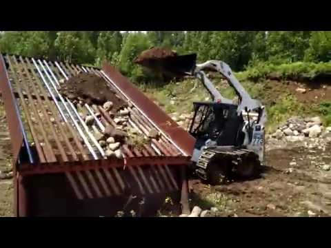

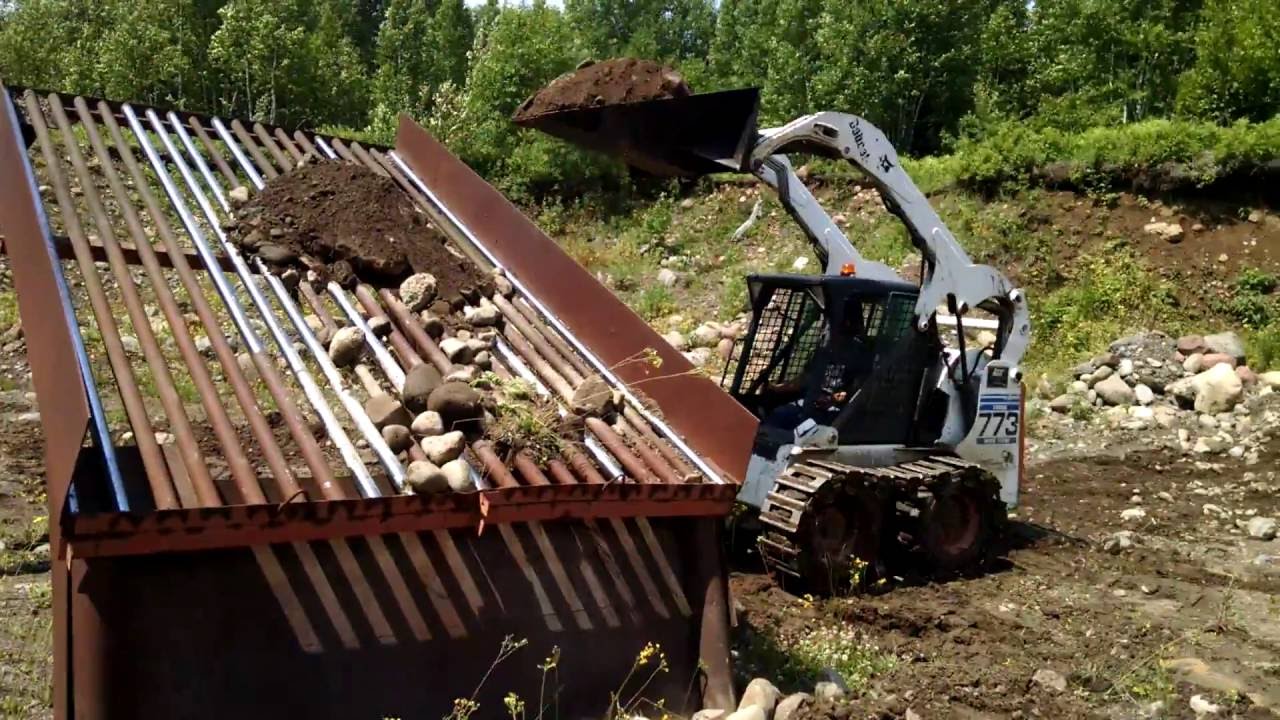

The neighbor asked if I could use his rock screener or he had a buyer for it. I told him I could really use it to fix the road and would like to set it up. It had been sitting there for many years.
I couldn’t set it up for as high as it should be to work more effectively because all I have is a skid steer. But I have all the material I could ever use. Here’s a short video of my youngest Son giving it a try. I need to make some feet for it
Rock on. Hope MSHA doesn’t show up to save you from yourself (at $1,000 a pop).

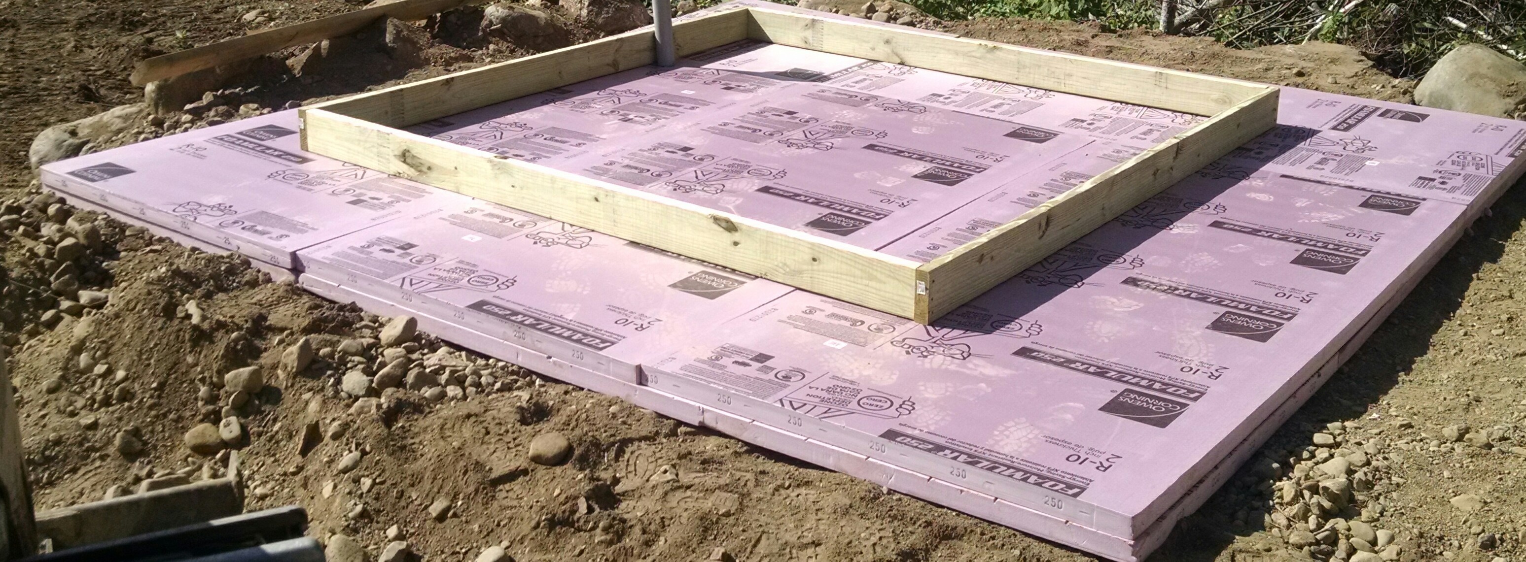

I’ve been screening and hauling dirt all week to make a level spot for the generator shed. I used some big rocks for a retaining wall. I got it leveled off today and put down styrofoam to give me a r value of 20 below the concrete. I bought 6" wire reinforcement mesh to tie the Pex tubing to. I will place a second layer of mesh spaced with rocks to hold it up to the middle. My question is, is there a trick to hold the form square while putting concrete in? Do I fill the outside of the form with dirt first to achieve this?
Usually you hammer in 2x2 stakes every 4ft roughly approx 12"deep, level up your rim boards to them tack them in, cut off anything above the rim for easy screeding. Sometime I will backfill if My depth is too much like for a reinforced slab.

I have been wondering about insulating concrete slabs to make a “thermal mass.”
I wonder how long that stuff retains its insulation value?
I hear people complain about plastic lasting in landfills for millions of years, so maybe for a long time?
I was thinking of using biochar, since I know it really is supposed to last a long time.
Also, why all the effort to insulate the generator shed?
Looking at the picture now my answer won’t work. In your case I would recommend 1/2" rebar instead on 2x2’s fastened with two nails bent over . My understanding is sm insulation is rated at 100 years if covered in soil and not exposed to light… that’s what they told us in trade school…
Kyle, we had a mild winter last year and hit -25 a few times and a lot of below zero days. My batteries had ice forming in them. At that time until April, I had half the capacity of my batteries. My attempt here will be to install PEX at the bottom of my forms, 12" apart and use the diesel generator coolant to circulate through and warm up my concrete. I am building with 2"x6" walls to hold as much heat for as long as possible during our long winter.
I now understand why warm batteries are good and hot or cold batteries are bad. If the in floor heat doesn’t work well, I have a heat exchanger I can run under the batteries that will be raised off the floor.
For that 6x6 reinforcing screen, I always lay it in and then as I pour cement I take a hay hook and give it a tug to get it up off the bottom but still part way under. TomC
I will have 2 layers of 6x6 wire screen. The bottom layer is what I will zip tie the PEX to.
I do like the hay hook idea. Yes, I do have one.
