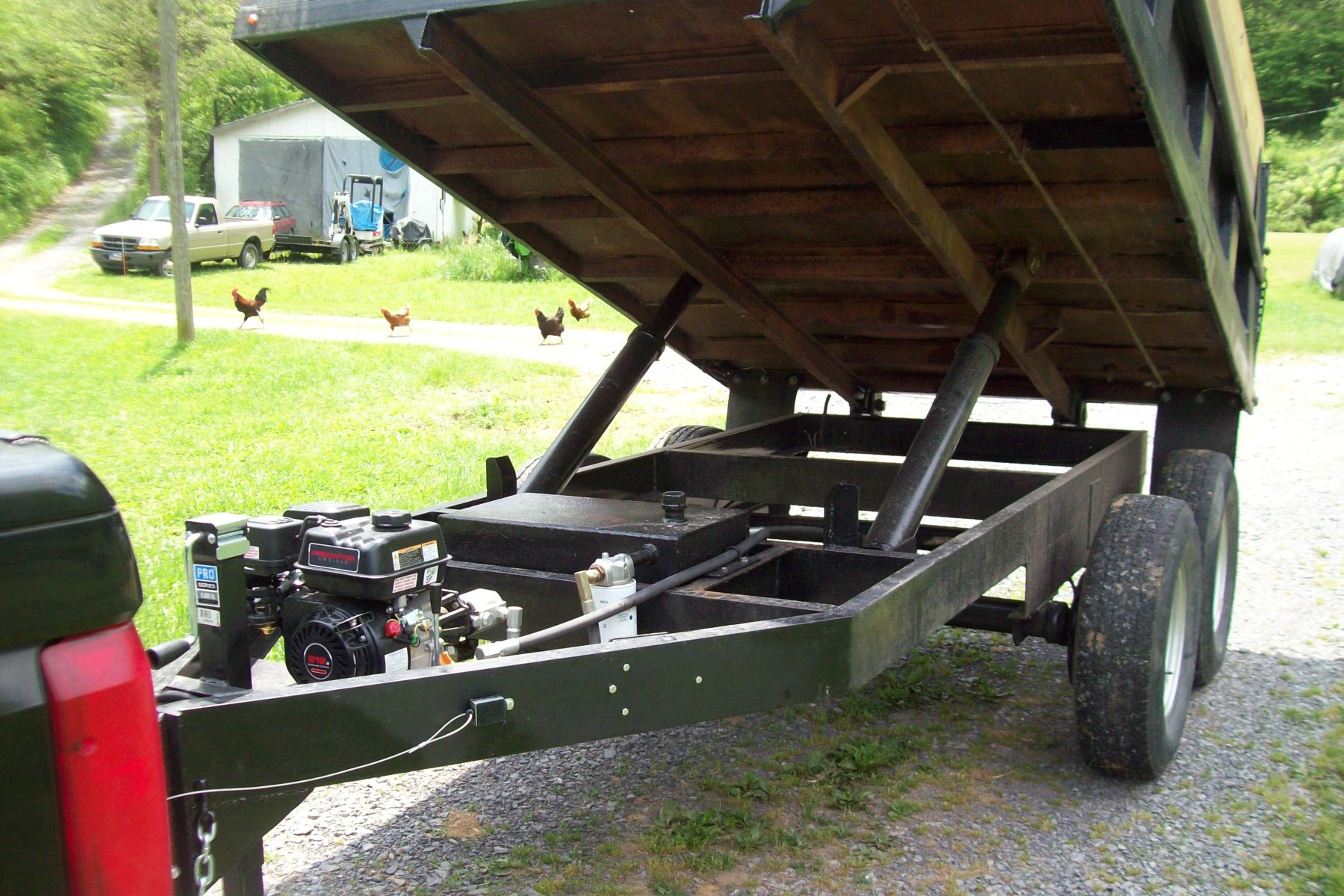

Hi Bill here’s pics of dump trailer, wasn’t sure where to put them so I put them here for future ref. if you build one.
Al, can I borrow it.
Very nice Al. Not sure how the hydraulics work. It seems the ram would almost be horizontal when the bed is down? The trailer I used had a scissor type lift.
The bed, and rams are off of a truck, that’s the way they were on the truck. I had a bigger goose neck dump flat trailer, and that’s the way dual cylinder set ups seem to be. Used engine set up so it can be pulled by farm tractor or others. I may T off the hydraulics to run a log splitter.
I really like the idea of having a small engine mounted in front. Very nice setup Al. Thanks for posting it here.
