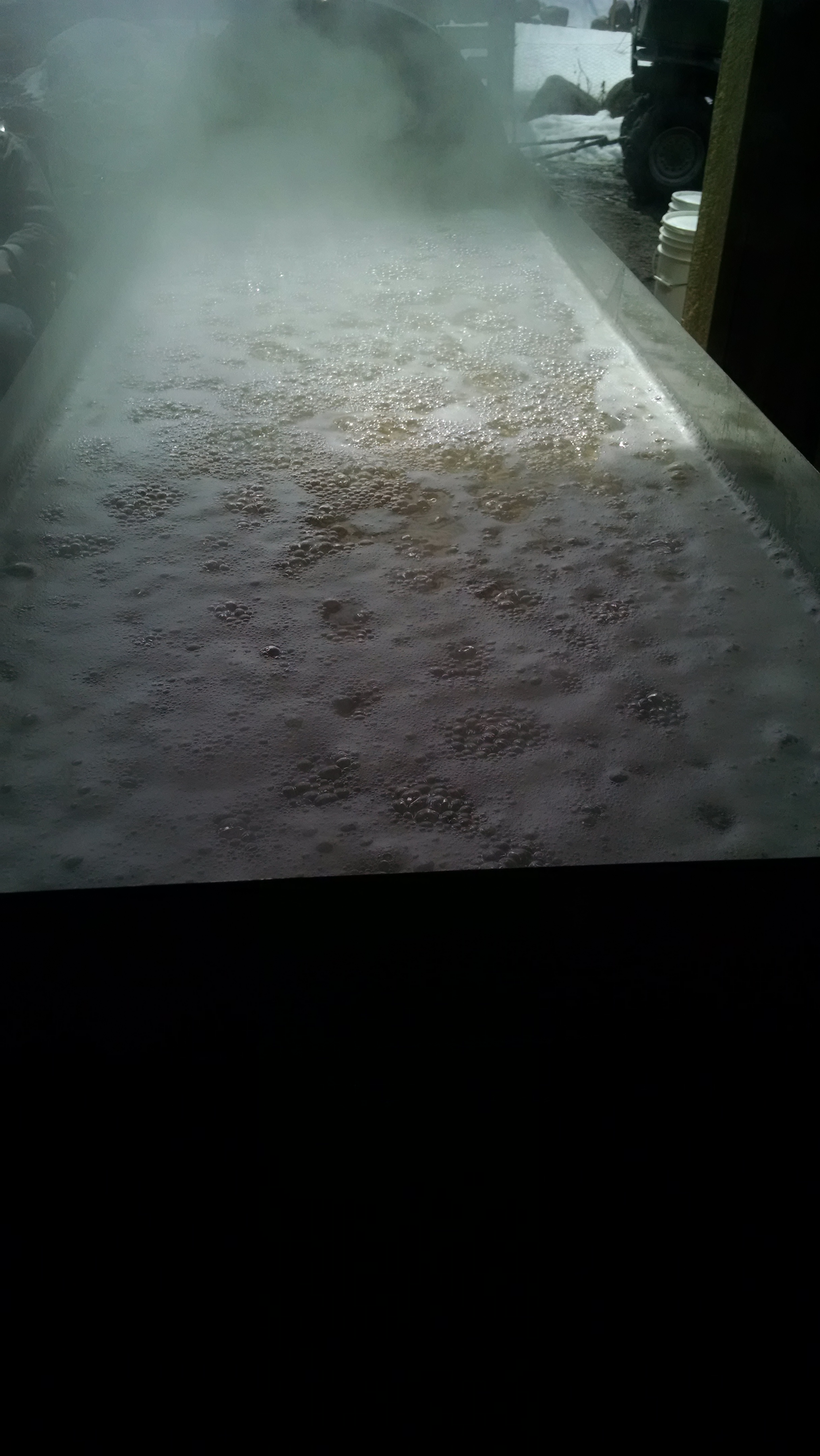

The new evaporator works great though!
Looks like your new evaperator is getting the job done.

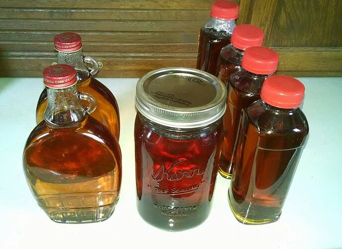

Here’s my first batch.
Second batch

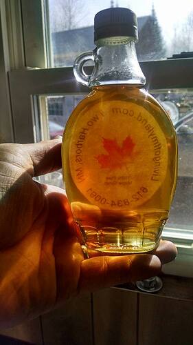

Clarity

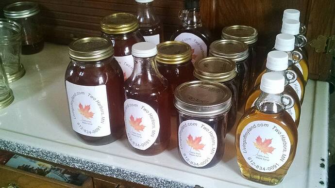

Hi Bill, you have them labeled for sale, but I didn’t see a link to buy on your website/facebook page. Are you selling those or just having fun with the labeling?
Hi Jay, yes I do sell them. My problem this year is our season hasn’t started and by the looks of the forecast, it might be over before it starts. I will let people know if I have enough to sell.
