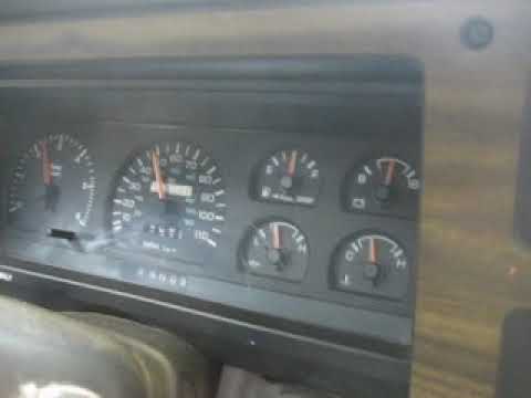

Wife and I went out visiting on this Sunday afternoon . On the way home I throttled up some to make sure the gasifier is breathing well.
Hmm, when I drive over 60 mph, my wife shouts, how do you behave, or maybe your car is more stable, because it can not be due to the driver?
