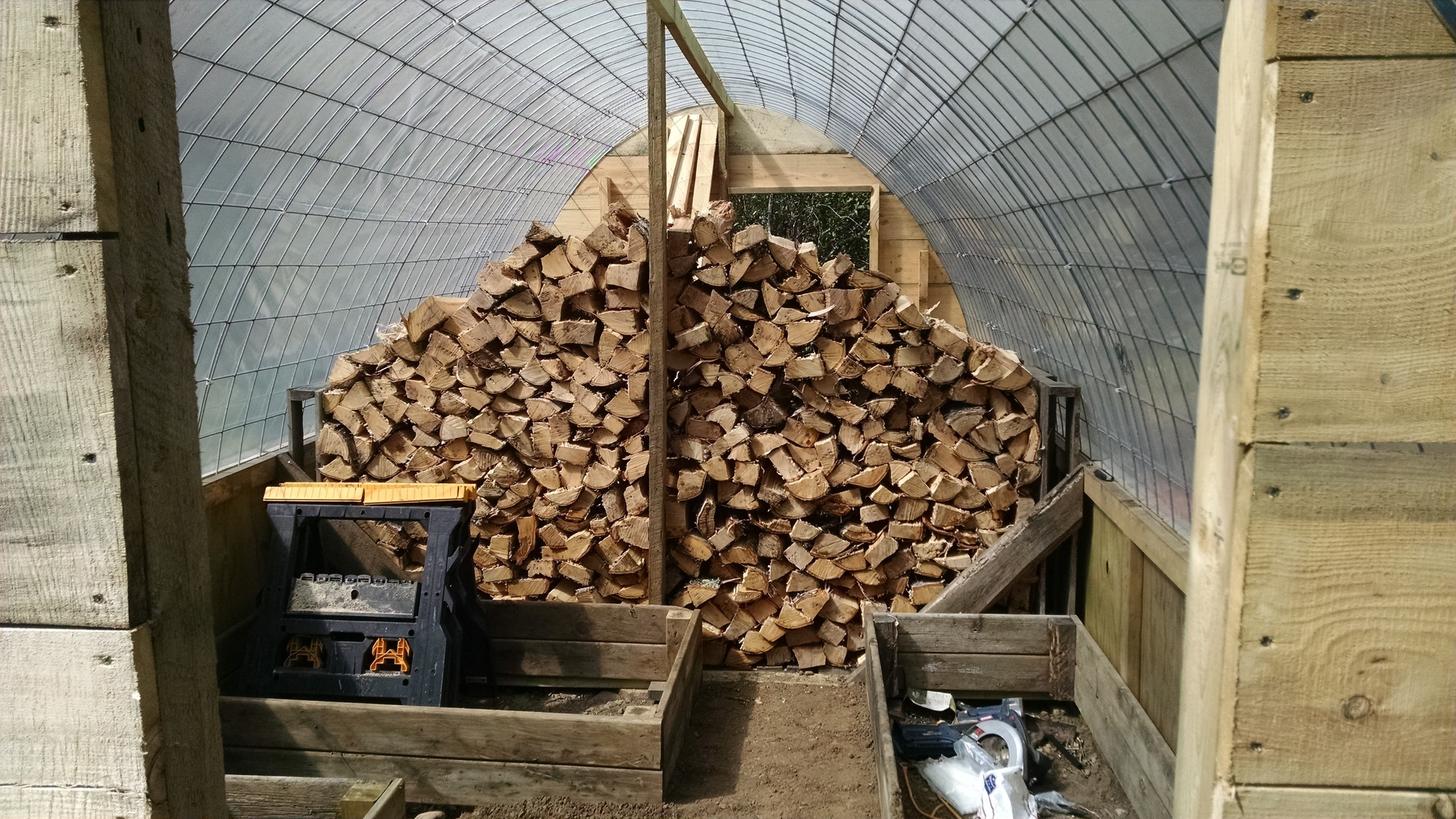

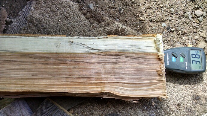

I filled up a row of firewood in here yesterday. The trees were felled, cut and split yesterday as well. I’m getting readings around 40% with the moisture meter. Today we are partly cloudy and I’m still maintaining moisture on the plastic inside the greenhouse. I want to test the wood every week to see the progress. I would imagine I would need to cut a chunk of a log to get accurate readings? I’m hoping to have decent results in 4-8 weeks.
Looks good Bill. I think a big fan would be a great help in times with excess power to remove the water from the structure.
I don’t have a fan. I hope to let this dry passively with the breeze flowing through. Then I was wondering because it’s been cool, 60-70 degrees, if I should leave the doors closed until the moisture builds up?
I would definitely keep the doors open. I think I would leave it outside in the sun for a week or so before putting it in providing not a lot of rain in the forecast. Air circulation is everything for drying wood.

First that is the nicest hoophouse I have seen that turned out really well.
You might want closable louvers at the top to let heat out. It would use convection currents to pull moist air out for the firewood, but you may need then in early spring for plants to keep it cool. We always had to crank open the windows in the greenhouse on warm sunny early spring days. They probably make them, but you could probably use an arduino type of gadget so you can set it and forget it.
I suppose it’s quite possible it gets too warm in there. There last 3 summers, it hasn’t been any warmer than 85F. Last summer I just used it for wood. I put a remote thermometer in it to monitor the temps. I left the doors open and everything was fine. It’ll be primarily for tomatoes and peppers. I may build another one just for my firewood.

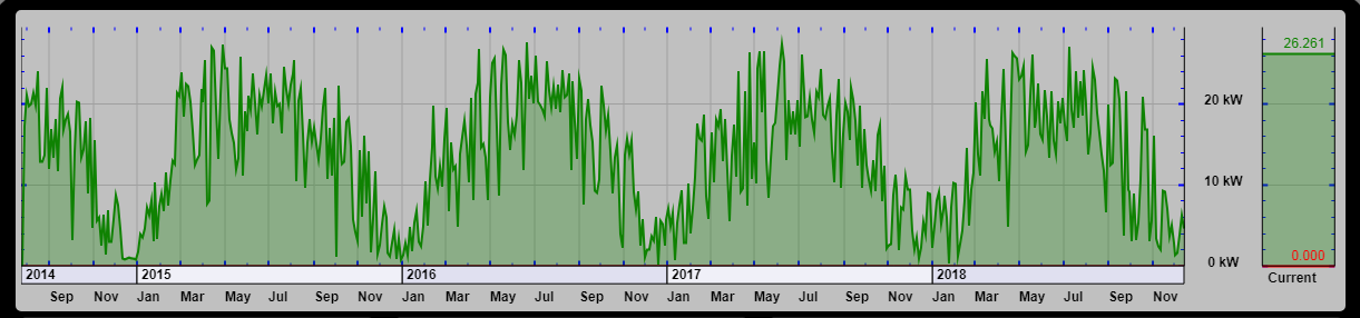

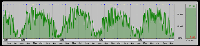

I know this is sorta getting of topic for woodgas, but since we ARE on the subject of drying things and keeping them warm, here’s a bit of input about using solar energy for such practices in west central Wisconsin. Back in 2014 our electric co-op put in its first solar photovoltaic farm. FWIW, we “bought” 500 watts of the farm and it produces about $7.00 per month to lower our electric bill.
Anyway, Here a graph of the output of the that farm for about the last 4 years. My point is that the “deep” winter months around here don’t produce much sun for drying anything.:
