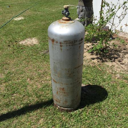

Thanks Gary! Thanks for the advice ( from everyone on this thread ) so a better choice would be a 100 lb or 125 lb propane tank something like this → http://ocala.craigslist.org/grd/5315392768.html ?
I would like 4 -6 hours burn time.
If you can find a “100 POUND” tank, that would probably be great. The tank in your link is a 125 GALLON tank though. Propane weighs 4.24 pounds per gallon, so that tank is a “530 POUND tank”.
I ran into this problem years ago with actual propane: “how did our fill up only be less than 20 gallons?!”
http://ocala.craigslist.org/for/5242868331.html
Ok this is probably more like what I need then.
"100 lb propane tank with no gas in it you will need a truck to pick it up call "
Hi Matt, the tank you linked to say 125 gallon butt I think he means 125 lbs. Unless my proportions are wrong that is a vehicle mount propane tank identical to the one I used for my tractor about 20-25 gallons. Heavy bugger and made for pressure and abuse. Nothing wrong with it its just overkill if you have to pay money for it. I like the water pressure tanks myself. The sides are thinner so its lighter and it has no resale value so its cheap. Can you buy metal scrap where you are? That is your best bet if you can find a scrap yard ask to walk around and buy something per pound of scrap instead of a higher price for something “good”. Again nothing wrong with your choice just its a lot of cash and I’m cheap! For consumption my 28 hp tractor burns about a gallon of gasoline an hour and consumes almost 10 gallons of softwood charcoal. If it is hardwood charcoal about 33% less so 6-7 gallons then it shuts down using up almost half the tank worth… So figure out how much gasoline you burn in an hour, figure out your volume for 12-14 lbs of charcoal (equivalent to one gallon of gas) multiply by 3 to be safe and that is the tank volume for one gallon of gasoline. All of this is back of the envelope math of course. Results may vary, consult your doctor etc etc

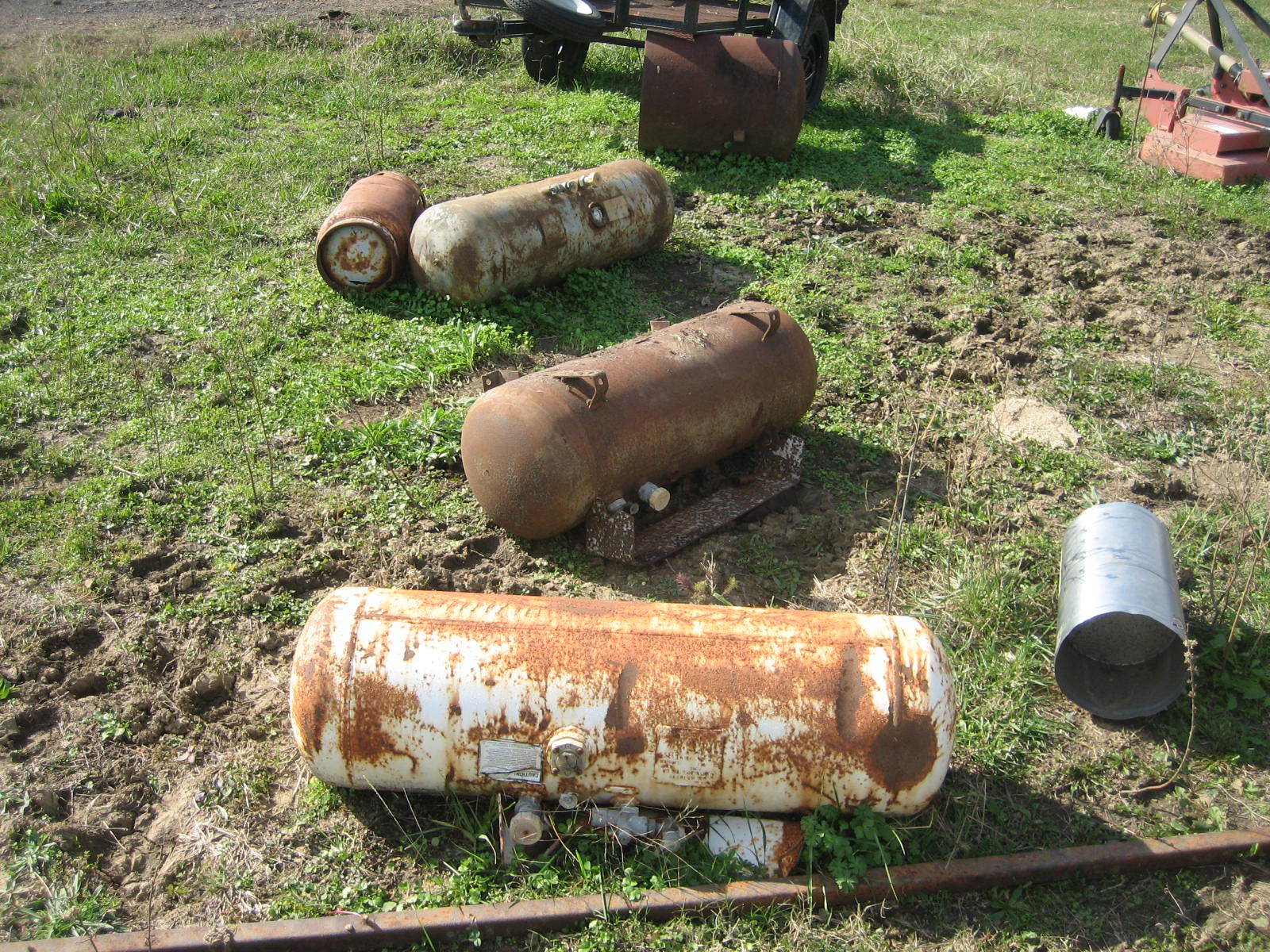

Hello Mart .
Here are some tanks I picked up at the scrap yard . 12 inch diameter and about 40 inches long . Thickness seems to be between 1/8 and 3/16 . I don’t remember what they cost but it was scrap price .

Now you’re talking!!! There is a thread on DOW about cutting propane tanks… I am a chicken so I empty the tank unscrew or drill out the tap and fill with water. There are many other ways.
That tank your thinking of buying for $40 looks like the same tank that I have and use for my engines , but I will agree with what the guys are saying its a little over the top for the price because right now scrap isn’t worth picking up as its now only AU$50 into the yard , do what David mentioned and look for a local scrap yard and find a cheaper / lighter tank , you never know you may even find something that’s even better suited , plus you may find pipe work and fittings there as well , so all you would need then is to make a hatch and weld up a outlet pipe and inlet pipe ready for your nozzle .

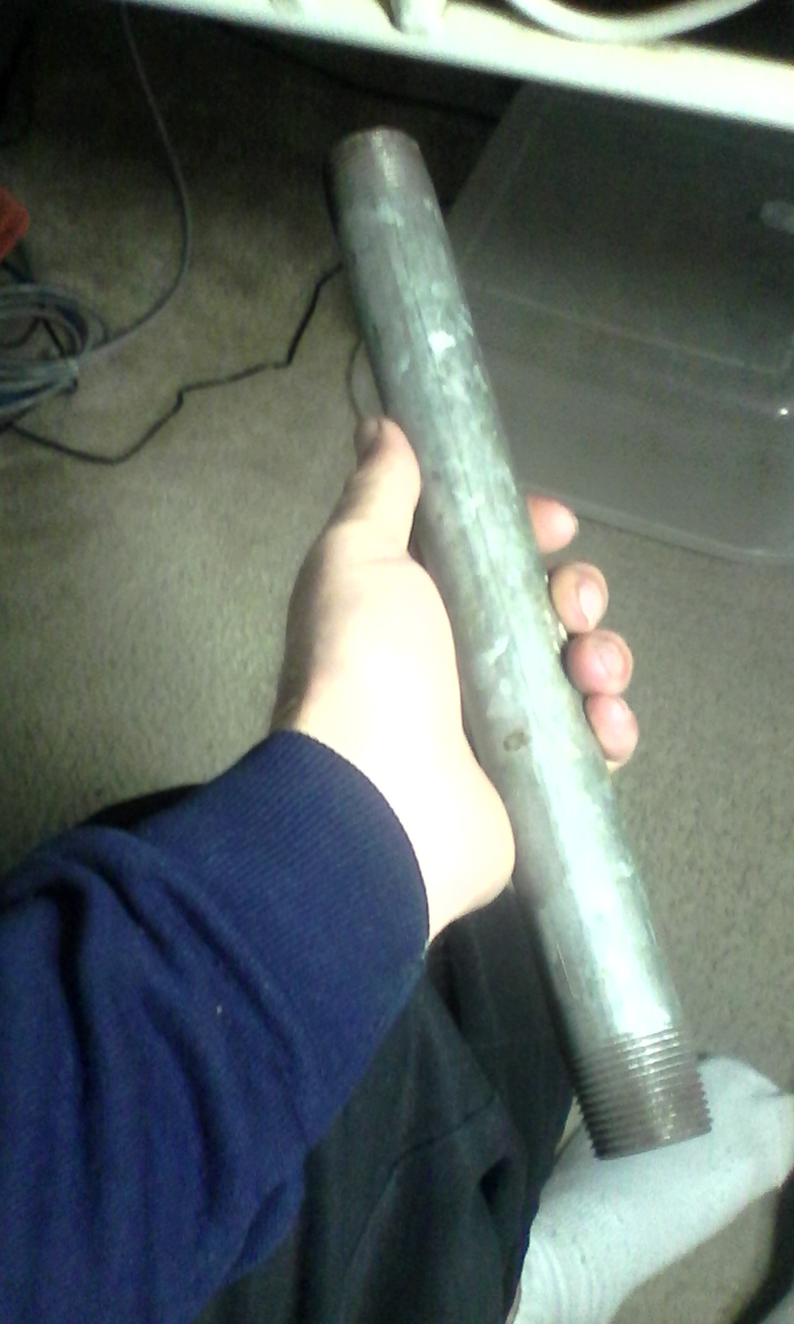

I am starting to pick up some of the parts. Looking at others videos I like how how they have the pipe unscrew on the inside with the nossle tip.
