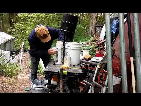

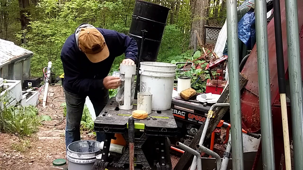

Actually I’ve been using dog hair for filter media for a while now, Cody. After I made this video last year I added saw dust to the bucket ala Matt;R’s suggestion. It’s all simple, cheap and works well. No soot comes through. I should have made a follow up video of it hooked to the gasifier I built it for. The more I build, the simpler they become just as Gary Gilmore suggested when I first started.
Thanks for the video on a simple bucket filter for a charcoal gasifier.
