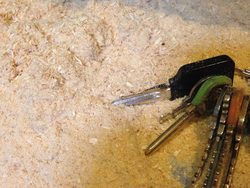

I will double check the hole size, but you can see it is pretty fine
It is about a 3’ diameter hog direct drive on a 900 rpm 150 hp motor. Car keys for comparrison.
Wow, thanks Carl - if that’s 3/13 diameter, then that 1/8" hole screen I have will be making a powder.

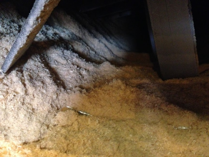

Don’t leave crap in the housings of your mill if you’re not planning on using it for the next 30 years
