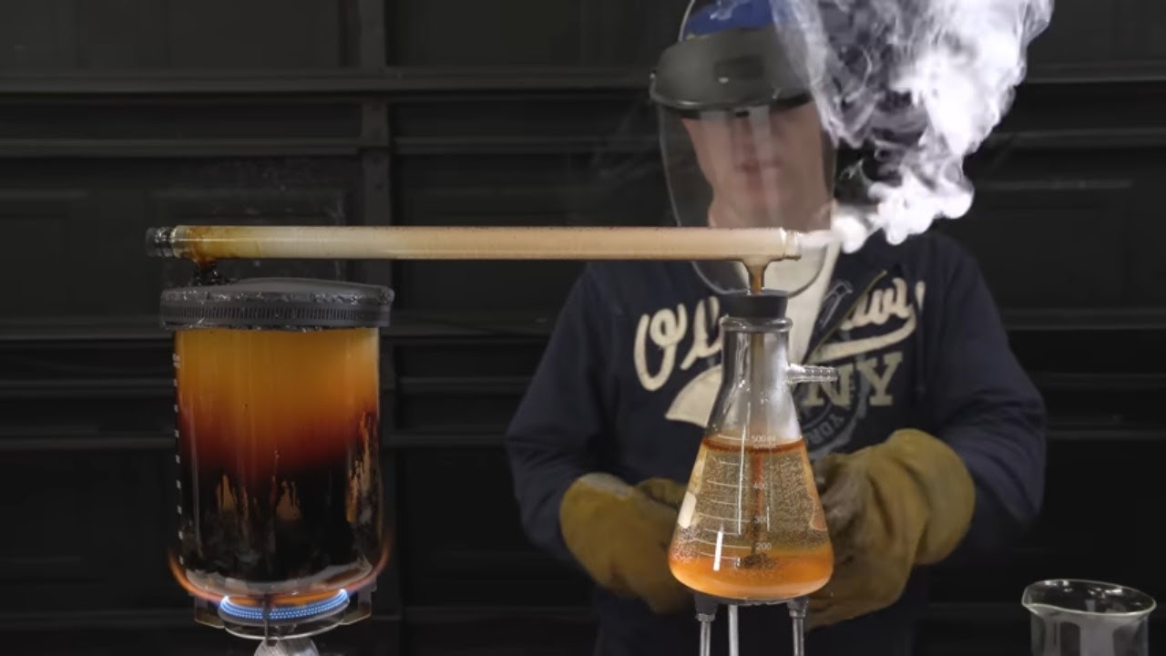

Planning on my first test just trying to see if I can get MDF to gas and going to set up a simple rig like this.
Anyone know what sort of temperature I would need to get it to to gas? Even what do you guys get your gasifiers to would be a good guide.
Thanks in advance.
Ian
Hello Ian
The video may not be a good example of a gasifier . It would lock up a motor on the first run .
The gasifier is an up draft design which is not good.
You should not see any smoke being produced and the cooler the gas the more btu.s it will have and should light off easier . The video mentions the wood was spent but it is now refined and ready to produce gas .
As far as the temperature of the gasifier the core should be at metal melting temps but built in such a way that those high temps never reach the metal.
Happy new year :blush:
What that is a closed retort charcoal maker. You should end up with charcoal in the first container. Ironically you can use a similar system for plastic to oil.
Wood is for charcoal gasifiers is usually on the hot side, like 700-1000C.
Make sure you don’t breathe the gas coming off. over 300C the UF breaks down and creates a bunch of radicals.

Lan, I agree with what Mr. Wayne wrote, this video only shows the pyrolysis process, where oily pyrolysis gas is released, which you cannot use in the engine, as it will quickly create a thick coating of tar in the pipeline and intake manifold. Wood consists of three elements (carbon, hydrogen and oxygen) in an ideal ratio, so that the energy of the exothermic reaction that takes place above during pyrolysis would be sufficient to convert the gases in the lower part, where the endothermic reaction takes place (splitting of water vapor and tar gases in glowing coal). Due to the heat losses of the gasifier, we have to additionally burn the wood, and thus excess water vapor is created, which is condensed above and separated from the process.
Since particle boards contain a lot of glue, conversion in this way is questionable, the “modern” and controlled method of gasifiers is based on electric plasma, where electricity is used to maintain a plasma layer with a temperature of over 4000°C, which is about 10% of the energy produced by the gas.

Thanks for all the info. Fully agree the vid I showed isn’t suitable, just wanted to do something simple to see if the MDF I have can gas before I go making a gasifier that can deal with all the tars etc.
I have a good idea of what temp I need to get to and I’m sure I can mock up something very simply just to test if something is actually achievable.
