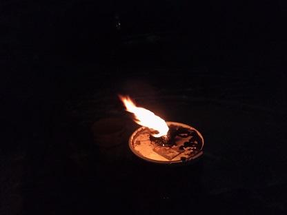

Ok built the first prototype gasifier for this system. its as stupid simple as it can get. So the idea is instead of having a complex gasifier and then catch bins you change in and out. Im just making the catch bin the gasifier. If it could be done this simple then it would be viable to make many of them and would be cheaper than building a more complex system.
So instead of changing out bins you simply have multiple gasifiers you exchange out and is as simple as un plugging the hose from one and plugging it into another with fresh fuel.
So I whipped this together today and my curiosity wont rest until I tried it. So this first run I layered in some charcoal and then wood chips on top. Fired it up and i got a nice flare for a while. But it faded out after 15 minutes. This is probably due to the charcoal burning out. However the chips are WET!! :slight_smile: Ive drying this fuel months under a tarp and it is wetter than it was when delivered it is about 50% mc. :frowning:
So Im just letting it vent for a while maybe four to six hours plus Im drying fuel using the kerosene heaters for the next batch. So far I am optimistic as the flare is flammable, it just wont sustain at the moment. Could work after the steam settles out as there is a lot of water in the gas steam. Surprisingly it is not spewing out tar mostly just water. I think it just needs dryer fuel and it will work. This could be a big game changer if it can supply gas for appliances while creating charcoal for engine fuel for power. This would make everything so simple and viable. If i can get chips to work next will be cutting up larger slat wood and see how well that works. Then its multi fuel system that can tolerate a range of feed stocks.

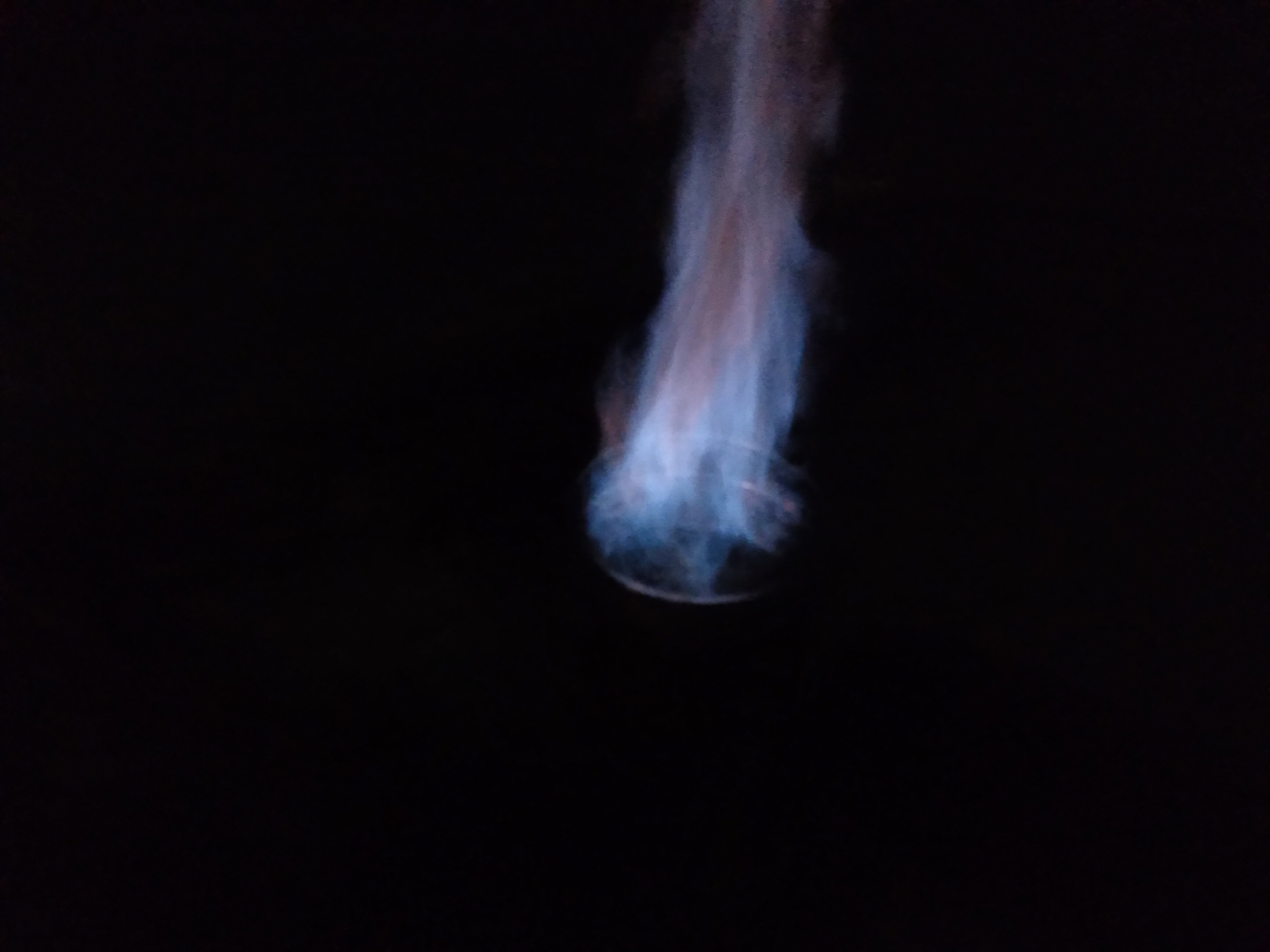

I managed to get a flare. I had to mod a coffee can and mount it to the flare tube. Still would go out after a bit but long enough to get some pics.
I capped it off for now and going to let it set for a few hours. I might pop the off to see whats left and refill it with the fuel I am drying and try again.
So is it a bottom lit up draft or an incredibly simple downdraft?
Bottom lit updraft. …
