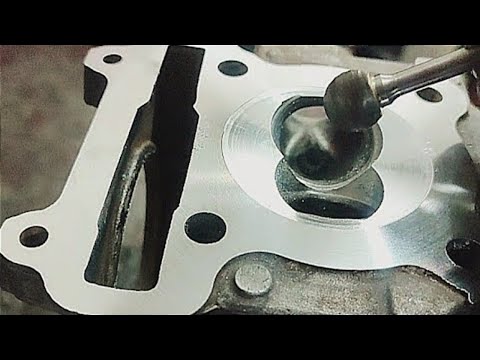

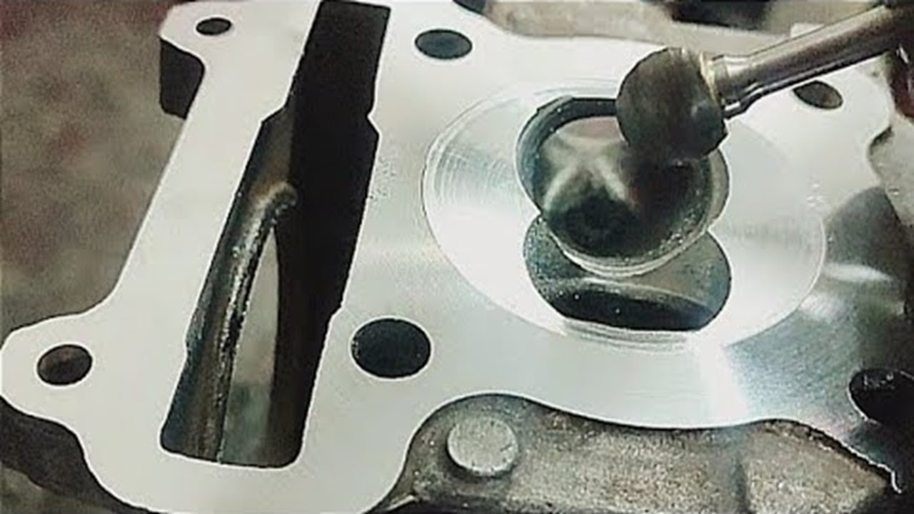

I’d thought bogus until I found a Project Farm video where he was comparing bands of for-aluminum soldering filler brands.
He ended taking one of the better ones; and then grind slicing open his cylinder head, and aluminum soldering filling it back up closed. Ran the engine.
Hot, hours, loaded might be a different story.
But maybe?
Any racers doing this?
