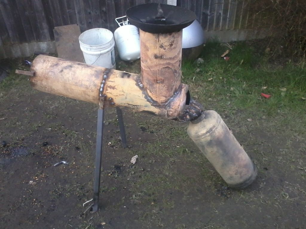

…well, controlled combustion and charcoal production in the Sort of Rockety Stove. It looks a bit weird, and sort of came together by good luck, rather than good judgement, but it’s stoked from the left with lengths of pallet scrap, the hot char falls into a sump, out of the way of primary air, and is harvested into the fire extinguisher on the right with a drawing rake. When it’s cooled, the char is light and crumbly- there seems to be a lot of fines, but maybe that’s just because a little fines goes a long way. To do… insulate the combustion zone, increase the time, temperature, and turbulence of the secondary combustion, and do something useful with the heat.

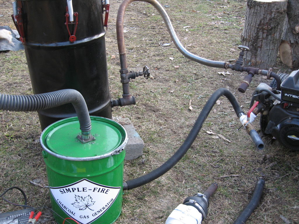

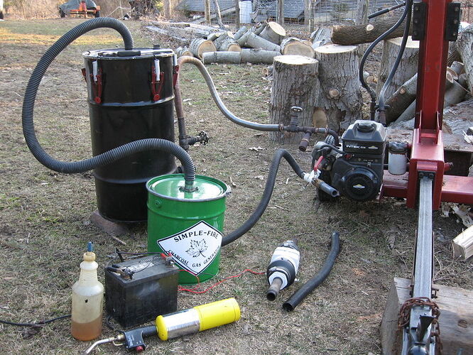

Easssssy Bryan, eassssy, We don’t want to attract too much negative attention. Winter has finally broken here in central PA and I have been making charcoal and getting my log splitter fired up. Here is a picture of my set up so you can compare it to what you are doing. The 6HP honda ran for over an hour and my gas outlet pipe only got warm. There is so much charcoal in the 16 gallon generator that it takes over an hour for enough of it to get used up to allow the heat through. Notice the exhaust gas return line and the ball valve to adjust the charcoal gas mixture to the engine air intake. I used a fan to get the fire going and purge all the air out of the generator and filter. (took about 4 minutes) Used a little squirt of gasolline to get the engine fired up then ran on charcoal gas for the next hour. The logs in the background came from a hybrid poplar I planted in 1983 and cut down this winter. I find it makes good generator fuel.

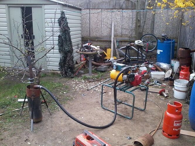

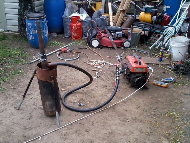

Yes, yes, YESSSSSSSSSSSSSSSS. Finally got an engine running on char gas today- the attached photo was taken a few minutes after I turned off the propane that I started it on. Better than sex, and cheaper, and safer, and lasts longer, and lives up to expectations better. And the key to success was… a different engine. The original candidate was a little Kawasaki suitcase generator, chosen for quiet operation, but the Honda GS160 started much more readily on propane, and weaned onto char gas with a few minutes tweaking and kinking of the supply tube… but alas, much more noisily. I got about a half hour run under a 500W load, spent mostly jumping up and down, running round, and shouting “Yeeeeee Harrrrrrrr” before the neighbour looked over the fence, and I happily restored peace and quiet. Sooooooo… what did I learn?
*The engine ran well initially, but spluttered and misfired later into the run before the pipes got remotely warm- my first suspicion is moisture, judging by the amount of condensate that poured out of the pipework- a condenser and trap would seem to be essential.
*I need to work out what’s different about the suitcase. Any ideas? Lighter flywheel? Less compression strokes per pull on the cord? Less volume for mixing in the inlet passages?
*It’s fly ash, rather than smoke from the charcoal production that’s more likely to upset the neighbours. Any ideas on the best way to trap it in the next evolution of the Sort of Rockety Stove?

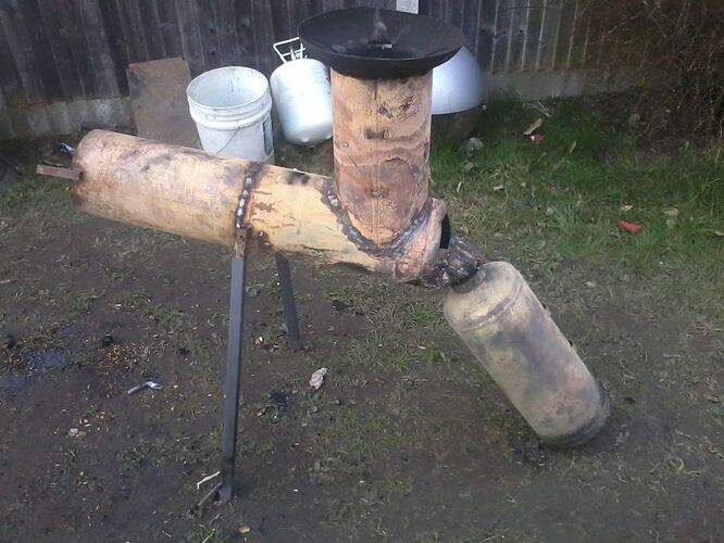

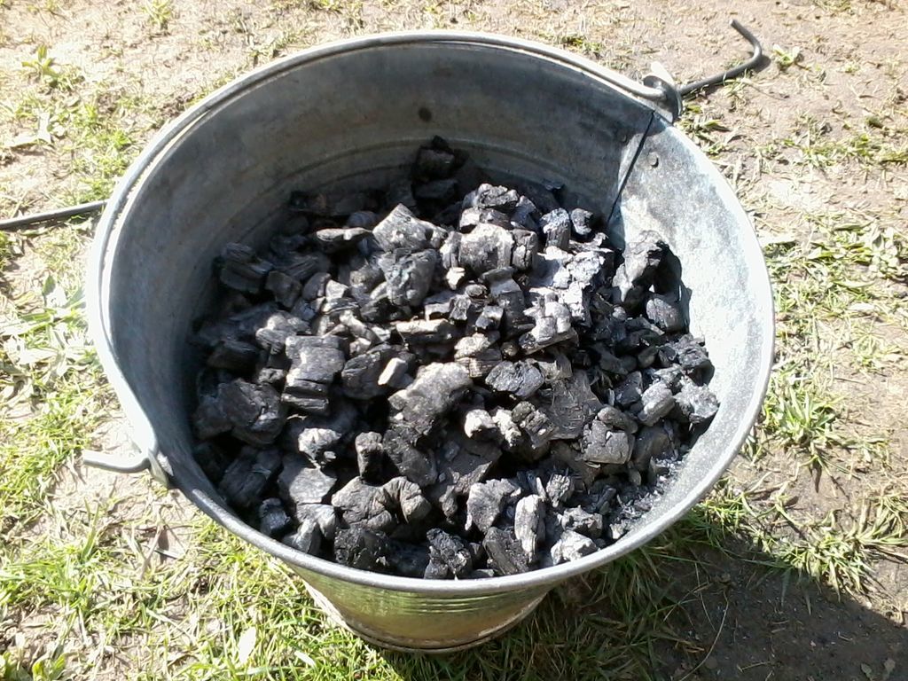

The stove is actually working quite well for a prototype- attached is a photo of a big bucket of char that used to be a pallet. It needs a higher flue with better turbulence and mixing, and a better charcoal harvesting chute, and I need to find an enthusiastic gardener who can put the charcoal fines into their compost… but I’ve just passed the first milestone on the journey.

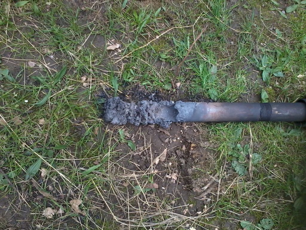

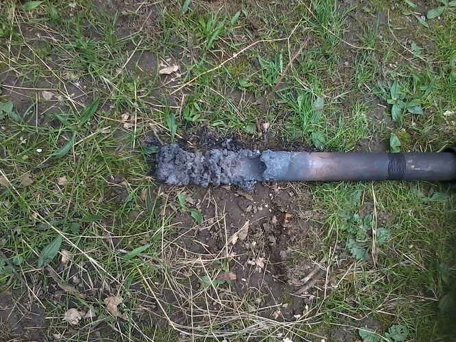

Finally got the Kawasaki suitcase running today- photos of the setup are attached, along with a photo of an extreme case of tuyere meltdown. It’s a lash-up, I know, with filters, exhaust recirculation, and a moisture trap still to come, but I’m learning the dance steps of getting the Kwacka engine started on propane, and weaning it over. Question- what to do with charcoal fines. I did have visions of gardeners scrambling for the fines to use as biochar, the reality was a lot of blank looks, soooooo… carbon negative would be nice, but I’d settle for carbon neutral. Has anyone had any success in trickling fines back into the combustion zone through the tuyere?
