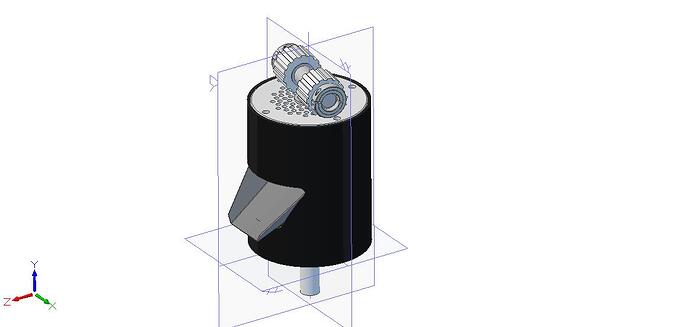

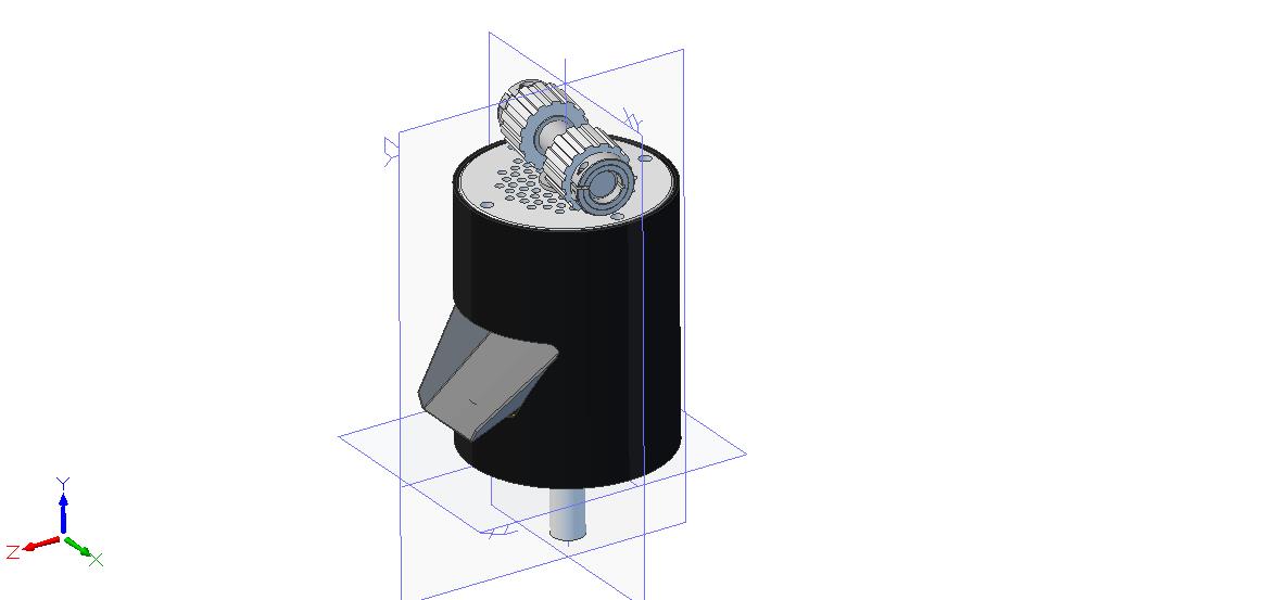

Thats why Im working on a pellet fuel processor. I never really understood why more have not attempted to build their own mills. They are pretty easy to make.
This will have grinder on top that you will grind up fire wood. I just started work on this today.

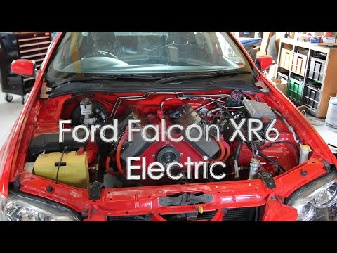

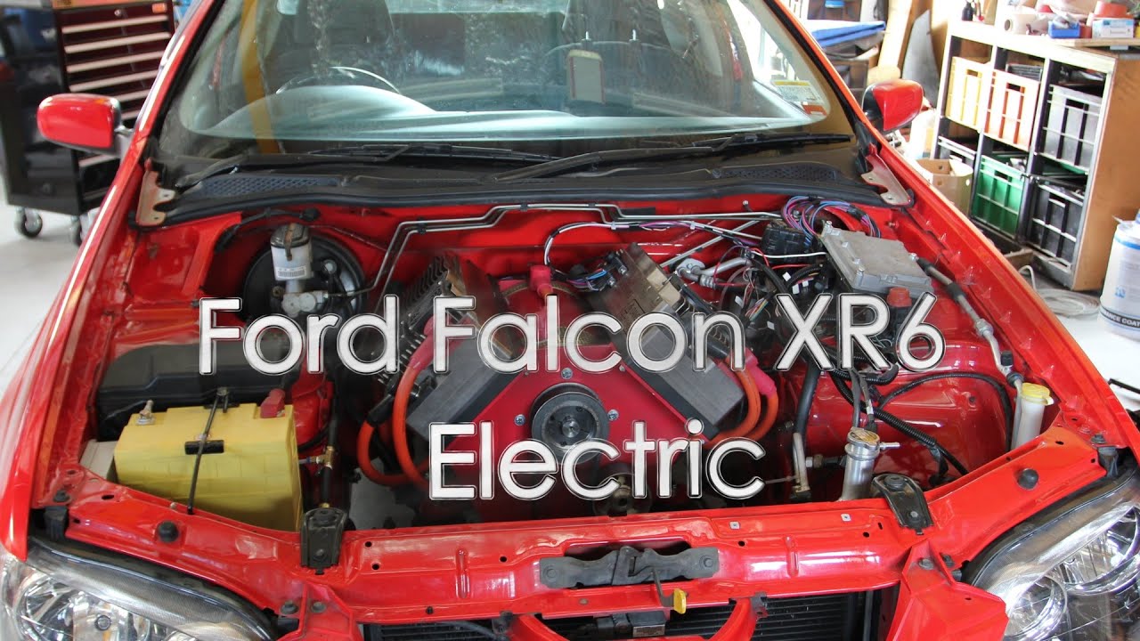

You caught me. I skipped a few posts. :slight_smile: I just saw them on your website, and they look -really- nice. I just haven’t had time to look at the details. I will check out the video in a bit.
Gerrard,
You might find this interesting. The only problem I saw is they were driving on the wrong side of the road.
