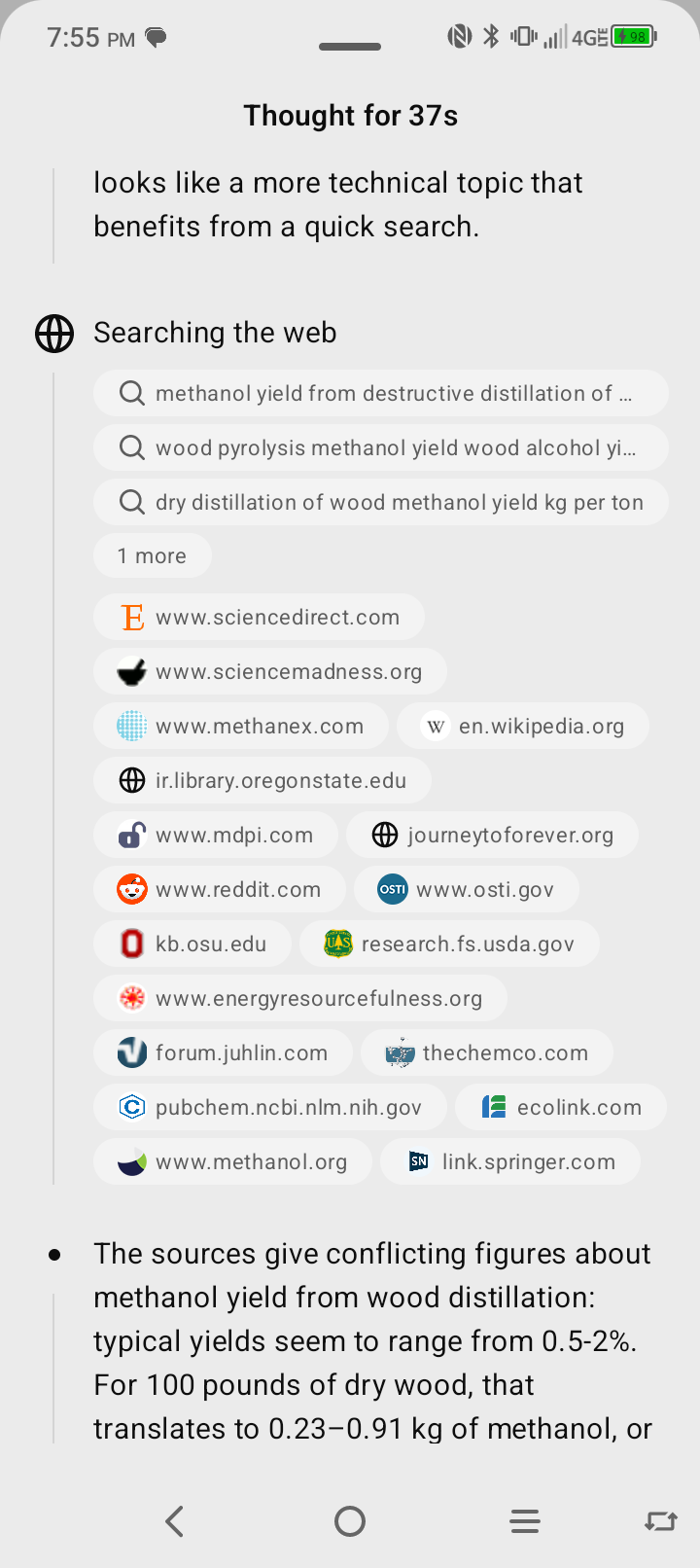

Lol, I would need 7200# of chips to make enough MeOH to make one batch of biodiesel. I get tuckered out making three yards of chips⦠Iād be pretty pooched out after making that many chips. They need to keep fracking!
You are better off making whiskey!
The amount of methanol in 5 gallons of mash varies significantly by source material, with fruit mashes producing much more methanol (around 5.5 ml per gallon) than grain mashes (about 0.38 ml per gallon). During distillation, this methanol is concentrated in the āheadsā or first runnings and can be separated by discarding the initial portions of the distillate.
If I did my math right that would be 18k gallons of grain whiskey. You might not ever be able to make biodiesel, but you would have happy neighbors. ![]()
