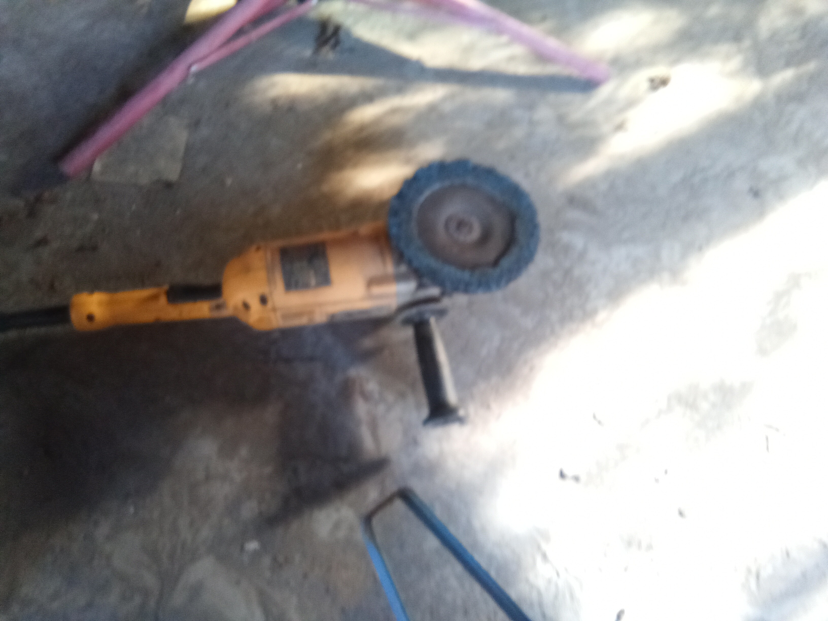

I had to leave the tank, we should be back next month to get it. It’s around 24in diameter or so, but it’s 26-28in from the top to bottom weld, so there’s about 2-4 in more than a normal 55gallon drum top to bottom plus the top and bottom caps of the tank. Hopefully it doesn’t rust too bad I got it mostly stripped.
