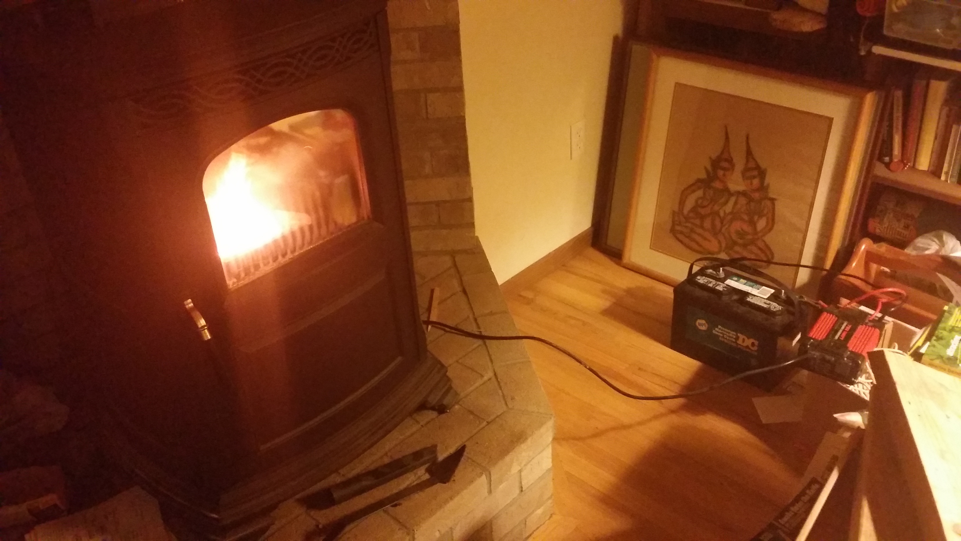

Well I have myself a battery, a store brand RV/deep-cycle from the local Napa. No battery refurbishment folks around here and the buyer (my mom) wanted a guarantee and a narrow price range, so that’s what I got.
The pellet stove is being run off my cheap inverter (confirmed as a straight 750W HF special) and new battery. Auto-ignition takes the most power (about 500W, vs 250W for stable running) and it handled it just fine.
Now I just need a decent charger method. Short term price range of 50-60$.
Don’t deep-cycle batteries like a fairly slow charge compared to automotive batteries? Wouldn’t that mean I could easily over-charge it by putting it in my truck and going for a drive?
Glad to see you have something going, but you may want to put the batt. in a plastic container for saftey. if it leaks will make a mess of that nice floor.

I’m not sure we’re on the same page here. Just about the only time I’d be using the battery/inverter was during power outages or out in the woods camping/shooting.
If I have grid power available for charging, I’d just use that for anything else I’d need power for.
As a result, my charger only needs to put out enough/proper power to charge/maintain the battery while sitting.
Oh sorry Brian, any battery maintainer then I suppose. I was thinking more a kind of UPS unit so there would be no downtime if the power went out.
No, it’s just going to sit on a shelf in the garage 99% of the time and get hauled inside/to my truck as needed. I will find a small tote that can fit it for protecting my floor though.
I guess part of my question was directed more at the full charging. I heard somewhere that for optimal battery lifespan, that something like the 0-80% “bulk charge” should be faster, 80-95% should be much slower (or maybe lower voltage), and 95%-storage should be a trickle.
Would a constant trickle from drained hurt the battery over a tiered smart charge?
I can honestly say I don’t know… I would probably have a trickle charger and a 4 amp charger myself. 3 or 4 times a year I would give it a full cycle 50% discharge then charge her back up. Rest of the time trickle charger on a certain schedule… lots of forums out there to read up on.
