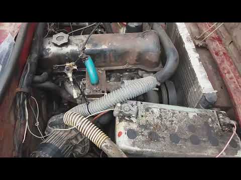

Hi Joni,
I ask here as your one sneak-peek picture of your current in-use version GJ - 10.0
You appear to have a same-same internal fuel capacity 8.0 thru 10.0
What please is your design internal capacity refilling in volume or travel time?
As you have read now most WK system users are ~80 miles travel; ~3.5 cubic feet; ~80 pounds.
Stationary I go for 2 hours loaded running time. Batch refilling.
Thank You
Hi Steve,
my 8.0 and 9.0 versions were designed to run about 35 kilometers, this is for travel to and from work, so as not to “shine in public”.
The bunker volume occupied approximately 2/3 of the entire gas generator.
In version 10.0, the outer dimensions of the system remained the same, but due to the change in the principle of air supply, the dimensions of the hopper increased slightly.
This was 3 months ago. Last video on his channel. Joni letting some freinds drive his car. And he can skrech the tires on taking off.
I think it is the 9.0 gasifier still operating on the car.
I believe he is on Version 10.
