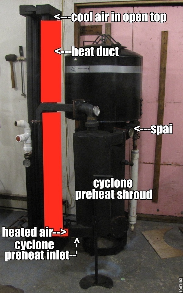

Thanks for posting the wood gasification boiler video. I picked up a couple more ideas for preheat. One I can semi try is pulling my inlet air through a shroud around my cooling tubes and in turn feeding that heated air into my present cyclone preheat arrangement.
My shroud would only surround the first 3 and hottest tubes. I’m sure I can reduce the size of my cooler as I can now hold my hand on the last 2 tubes as they are just warm during full operation. I know now that my firetube could be shorter, wasn’t sure about this when I started. Now to draw a preliminary design of a more compact unit. Fun! The single port air inlet (SPAI) feeds a circular manifold with 5 feeds to the nozzles.
Hey pepe, post some drawings and we could make some suggestion

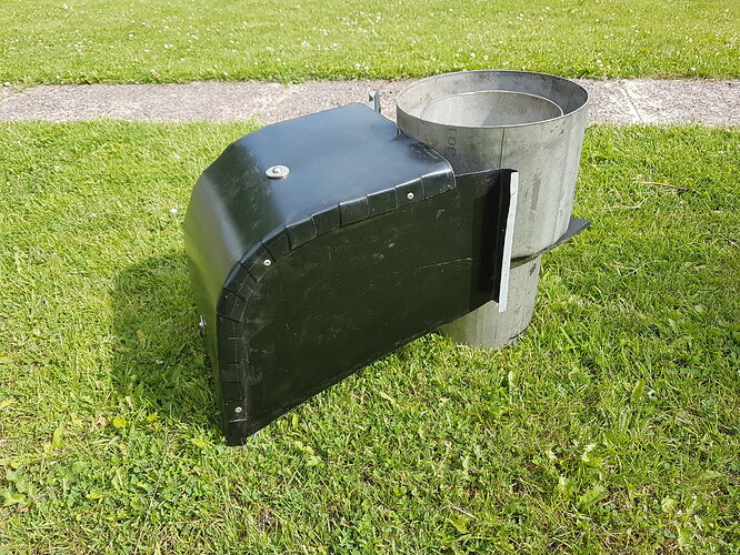

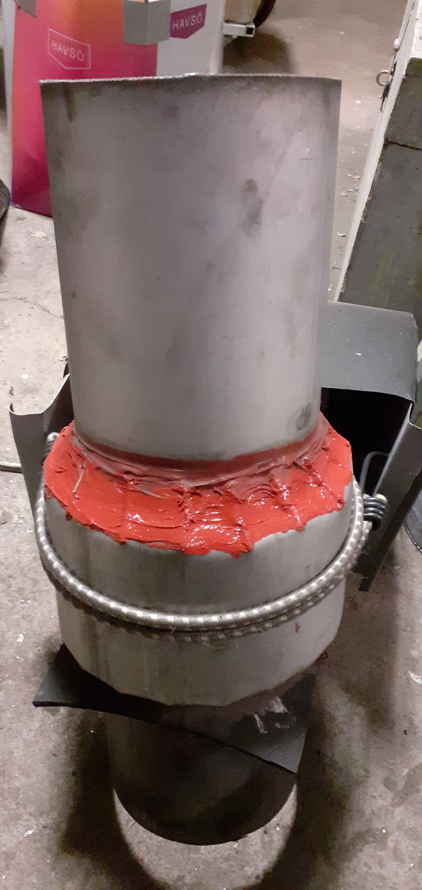

I highly recomend constant vacum mode. I always light up in downdraft mode.
Natural draft alone however has its downsides. Gloomy days or a cold chimney at lightup will often make you wish for better draft. Thats why I use a small squirrel fan on the chimney top. It’s fed by a motor dimmer from an old vacum cleaner. I can adjust to the vacum I choose.
If you want a maintenace free fan you can make your own ejector fan from two different size paint buckets. This way the fan always breathes only clean air and natural draft is still there with no restriction.
A couple years back a DOW member told me that if you’re not handsome enough you can always brag about how cheap you are to get approval from the ladies.
Today I used some leftovers from gasifier builds to fabricate an ejector blower. Also to protect the motor I used flat roof tin which were leftovers from the rebak guards, which in turn were leftovers from when I built my porch roof 25 years ago.
Told my wife but I couldn’t tell if she was impressed or not :thinking:

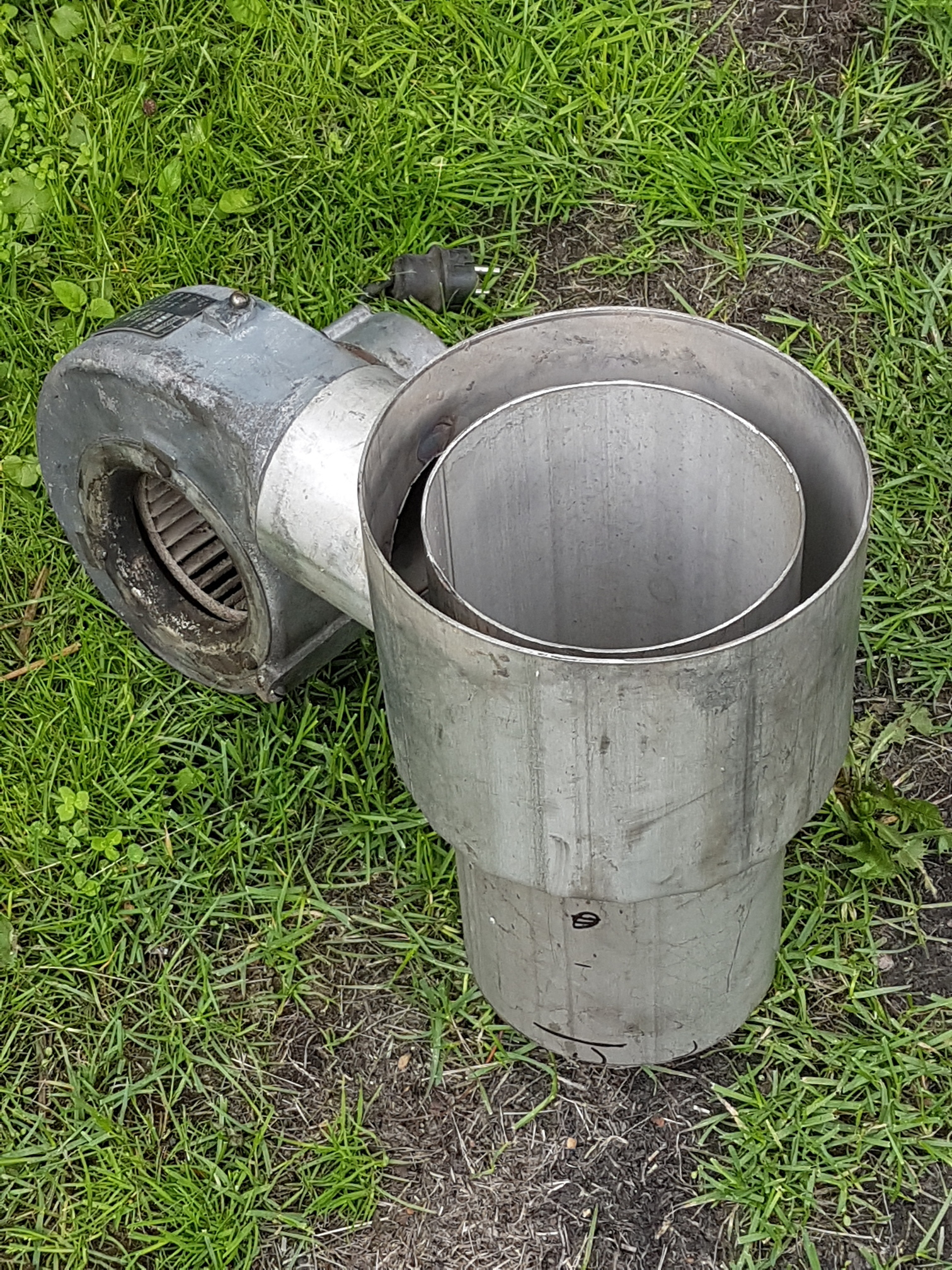

Hi Jo
I built an ejector a bit like yours. I am a little disappointed with its effectiveness. I can not create a vacuum sufficient to cause a torch in the combustion chamber of my boiler downdraft gasification . :sob:
the vacuum seems to be too weak whatever the setting I make.
the chimney is 6 “in diameter and the ejector 8”. the fan is a 120-volt 12 ampere leaf-blower
Can I make a mistake somewhere?
I’m heating a greenhouse like Kristijan’s. the chimney is 20 feet horizontal vertical well 12 feet . can this produce too much restriction for an ejector fan? :thinking:
Thierry

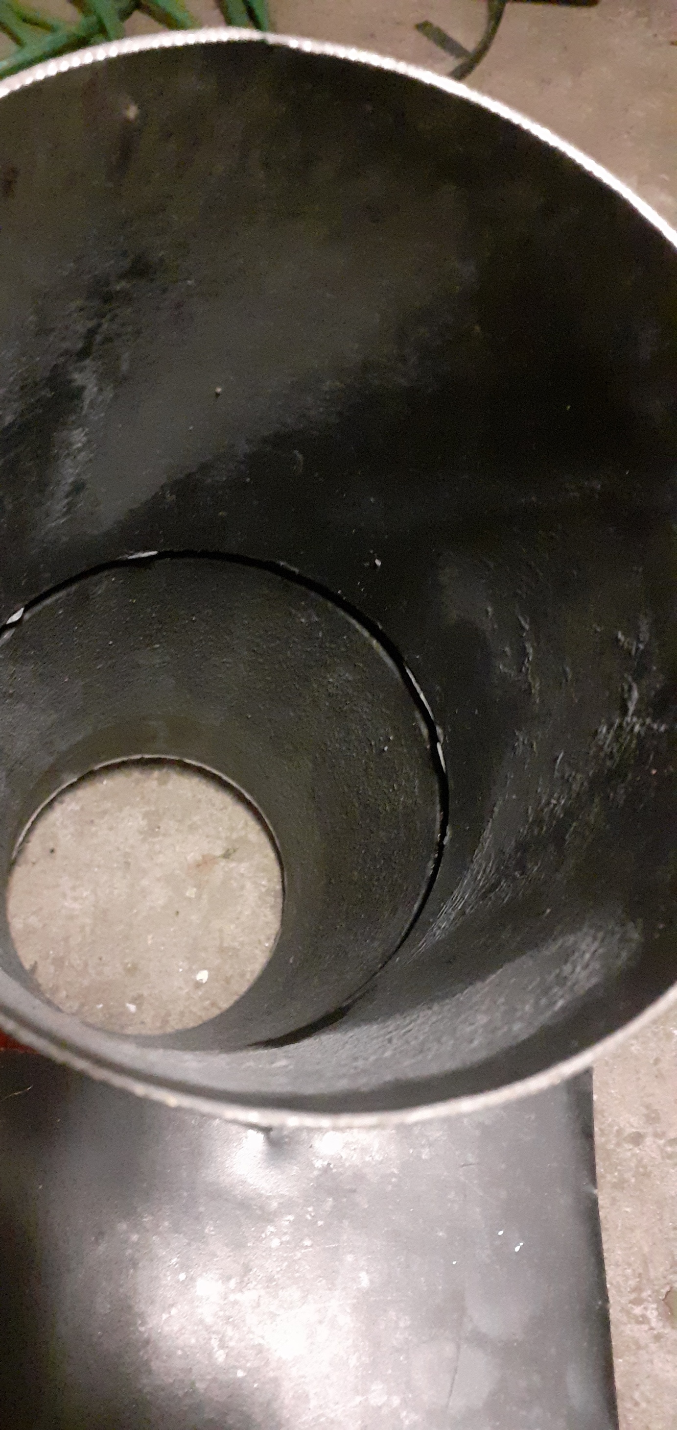

Hi Thierry

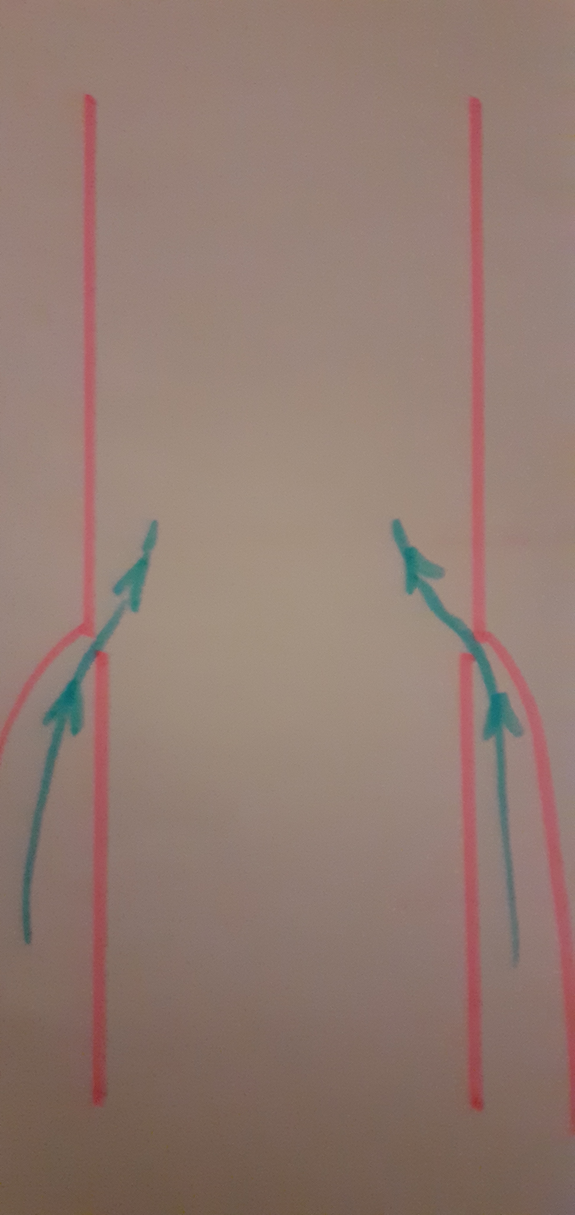

I was unsatisfied with my ejector fan as well. I had to make some changes to it.
I narrowed down the air inlet slot by bending in tabs of the housing to increase the air velosity. Also, I added some hight to the tube.
My thinking was the increased air velosity would make for better draft by creating a more powerful underpressure. It worked so-so. I used the fan last winter like that and it pulled about twice the natural draft.

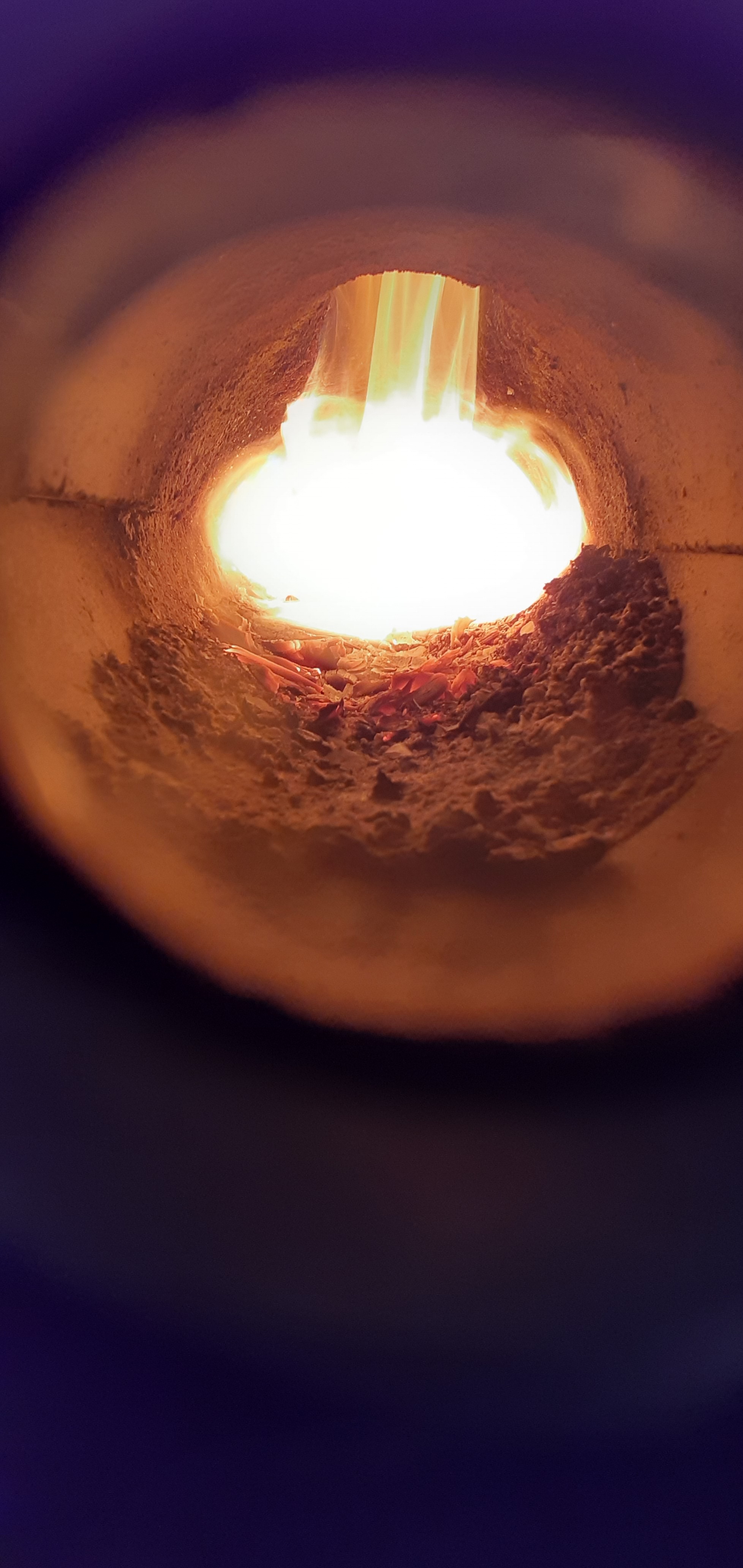

I decided to put some new silicone on the tab cracks this fall for no reason at all. The motor fried at first lightup. Well well, it’s been in use on top of the chimney for 10 years. I have a couple of more old fans somewhere, but for now I’m running natural draft only. Lightup is a bit slower but otherwise ok. This is two minutes after today’s lightup.
thanks for the answer Jo.
I understand that we must experiment different design inspired by the venturi effect , to build something that suits us . :wink:
I would really like to have such a good result.
but watt for watt a fan is probably more efficient than an ejector
