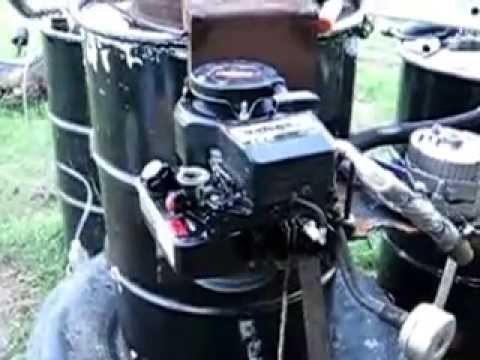

It’s all good. For inspiration look up DOW memeber here Tim Johnson member page Bio.
There he has a posted up YouTube of his home brewed system. 11 hp rated Honda spinning a 60 amp car alternator into hand series and parallel connected 4 to 6 set of 12 volt batteries.

Brian back onto topic here are some of my in-use aquired/bought overhead valve engines so you can see what to look for.
You will find that GaryG and I generally only put up what we actually are, and have been using as personally commited proofs of concepts. Brothers in Life Philosophies.
