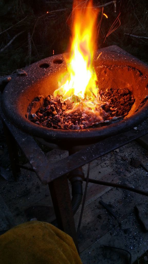

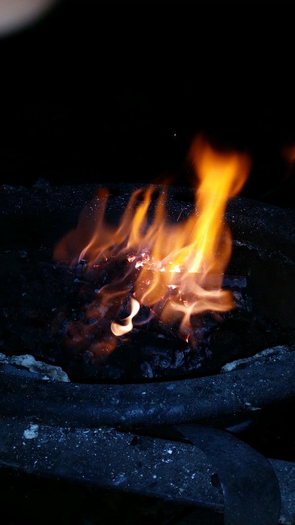

Forgery! It didn’t work out very well for things longer than 6 inches because of where the drain hole/air nozzle is placed in the bowl of the sink. I have another forge design that I’m going to try that provides more consistent heat to whole pieces of longer stock. My camera didn’t want to pick up the deep pink and purple flames I was getting at one point.

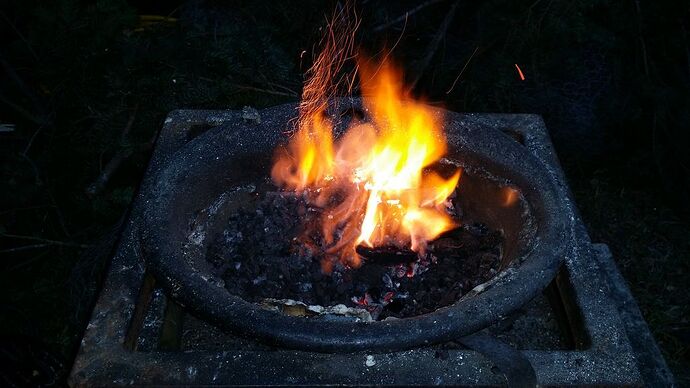

I had far better results using chunked wood instead of kindling sticks. First I spent about a solid hour splitting mixed Fir/Alder firewood down to roughly 2"x2" square logs and another hour cross cutting them into 2" cubes on my tablesaw.
As I’d mentioned to a blacksmith friend, my sink-forge previously wanted to make a pear-shaped zone of forging heat about 3" across by up to 5" deep, if I have enough charbed, but the zone is wedged against the back wall where it is hard to get access to with longer stock. If I constantly stirred and turned the charbed, I could make that heat zone about twice as wide but not as hot, only “Apple Red”=1,300F=700C, instead of an orangy=1,700F=925C.
Using chunked wood, I can get a “mushroom” shaped zone about 6" wide by 6" deep zone of easy high-oranges=2,000F=1090C and a core of yellows=2,300F=1,260C.

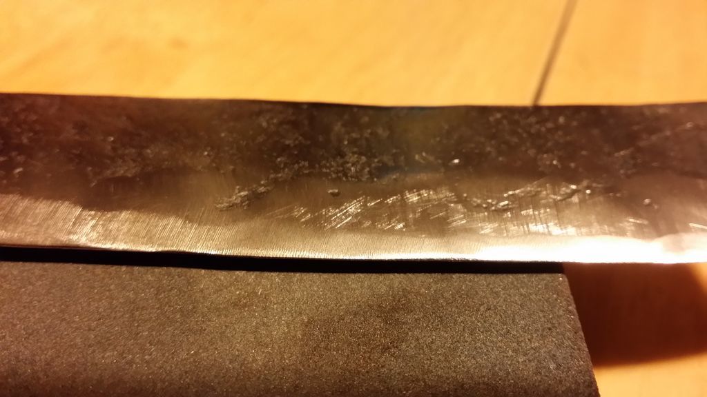

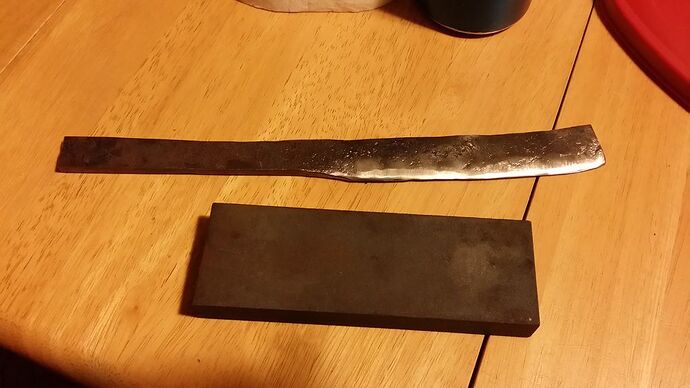

I smithed 1.5 Froes/bush knives out of some of my spring steel today. First 3 pictures are just angle grinder sharpened (sanding flap disc) and the final shaping. The last picture (on paper towel) is after my hand/stone sharpening though it could use more. This is really hard steel so it will be interesting to see how long it holds the edge.

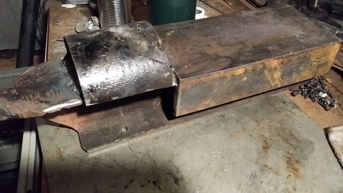

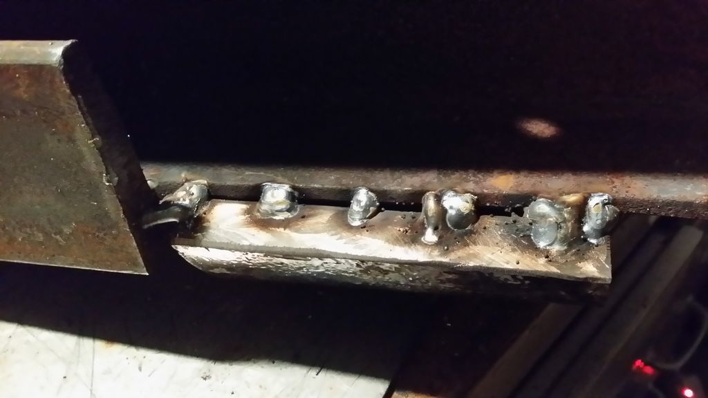

I bulked up my smithing anvil so I can work heavier stock easier. I also added a more evenly rounded horn face for making smooth curves. I think my total mass of the anvil is around 40 lbs now. It also sort of looks like a starship or something… Flat workface is a 12"L x 5"IW (6"Upper width) x 3" T U-channel upside down and welded to the I-Beam. The rounded workface is 1/3 of 4" long piece of 4"ID x 7/8" thick pipe.

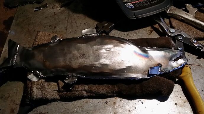

I made a metal salmon for my dad out of a barrel top. He went to college for Fisheries. Yes, he has a Master’s Degree in salmon. A field just flooded with jobs. 9_9

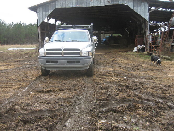

Not a lot to report , the 94 Ram is running good. I have been averaging about 50 miles a day with a lot of the miles in the mud.
