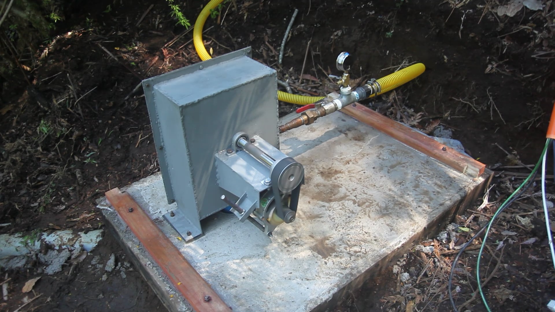

My water turbine is nearing completion. The wheel has been built from the aluminum spoons I cast:
I built a housing for the wheel and installed it on a new concrete pad. I ran the turbine for a while to test it out. Because it was unloaded, it ran twice as fast as it will under load but worked fine. That concludes the mechanical part of the project aside from a shelter over the turbine.
An electric line has been buried to the turbine site and the next step will be to add a battery and inverter.

The turbine looks great! I wonder if an MPPT circuit would adjust to the pelton wheel and run it at the optimum speed (unloaded/2).

You know Kent, I was wondering about that too. I designed the pulley diameters to make the alternator spin at the correct rpm at full load. Off load is where issues arise. Unlike a solar panel where you can just disconnect it from batteries or load, the turbine needs to send the energy in the water somewhere or it will spin faster. I think I will need a dump load and a controller that switches that in when the batteries are fully charged and there is no call for power. On the other side of full load, if there is a call for more power than the turbine can supply, a MPPT may help by keeping the turbine near ideal speed. I’m just not knowledgeable enough in electrical engineering to know if that would be the case.
