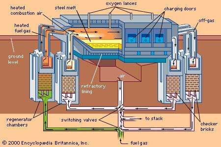

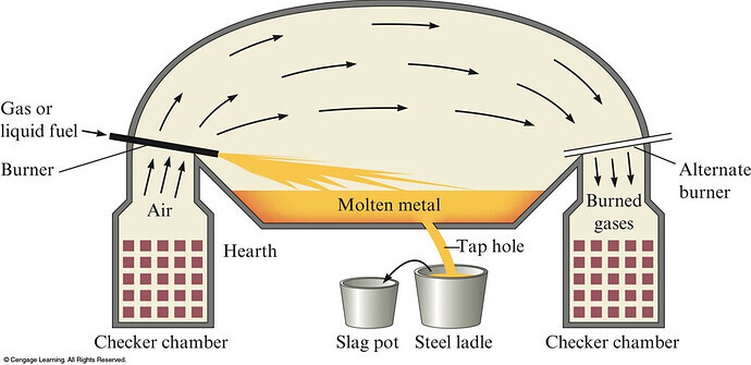

Years ago we heated out reverb furnaces cold air with checkers and alternated back and forth to recover as much heat as possible to reduce the amount of coke we needed to melt.
Maybe a smart fellow could design a reverb kiln that uses stone or fire brick checkers to preheat the air and mix it with off gases from the carbonizing process to improve the fuel efficiency and reduce the residence time needed to fully char the wood in a single batch.
Ignore the metal pot and oxygen lances…
Just look at the checkers and the heat flow/recovery.
Wallace,
These ‘checkers/regenerators’ seem to be filling the same purpose as Robert Stirling’s “economizer”. Is that what is going on here?
Yes I guess that’s simpler. We called them checkers in the steel mill because they looked like a brick checker board from the top, the idea is the same however heat recovery.
The less wood you burn for process heat the more charcoal you have left at the end

It is an interesting concept. I don’t know if it works so much with charcoal. It is an exothermic process, and it releases a lot of burnable gases that can be used to fuel the reaction once it gets going. On top of the burnable gases, there is also like water, alcohols and tars. Look at making wood vinegar, and see all the crap that comes off. Even if you just use the burnable gases, you have plenty of heat if not an excess to run the reaction and you probably have enough extra to warm up the next barrel anyway.. And some of the gases are like methane, you probably shouldn’t release into the air and should just burn them off.
I am not sure how helpful it would be. It MIGHT be very helpful to dry out the next batch. But you need to use a heat exchanger, that is kind of like a water jacket. You collect the heat in like a 2" pipe and use 4" furnace ducting, the air runs in the opposite directions, andmaybe a small fan to pull air through to dry out the next batch. But you have to be careful of where the condensates go.
It does seem like a waste of heat. I 100% agree. Matts design is using the excess to heat a room, which seems a lot less wasteful.
Charcoal retorts are sometimes daisy chained or alternated back and forth using the excess heat from one retort to start the reaction in the other.
Most of the ones I have seen actually use the gas to light a fire under the next one in a closed retort system because there is an excess of burnable gas produced with the charring process. I have seen large scale ones do some heat recovery especially if it is especially true if it is coupled with electric generation.
That’s very much how a coke battery works.

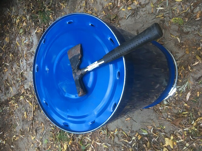

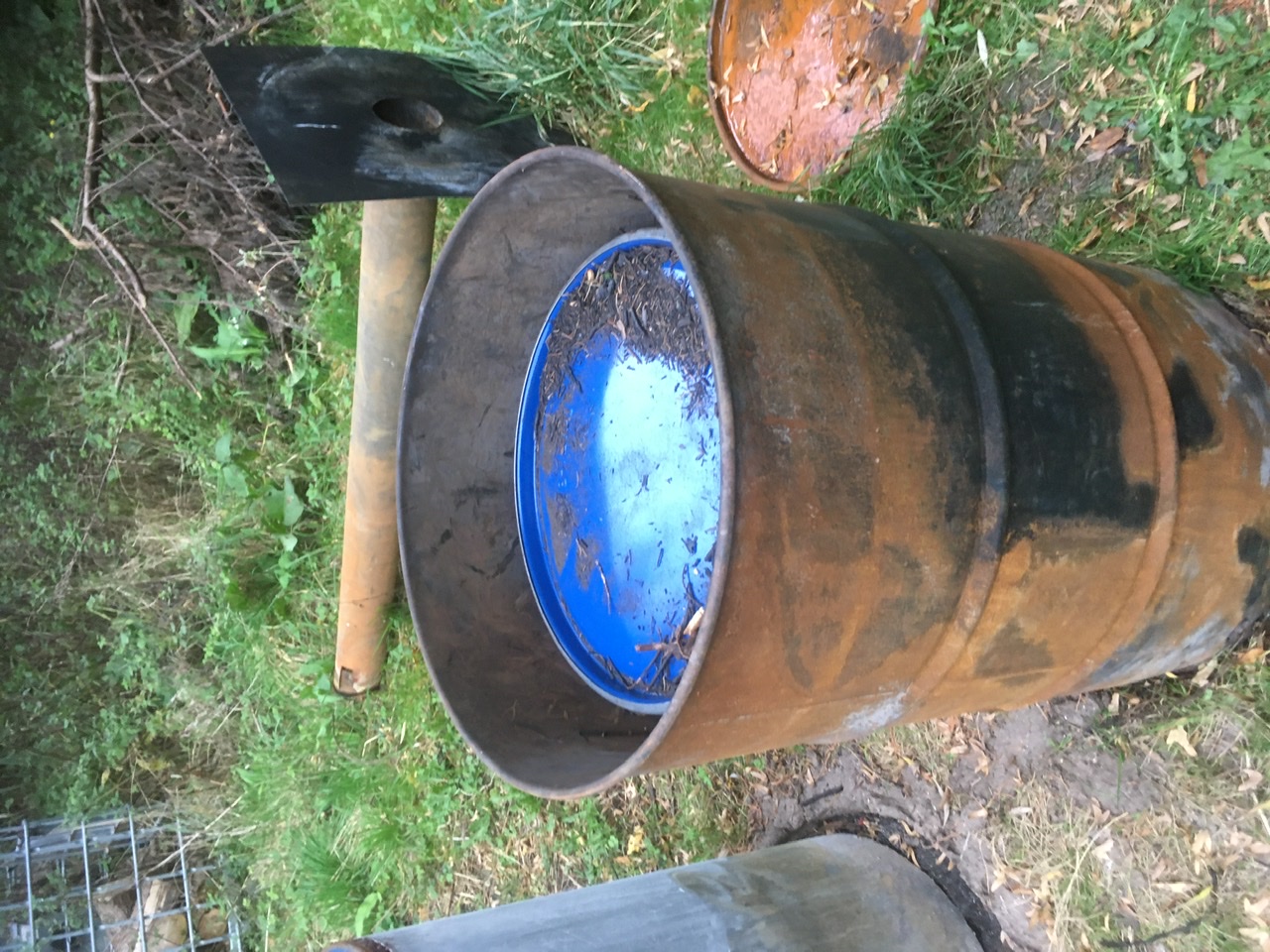

Inner barrel 40 gallon
In the TLUD
Enough worked this week, a little time for playing. Inner barrel has holes in the bottom. Space around inner barrel is filled with woodcrap. Lighting was easy today. Maybe the wood is dry. No rain for a week and it is just about to start. If I wanted to try this, tonight is the night.
I had to play with secundairy air for no smoke. Interesting.
Outer pipe is 700 mm and for insulation and air preheat. Still getting very hot, auw.
