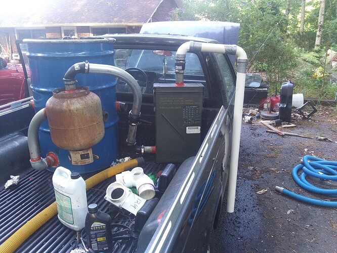

What does your unit look like, do you have it in the oil drum?
Can you draw a sketch of what it looks like?

Changed the nozzle angle to roughly 60 degrees downwards. They are pointing so that they will not blast directly under the opposite flute. I’m thinking that’s what made them heat up so bad last time when I had them at a 45 degree downward angle. Maybe with the more direct downward direction the gas will react more strongly. I also checked for any places it could possibly leak and smeared ultra red on there as well. I will test it once again on the Mazda since I actually got it to make that engine run at all.
I might try to make the filtered gas exit out of two 2" PVC pipes to make more suction, not sure if that will be beneficial since the rest of the line is 2" ID before that. My line of thinking is it will just make two lines of weaker gas.
I was thinking of just making the two lines come out of a Tee from the filter box.

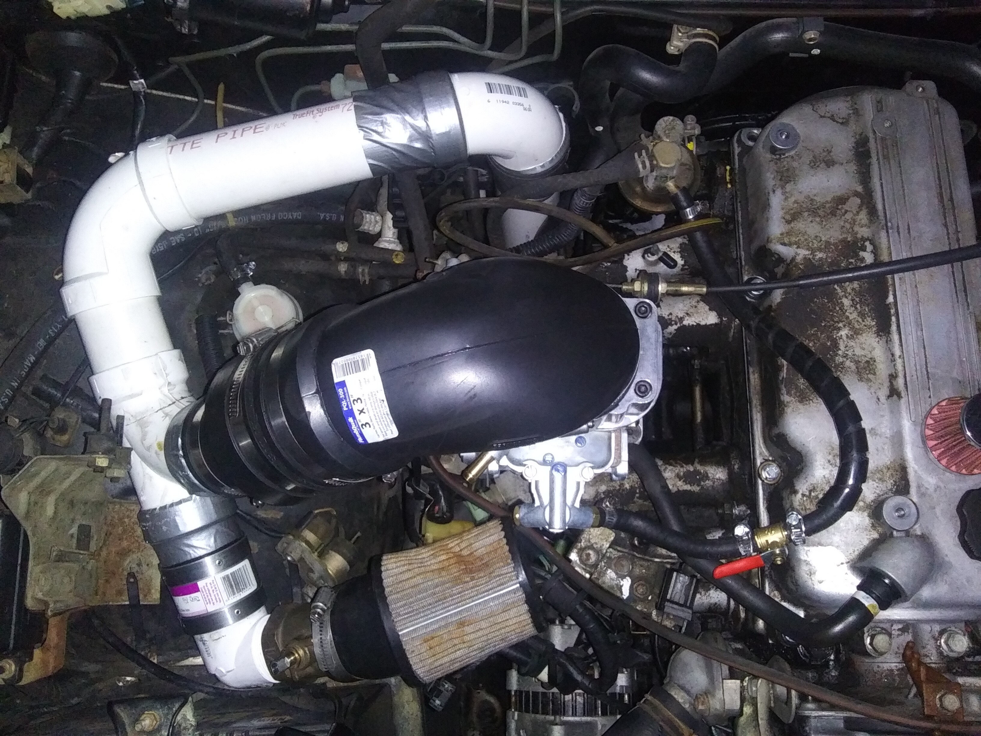

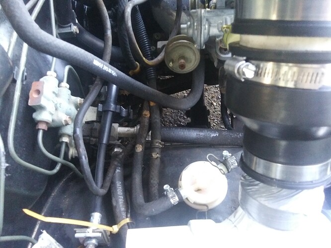

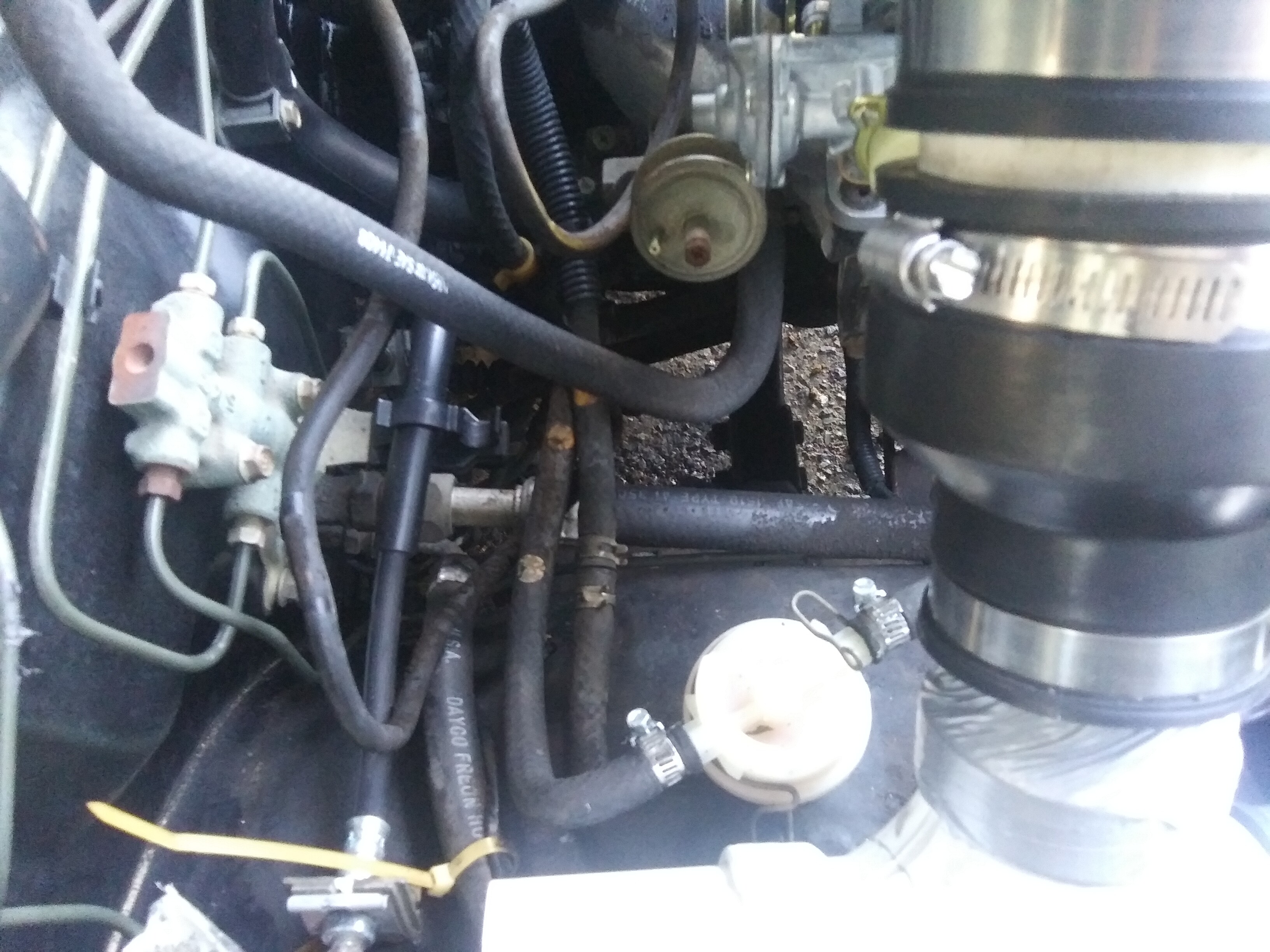

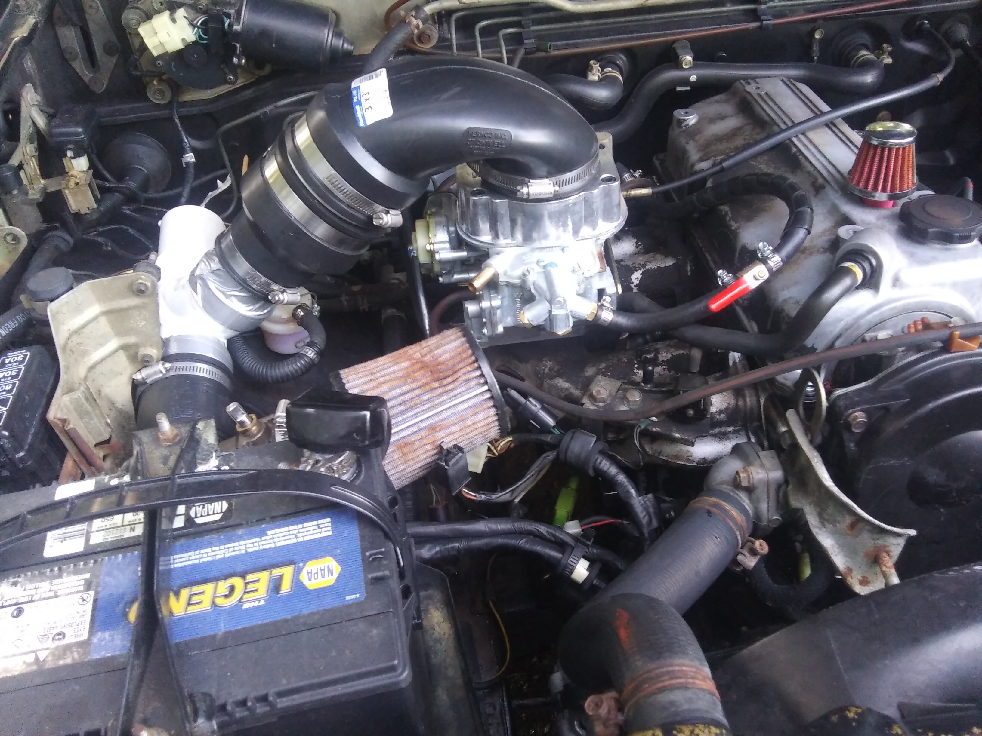

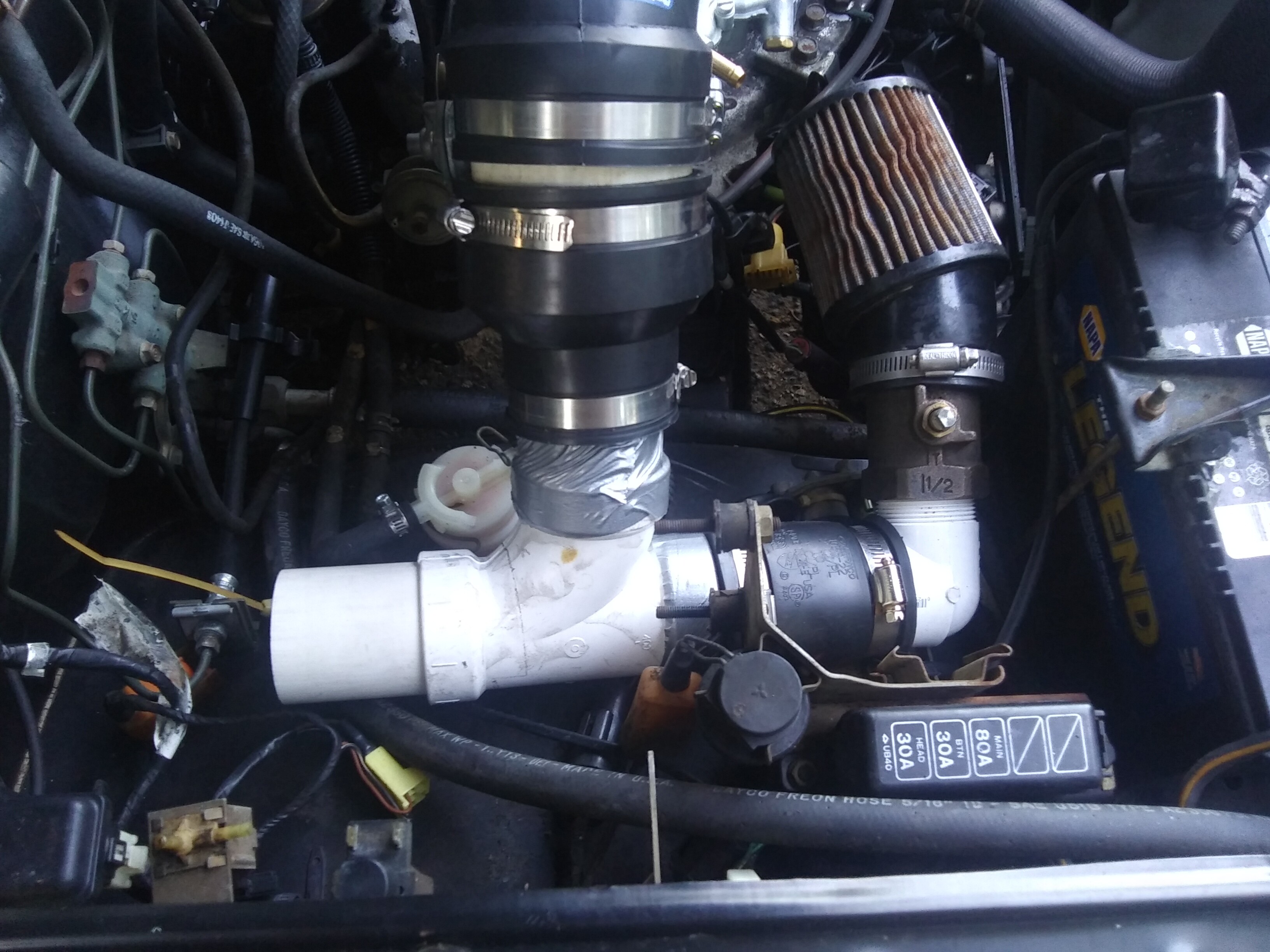

Need to buy more PVC elbows tomorrow, route it along the passenger side up into engine bay. There’s a nice big gap I can have it come up through and this is the intake side so there isn’t any hot exhaust pipe to ruin my day. I plan to use my 2" spa valve as my gas line shutoff for when I’m in gasoline mode, and the 1.5" butterfly is my air mixture. I got it to idle okay after leaning the idle jet a fair bit.
I still need to remove the old Freon lines since it doesn’t have AC anymore so that’s even more room.
On my last test when I used vacuum cleaner hose, the hood of my truck was slightly crushing it so it didn’t have a snowballs chance of really delivering gas. I’m hoping the angle change eliminates the moisture in the gas and this hard line will allow the gas to be delivered efficiently.
I might add another 3 way Tee at the lowest point of the gas line for any moisture draining. I won’t be gluing any of the PVC, just duct taping.

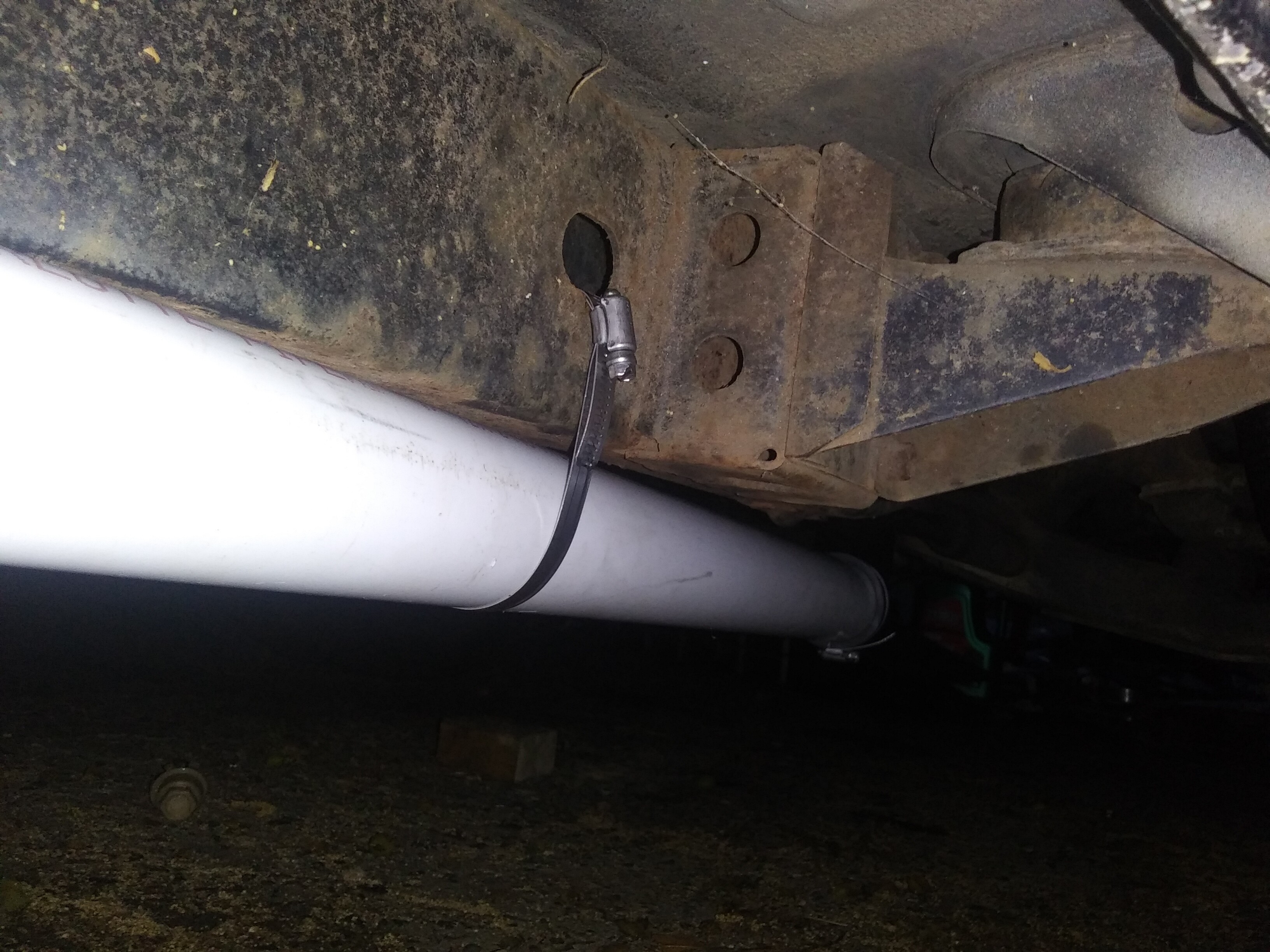

Okay! Plumbed in with hard lines ready for testing! A little late today to do it but she is all plumbed in and cinched down for a driving test.

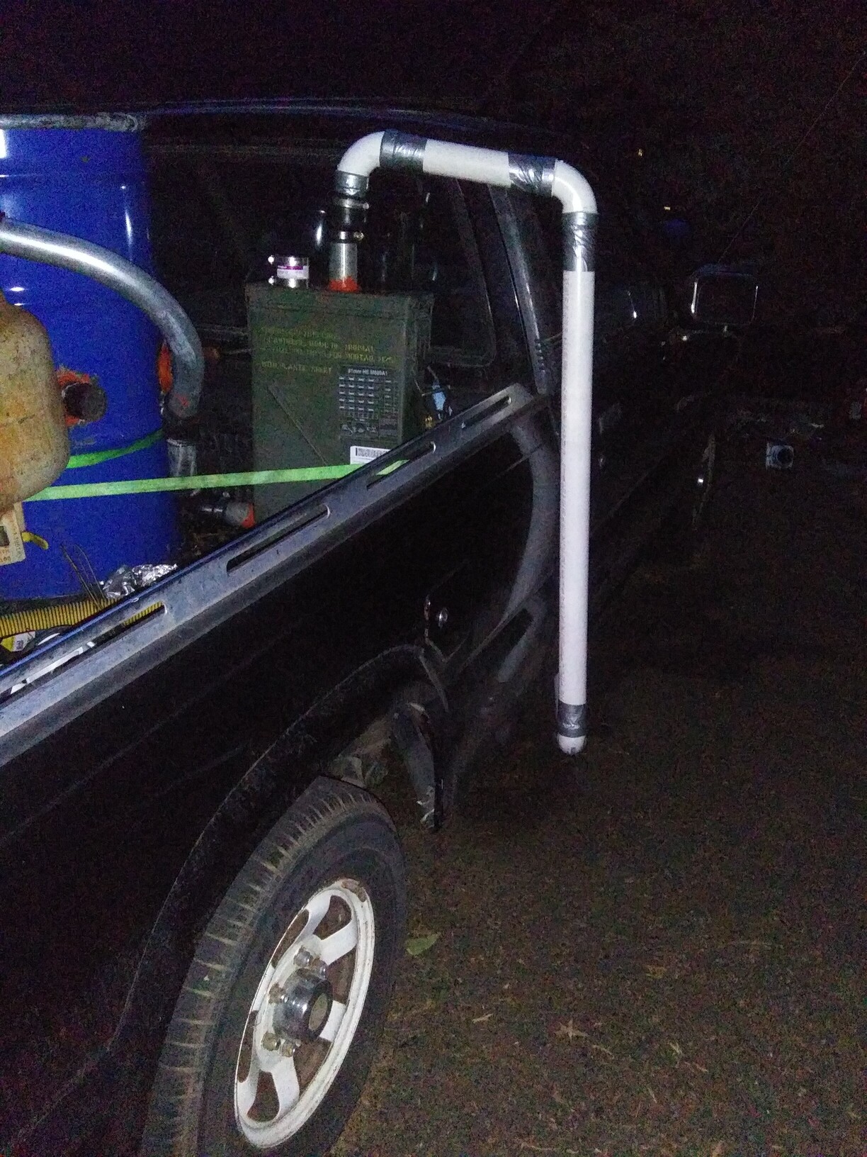

I’m definitely thinking of getting a helper spring to lift the rear end up, and for the front end I can always index the wishbone another spline to lift that. I’m paranoid of hitting something in the road and busting that PVC line.
Second driving test. Much better than last time! Unfortunately she died on a hill and had to go back to gasoline. Got way too hot and almost melted my rubber elbows.
She has a seriously hot gas that takes forever to warm up and really doesn’t want to stay on.
Top speed was about 45 miles an hour semi downhill in 4th gear.
