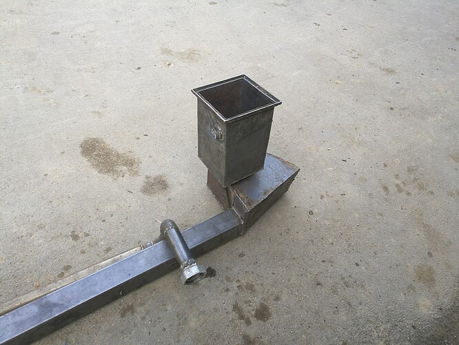

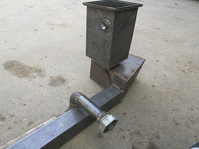

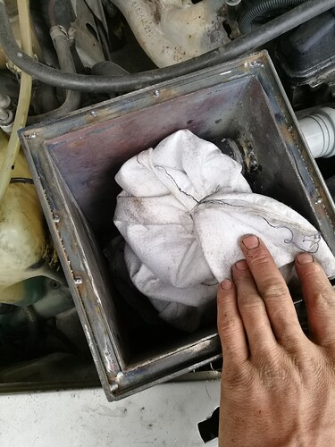

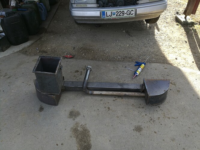

Some pictures of the cooler and filter. Both somehow unconventional. The cooler will most likely get some fins welded on in the summer but l run the engine at high idle 2000rpm with occasional reving on chargas and it all stays cool to the touch. Sure feelsgood to hear woodgas burn in a engine again :smile:
