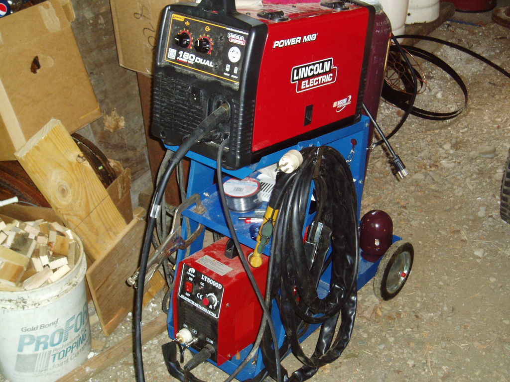

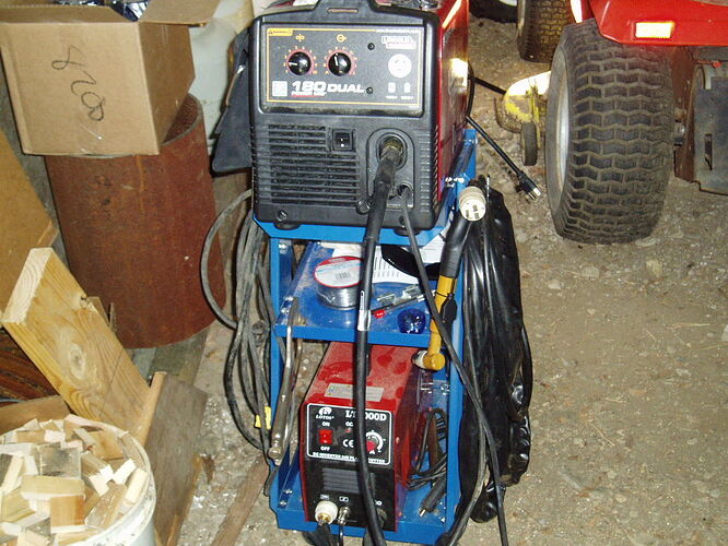

Finally got my welder, it is a Lincoln 180 Dual so it will run on either 110 or 220 just change the cord to the one you want. It is not the cheapest one but, I do like that I can run it off a generator or power inverter in my truck. Lincoln has a rebate going on now for some modles, I am fighting with them about my rebate because they say I had to buy it from a retail store not online. The rebate flyer does not say you can not buy one online, it says you have to buy it from a Lincoln dealer which I did. Overall though it is a great welder, very satasified with it. My Lotos 5000d plasma cutter on the bottom of the welder cart great machine for the money.

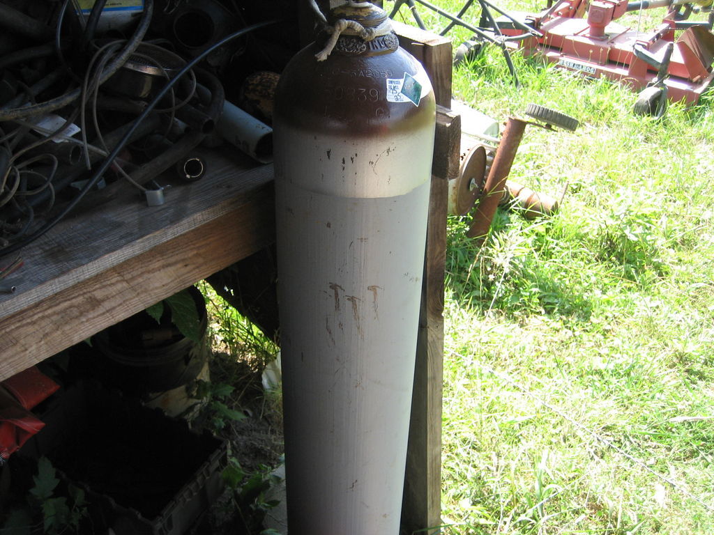

What is a good size for the argon bottle? I am thinking about buying one from tractor supply and wanted to get the right size. I will be building a WK gasifier but other than that, just small stuff.
Wayne has a small one that he keeps on the welding cart and a large one that he takes to the supplier to get refilled. He can fill the little one at home using the big one. That way he gets the best of both worlds, fewer trips to the store and a nice portable bottle. If you live close to your supplier then just get the little one, but be prepared to refill it often.
I have the little fire hydrant sized one and get about 2 hrs welding between refills. Costs me 30 dollars to refill. Wish I had got a bigger one to begin with.

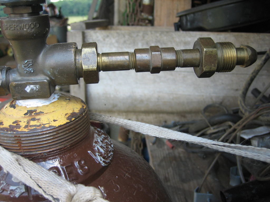

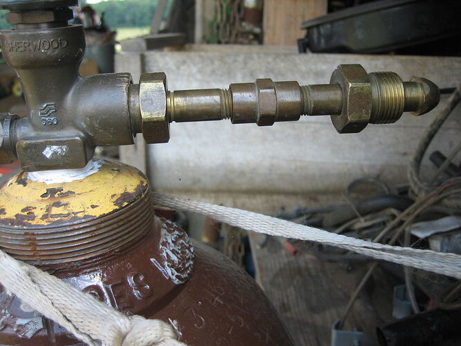

What kind of connecting setup do you need to fill the small one from the large one?
Hello Kyle,
Below are my big bottle, little bottle and the connection.
I usually refill the little one 10-15 times before I refill the big one.
