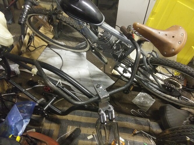

Here’s one of the generic 2 stroke kits on a mountain bike. It has roughly 2 horsepower 66cc. One speed but has a manual clutch so you start it by getting a running start and dropping the clutch.
Also pictured is an electric stretch cruiser I’ve been slowly working on.

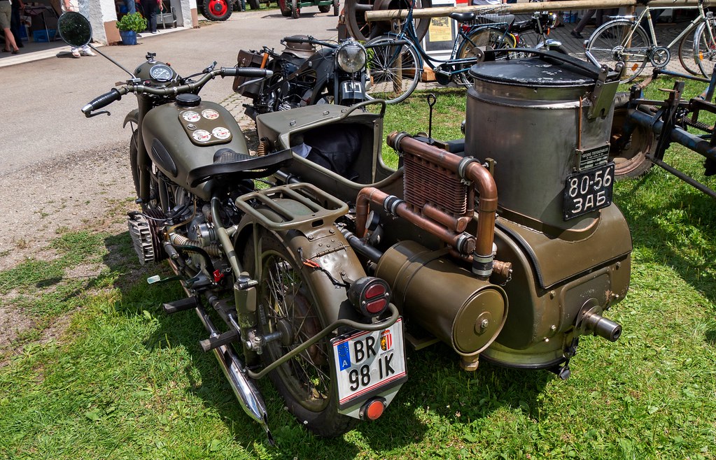

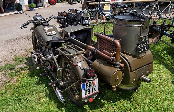

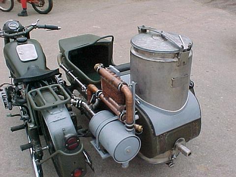

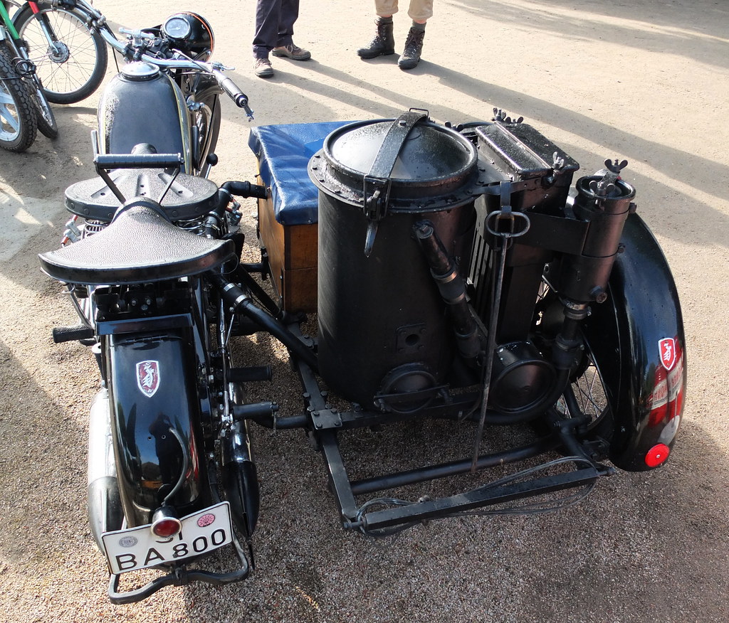

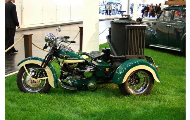

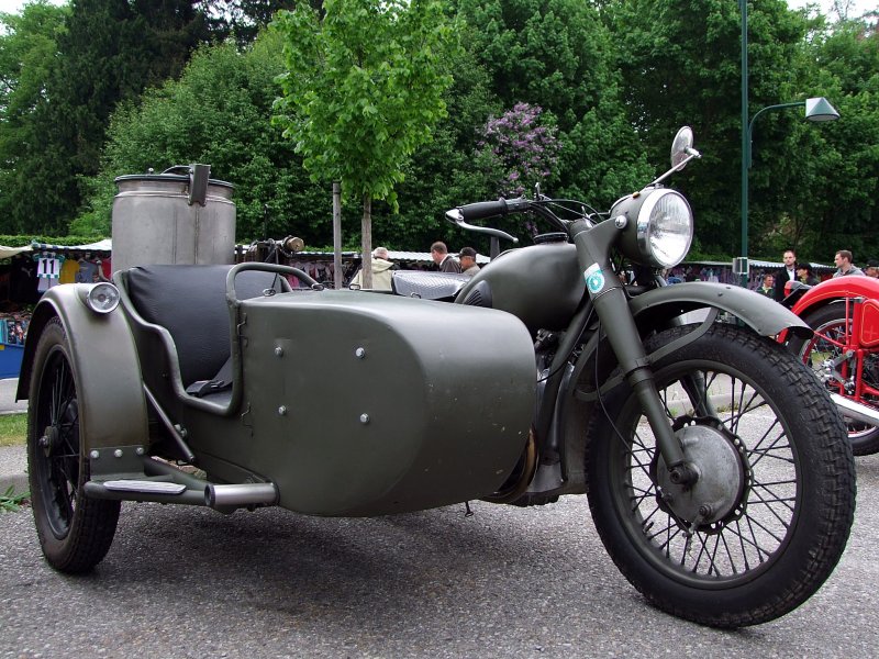

for thoose who cannot sleep more some exiting fotos…
with time we get a nice collection…
ciao giorgio

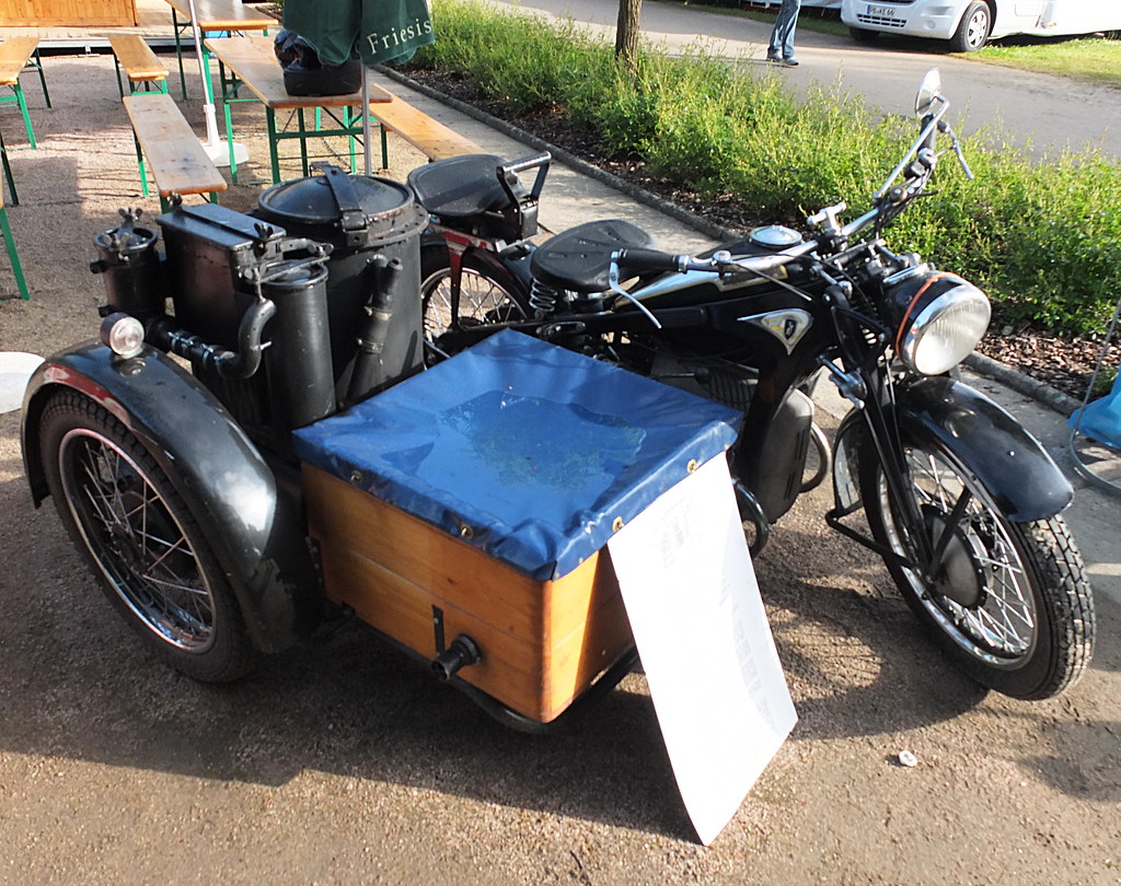

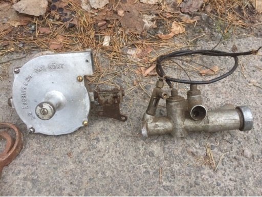

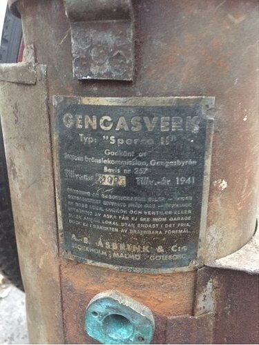

from sperco, ventilator, oil dropper?

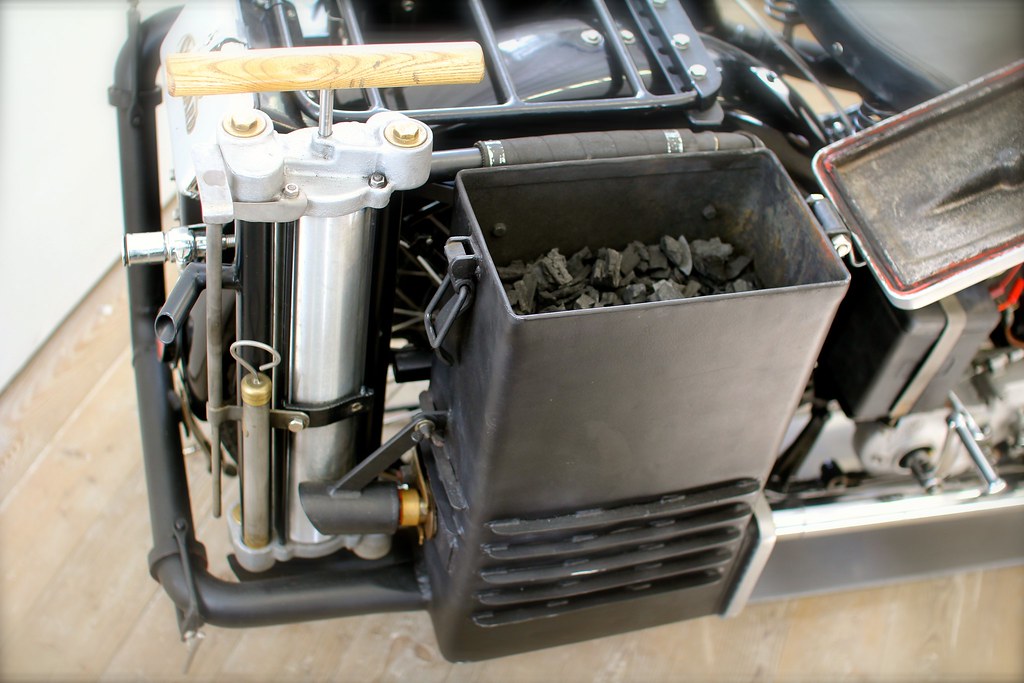

and gasifier…who has an idea for what is the brass hole? on the better fotos it has a brass lid. for a lighting port it seems a bit too high..?

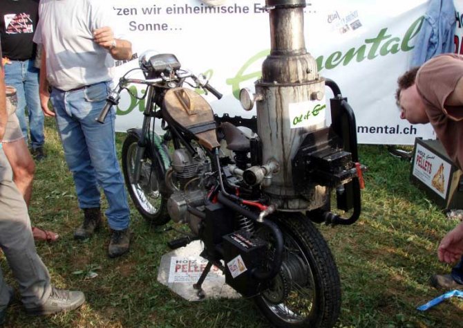

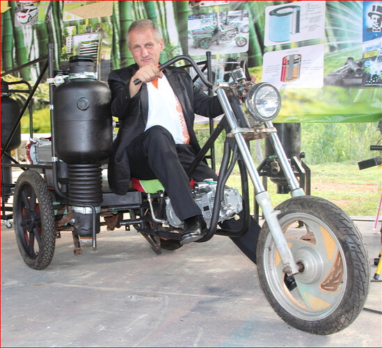

Doesn’t the tubing wrapped around the reactor on the trike three pictures up look a lot like the Off-Grid Pro reactor? I’m starting to think we are all just re-inventors.
https://youtu.be/G3fLxPmxIOI
The Teacher in Ecclesiastes said “What has been will be again, what has been done will be done again; there is nothing new under the sun.”
I really like the Trikes :smiley:
Al; I bet if they posted a 50 Ford pickup with a gasifier, you might like that too :grin:. TomC
Hey I recognized that guy in the last picture in a black tuxedo suit on the trike build.
Hi GiorgioP,
I think the brass port on the pictured Sporco II unit is a cast brass/bronze tuyere on a charcoal unit. Hollow. Liquid cooled.
Yeah, nice to see the picture of Koen Van Looken.
Hi, the brass or bronze part is a part of the air intake, there is a bend pipe on the inside with nozzle in bottom. There is some missing parts, on the brass part should be mounted a “air flap” (non return valve) and a “flame catcher” this was demanded by laws here to be approved to sell gasifiers.
In the missing piece there should also be a water dripper device.
Im looking around my books and papers here, should have a simple schematic of the Sperco 2.
but cant find it for now, im really curios myself to check it up better.
Something i found was, Asbrinks & co made around 1000 Sperco2, of wich they sold 500, the unselled was later scrapped, this is due to fuel and oil rationing, it came new restrictions that made it impossible to buy oil for engines with loss lubrication, as in two-strokes.
