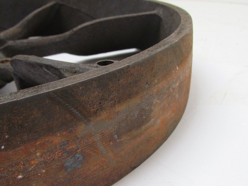

Troy, where are you? Bad soil and jungle sounds like the Yucatan, maybe Quintana Roo or Chaipas. If you are anywhere near Veracruz, you can look aroung the places where they scrap out ships and boats. It would be perfect if you coud find a sheave from an old flat belt drive like this;
You would overlay this on the original steel wheel and mount the blades to the face. Then, you have to build a striker bar and an enclosure. Some chippers use a wheel with cutters on the side. You could build a turntable like a merry-go-round right off the ground and have the cutters on the edge facing upwards. The truck tire would sit right on top of the turntable to friction drive it. They made some brush hogs like this.
