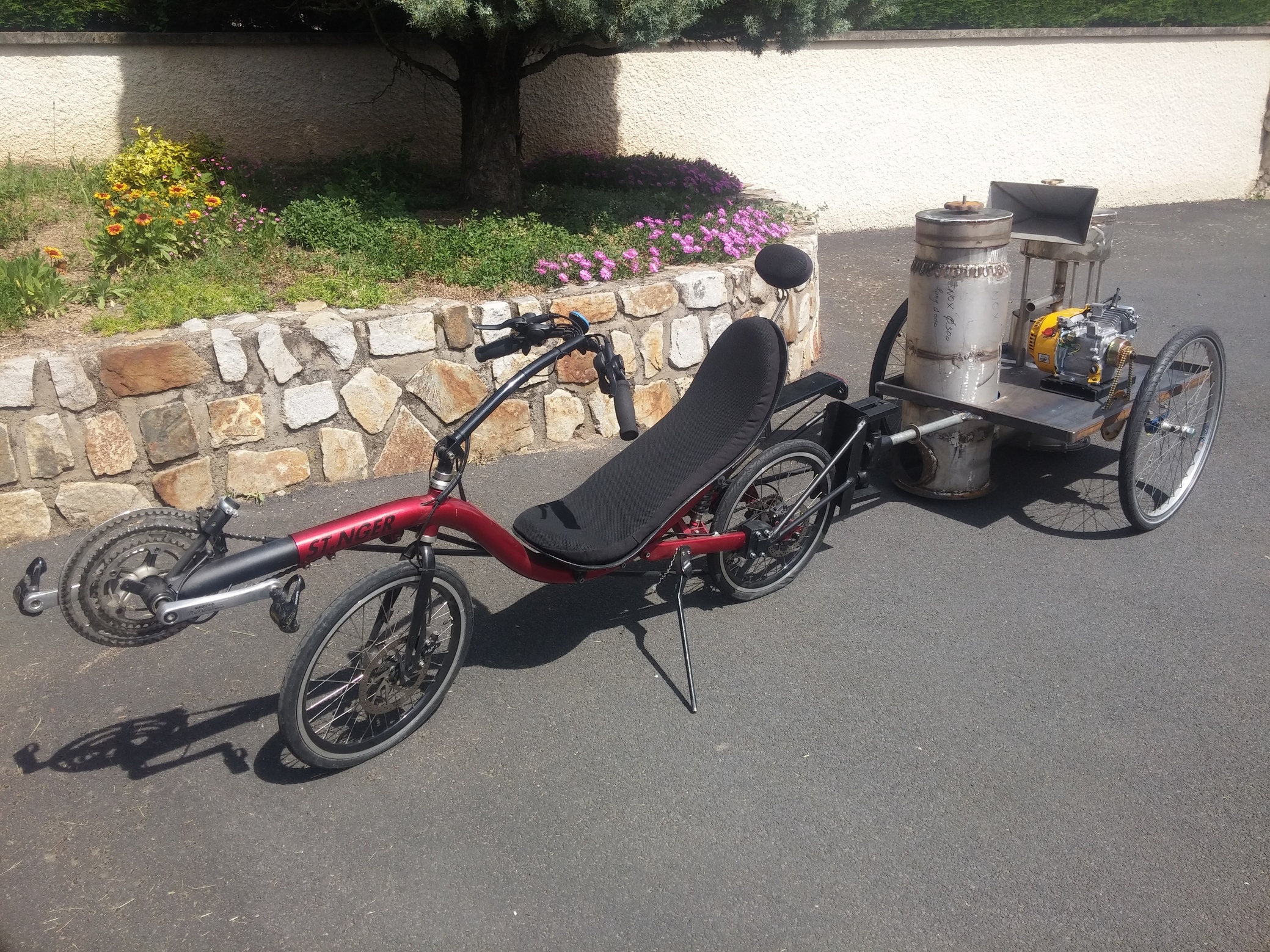

on my channel Youtube, pocketpata, it’s not my car but that of a friend Bernard Perrouse, a 3.7 liter chrysler that works like a thunder, wonderfully, I’m building a trailer to propel my recumbent bike carbonite, compressed charcoal with tar of wood, attached a photo,
Do not be shy to ask me questions, and on the forum, everyone benefits.
Best regards.
François Pal
very interesting bike you have there…Do you have any kind of break in the structure at the trailer hitch?
